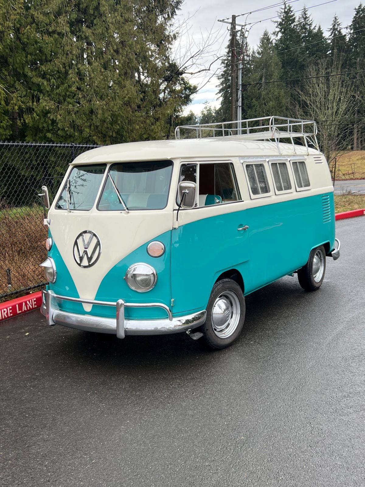

I bought a '65 camper last month. I had hoped it was going to be turnkey but have run into a few problems. I discovered the muffler has a hole in it, thanks to fuel leaking out of it. Here is a picture of the engine bay.
Seller told me it is an 1835. He got it that way. Are there any identifying numbers or manufacturer brand I can look for?
Here is the hole in the muffler, and another picture taken from the tire well. If you zoom in you can see the exhaust system is wet with fuel.
This is a picture of the fuel pump, filter, and something with numbers and what looks like a dial. I have no idea what it is or does.
This is the one of the carburetors. Can someone tell me what kind it is, or where identifying marks would be?
Another problem I have is it not starting, which is probably a good thing! Here is a picture of the starter.
I had VWs a lifetime ago, they were all stockers. This is my first with dual carbs, and I was told it has a freeway flyer trans. Is there a good manual for these engines? I'll tackle this on my own if I can as I am at least 100 miles from any shop that works on air-cooled, maybe more. The rubber around the engine tin is gone, I've ordered a new one, so was planning to pull the engine anyway.
Thanks in advance for any advice or insight.
