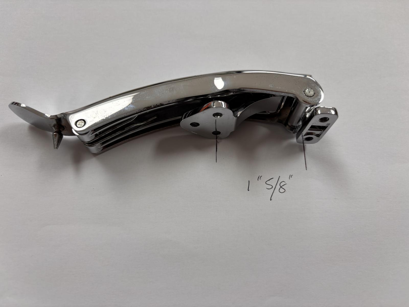

I'm trying find out why there is a difference between long spoon and medium spoon pop out catches. I keep getting told that they are the same fit and will fit all years but the photos here show something different. The long spoon is a repro and came off my 1960 Kombi (closes the window perfectly), and the medium spoon is an original but will not fit, (the spacing means the spoon won't fully close).

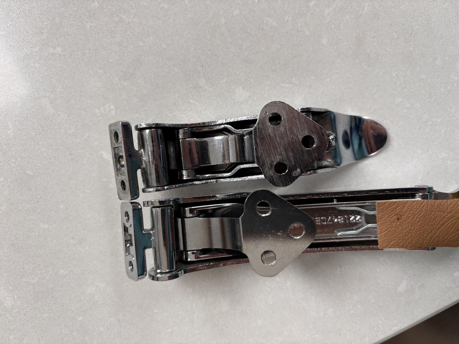

I was told that a 58 had adjustable plates (like the rears on the 60) all around. I haven’t seen this but it was from the person I bought the medium spoons from.
I would really like to know the differences in catches and the years they were introduced and fitted. I don’t seem to know anyone who can answer this and the repro catches all say up to 67 and are all universal. Now I know different, unless the repros are based on the smaller footprint (which would fit all my windows).

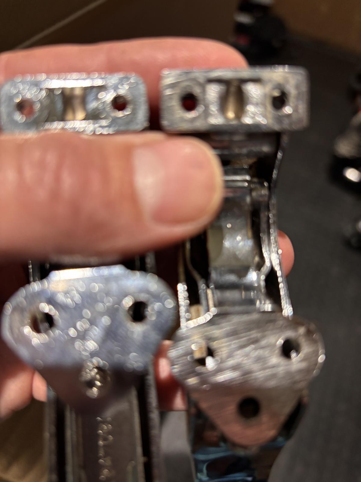

That is what I thought, but my 60 has all original pop outs and the original plates welded to the bus.
Why would they have slotted rear if it wasn’t to allow for this? Apart from one long spoon, all of my pop outs catches are original.
So, if what you are saying is correct, how are long spoon and medium spoon fittings 2/8” different? It isn’t an issue with the bus, it is the difference in the catches dimensions that causes the problem, thus the medium and long spoons fittings on rear due to the slots. Some has said that their 58 had slots all round but I haven’t seen these in the flesh or in picture.

Here is a picture of the medium spoon latch on the front cargo door as it came from factory. Hope this helps. Thumbs Up
