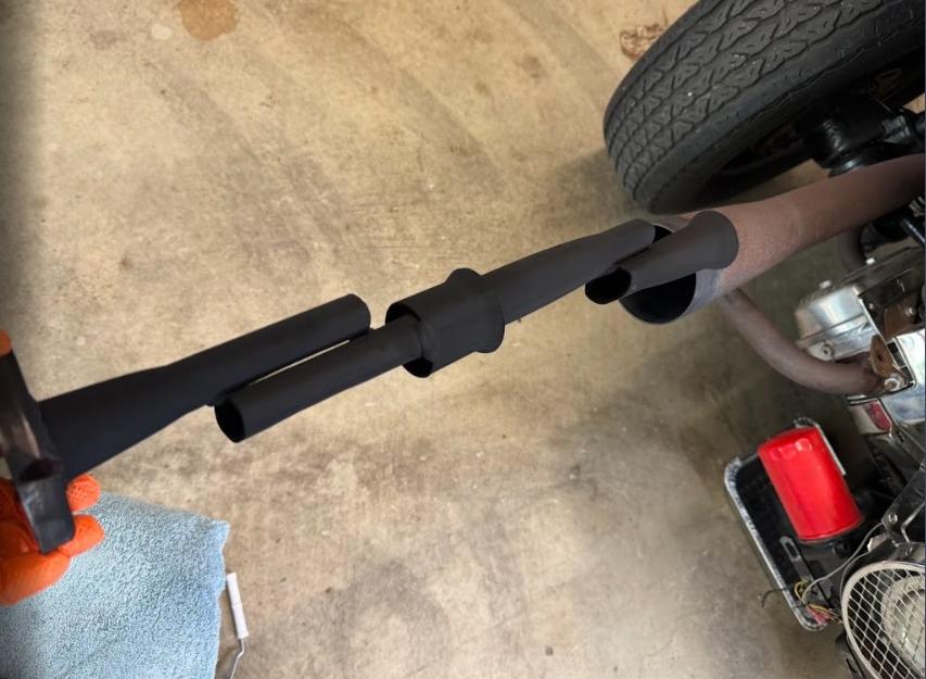

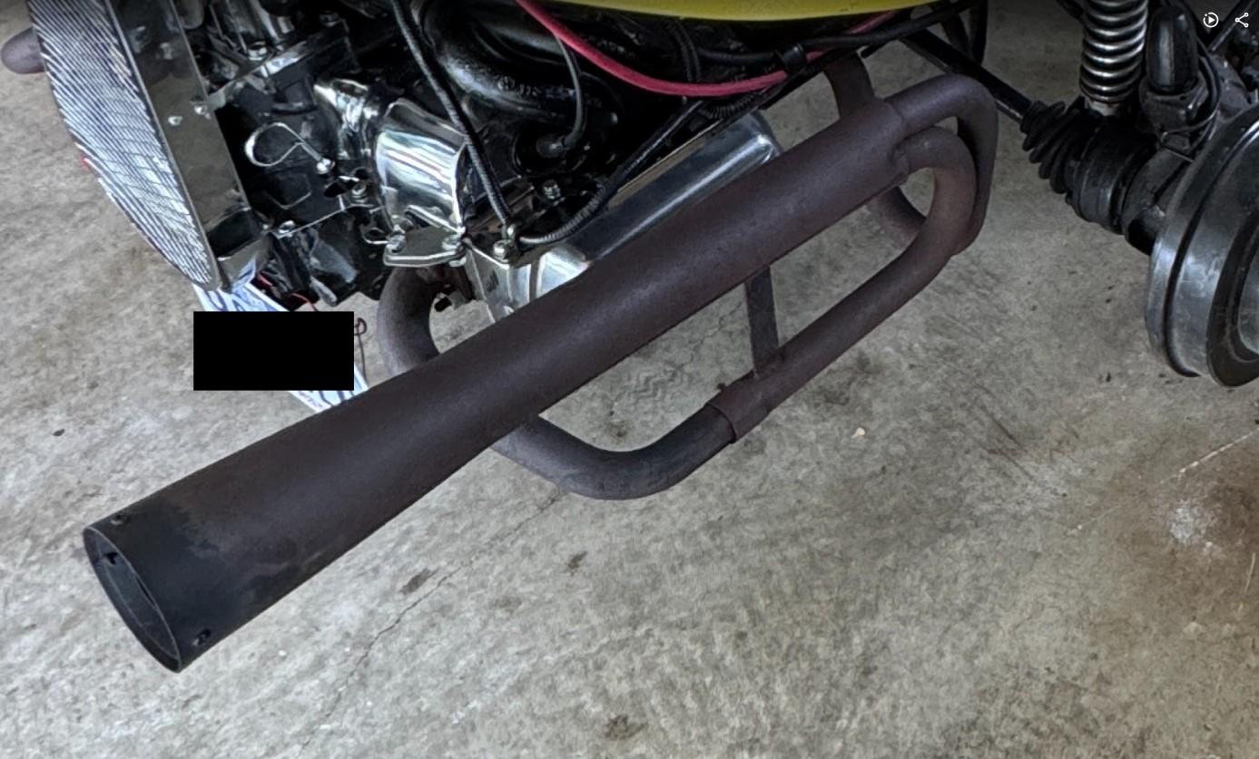

Greetings,
I've had a couple responses to my other topics in which it was recommended to replace the existing exhaust on my recently acquired 1969 Dune Buggy.
Engine:
H 5692428
88 Kit - Stroke 76mm
Carburetor - 34PIC T-3
Dual Port
I've been searching the internet and there are so many exhaust variations and no real way to tell what they sound like. I'm hoping I can get some suggestions based on first hand experience.
Preferences:
- A little quieter exhaust if possible
- Chrome/Ceramic Coated would be awesome
Pics of my existing exhaust which has a baffle insert and blanks on the heat risers.
(there is no blank on the heat riser in this pic. They were installed after the pic was taken)
Many thanks !

You have what is the worst system you can have.
A 1-1/2" system would be best but since it's in a dune buggy this topic might be better off in the Dune Buggy forum.
PM me if you want it moved... please don't just start another.

Tri-mil or AA offers some decent buggy/baja type exhausts. You arent going to find something by searching based on sound. Too many variables. Making a custom muffler is easy, cheap if what you buy, you dont like
Like glenn said, your present setup is poor at best.

As I mentioned, multiple people have commented on the quality of my current exhaust, but nobody has mentioned why it is so bad. Could somebody tell me why it is so bad? That would help to ensure that I don't buy a replacement exhaust that is just as bad.
Should i be looking for a separate exhaust for left and right, or is the type where all four join into one pipe and then goes through a muffler a better choice?
So far I have gathered that I should use an 1 1/2 system.
I appreciate your patience, comments and suggestions !

Very little back pressure and separate left and right cylinders.
Even on V8 engine with true dual exhaust, they found an "X" pipe or crossover pipe helps with performance.
This style exhaust is a lot better. it has a true header and provides ground clearance for offroad use.
https://vwispwest.com/empi-classic-dune-buggy-exhaust-brushed-stainless-steel-mb3371-0/
