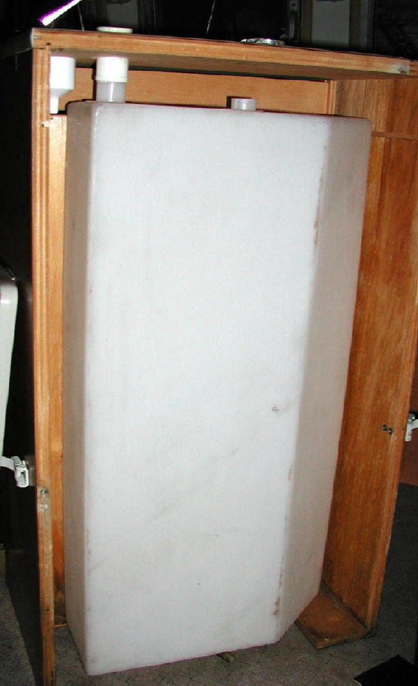

Hello
I'd like to order a water tank for my '67 SO42, mine is broken.
I went to the last link provided in this post.
https://www.rvtanksdirect.com
here the catalog :
https://www.rvtanksdirect.com/_files/ugd/d50245_825b30c1469f460cbba7c619c76a8d83.pdf
The tank reference for our bus is #10 ?
The water inlets and outlets are standard or it's necessary to specify for which vehicle model when ordering?
Thanks

BulliBill wrote:
That link just above to the water pump doesn't seem to work, can anyone find it? I haven't tried to operate my original yet, but someone in England was selling a rebuild gasket kit for that pump a year or two ago. I got one just in case I need to work on my original pump. But if the pump is available new, hell, I'd buy one!
Bill
I found the Zebra pump originally on an RV site. I called them and they said that in 2017, Zebra stopped making the pump pictured above in this thread, and that the new one they have has the black ball on the end of the handle. This is the same one they sell on Bus Depot for like $40. https://www.busdepot.com/zvw223101
The one I purchased was off of Ebay. I would recommend to search Ebay if you would like to purchase the Zebra pump that looks identical to the original non Whale.

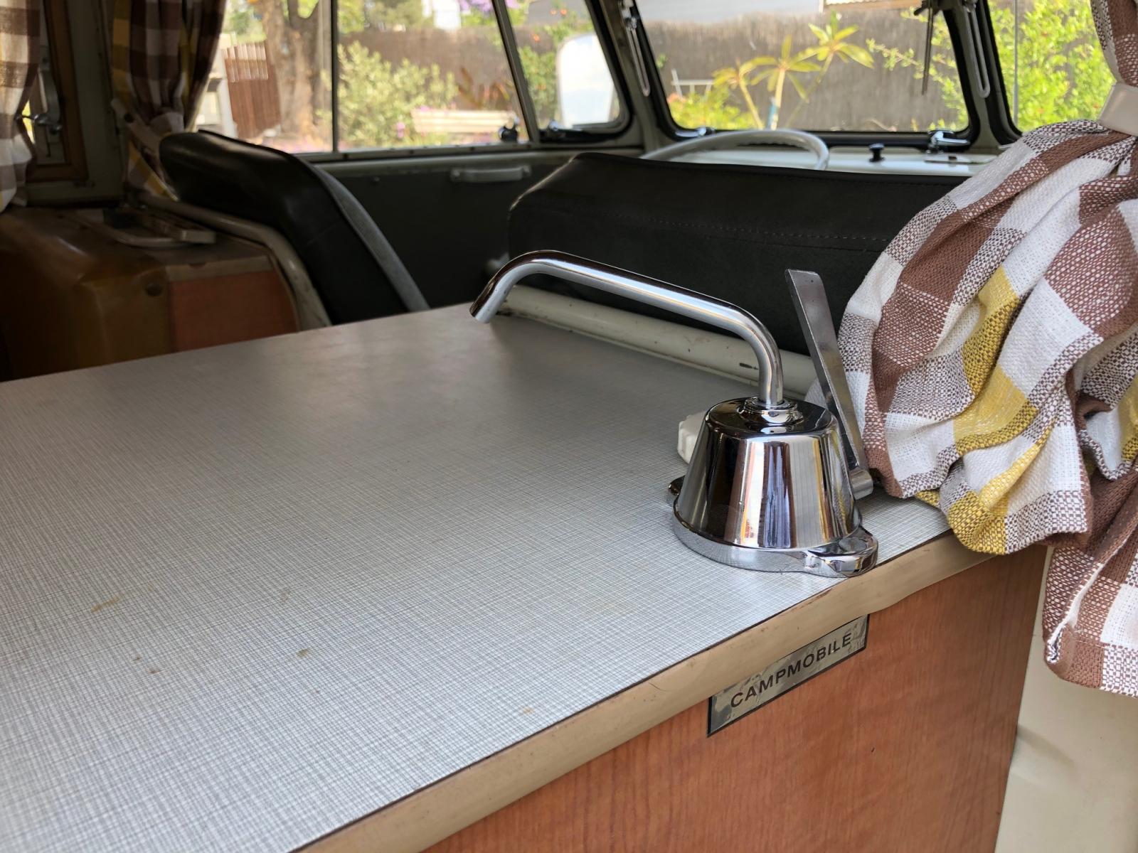

von_hansel wrote:
DadaCheese wrote:
srfndoc wrote:
The pump with two screws (like the original) is out of production now.
...actually, perhaps it is again!
I dug up my receipt from 2015, and looked it up, and unlike mine (pictured below with yellow background), if you go to the product now, today (March 24th, 2017),
it looks like the CURRENT JC804 looks almost identical to the original SO-42 with only two screws!
LINK:
http://www.rvplus.com/r.v.-accessories-pump-rocker-chrome-jc804.html
Someone buy one and let us know.
I'm digging up an old thread, but since DadaCheese requested someone to purchase the two screw Zebra water pump and let the Samba community know, I figured I would post my response- It fits and matches my original perfectly.
The one on the right is my original
This is the Zebra water pump installed. The screw holes lined up perfectly.
Unfortunately, Zebra quit making this style with the flat handle and now only carry the one with the black ball on the end of the handle. I hope this helps.
Bill

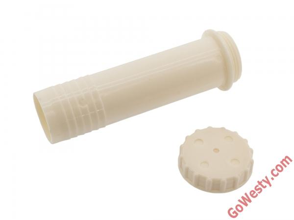

Looks like Go Westy sells the filler tube as well.
https://www.gowesty.com/product/faucets-plumbing/24809/water-tank-filler-tube

DadaCheese wrote:
LINK:

I made up a replacement for the original drain piece for the water tank. It consists of 3 parts (all from HD) and ends up being about the same size/function as the original and works great with the Inca Plastics tank:
Original on right for comparison
Parts Used:
