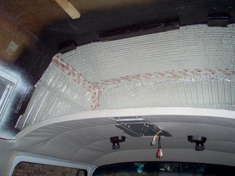

I used FatMat and some thermal insulation i found on Ebay...... it's high density foam bonded inside a silver polymer for heat reflection.... it definately works well in mine.....with the a/c on it can stay 72 degrees inside when it's 90+ outside..... Cool
The top was later finished with thermal barrier insulation and a nice 1/2" foam backed headliner material....
