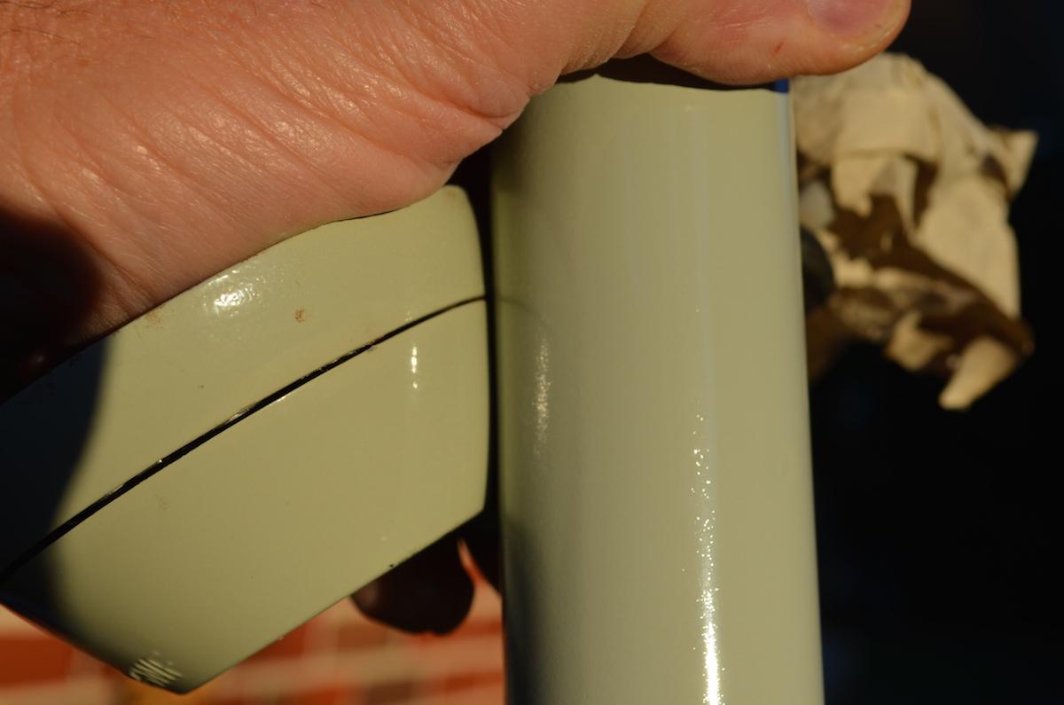

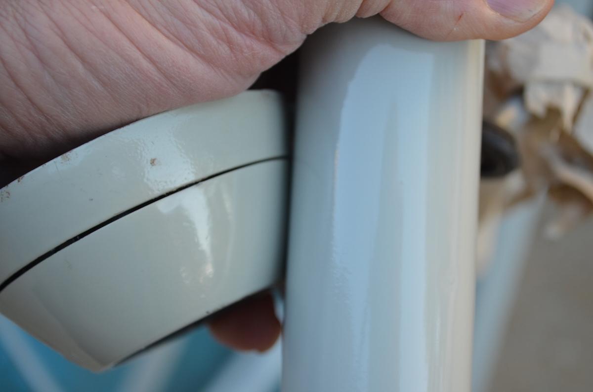

Looks good to me!

Here are some examples of the Silver Beige Paint I had mixed recently. It was matched using a NOS turn signal unit. I feel it was a very good match and looks great.
