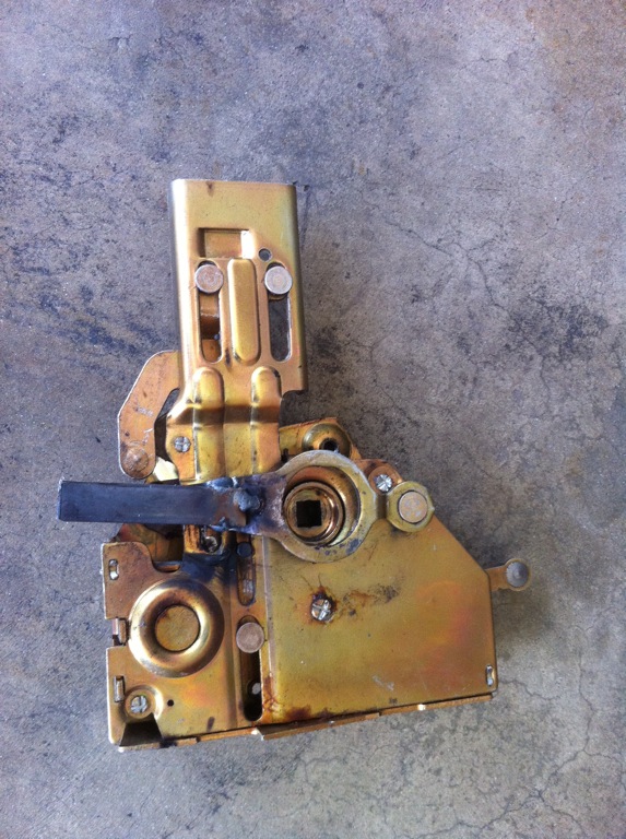

I would use the factory used contacts for the slider. I bought the A-1 contact for the slider and noticed those will not work as well as the factory ones.
Here are couple of the pictures to mount the actuators for the doors and for the slider.
You must drill this hole for the linkage and use the rivets like the factory to mount the actuator.
For the slider, best to weld a little piece and drill a hole for the linkage.
picture of the slider, make the linkage paralllel as possible so you dont have problems down the line. I used two bars $5 and riveted them in and used it for acutator.
