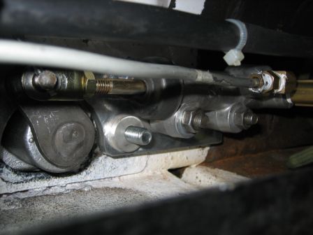

The hydraulic clutch slave cylinder pulls the lever, just the same as the cable does.
The slave cylinder has a piston inside which is pushed toward the front of the car by hydraulic pressure. There is a shaft which is attached to the center piston which goes back through the center of the cylinder and out through the cap on the rear of the cylinder. The shaft is sealed where it goes through the cap, but it moves in and out freely
The front end of the slave cylinder is mounted to the transmission case. The shaft that exits the center of the rear cap of the cylinder is attached to the throw out lever. When you push the pedal, the fluid enters the cylinder and pushes the piston toward the front of the car. The rod which connects the piston and the lever, pulls the lever forward.
This makes hydraulic clutch cylinders operate more smoothly with less side load. It requires removing some studs from the side cover of your trans and grinding off the pre-load tube rear anchor
http://www.cbperformance.com/ProductDetails.asp?ProductCode=6075
Also, to avoid confusion when discussing a VW its always a good idea to refer to the front of the car as forward. So when you stand behind the car and look at the engine, you are looking at the rear of the engine.

I have a sand rail with a bug tranny I think well I'm converting the clutch from cable to hydraulic I bought the cnc pedal and Slave kit but here is the question how does it work I notice with the cable system when I push down on the pedal I notice it's pulls the clutch rod the sticks out of the tranny towards the front of the sand rail. So how would a slave work does when I push in the pedal does it pull the slave in towards the rear mount of the slave I'm really confused how it works[/img]
