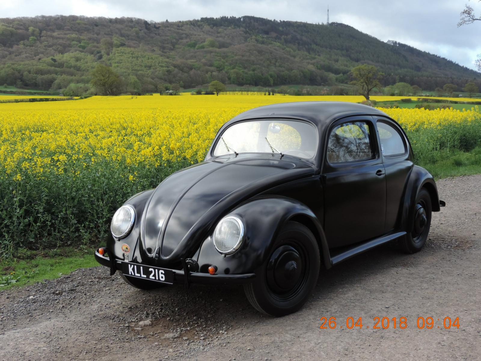

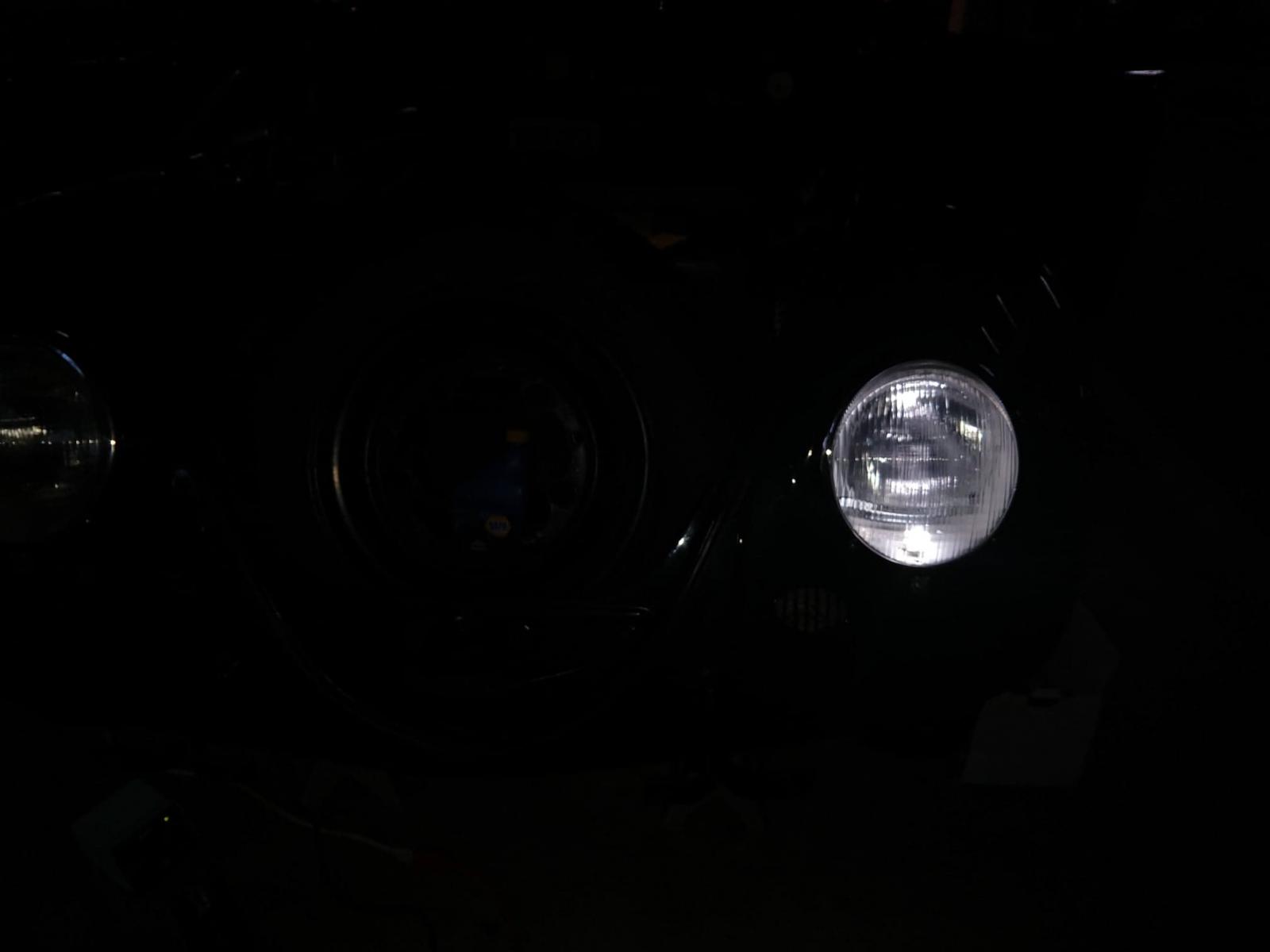

PostPosted: Sun Apr 14, 2019 2:38 pm    Post subject: Re: Can the semaphores be made to blink? Reply with quote

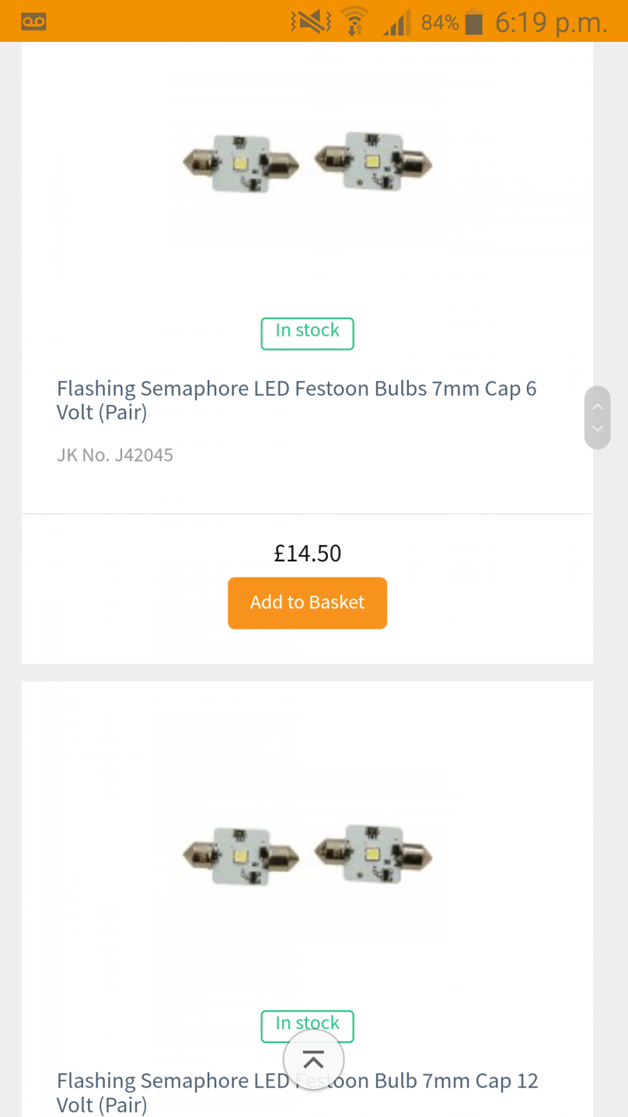

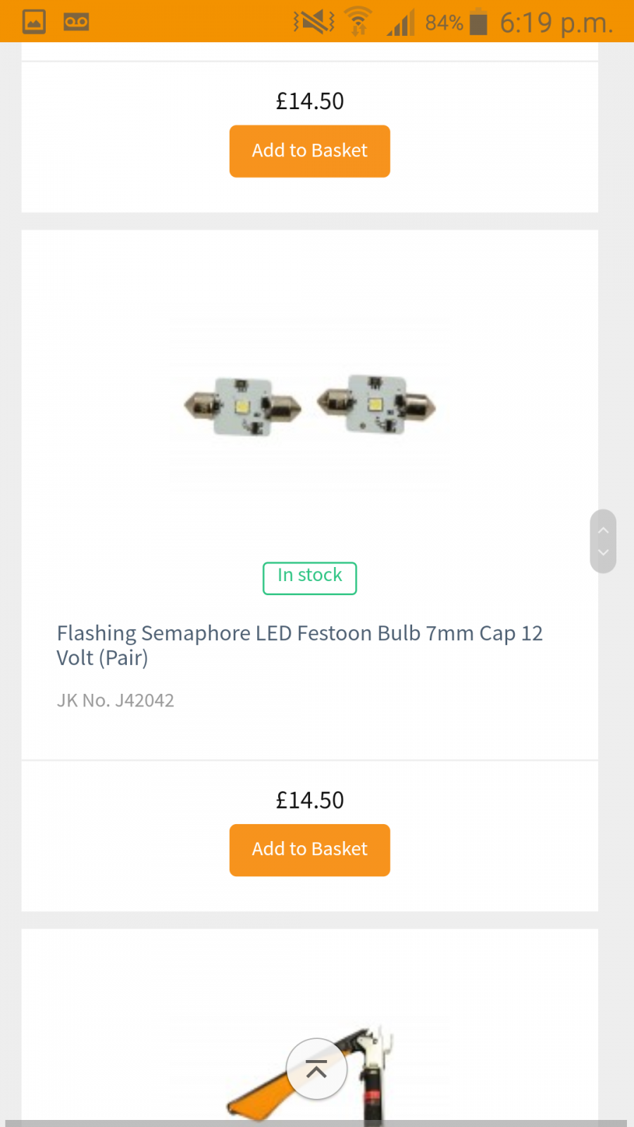

As 'bluebeetle1968' very correctly says above, driving an early car equipped only with semaphore indicators on British roads is a nightmare. He has the advantage over me in that his car is RHD, mine is LHD so even worse.
To try to alleviate the problem I have used LED bulbs all round EXCEPT the semaphores. It was my intention to fit the flashing LED festoon units shown by this supplier http://www.dynamoregulatorconversions.com/festoon-bulbs.php .
However when I came to fit them I found that although quite compatible with VW semaphores I could not get them in through the small bulb access hole on my late semaphores so I would have to dismantle them to install. Having brand new Semaphores I was reluctant to do this so retained the normal bulbs.
To augment the semaphores I have added LED flashing indicators on front and rear bumpers wired to work in unison with the semaphores (twin discretely fitted flasher relays one for Left one for Right). The lights are plug & socket connected and are easily removable to make the car look more correct if required. Unfortunately 'pastellgreen' these may not pass German TUV approval but will be OK for me to come to Bad Camberg in June.
For information all the other LED bulbs that I purchased from the above supplier are superb making all the lights on a 1946 Beetle compatible with normal driving. I have abandoned originality in the rear light having fitted dual filament bulb holders and wiring to provide for additional brake lights.
The headlights are very bright but the design of early lenses does not present a defined light pattern but accepting that antiquity the car is quite drive-able at night within the speeds available from a 25ps engine!

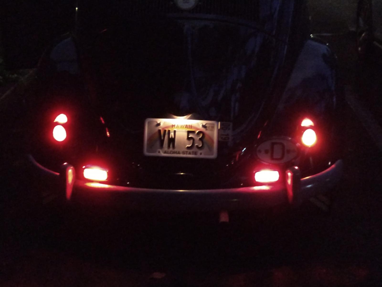

JPB1
Joined: May 31, 2017
Posts: 53
Location: Hawaii
JPB1 is offline
PostPosted: Fri Apr 05, 2019 8:42 am    Post subject: Re: Can the semaphores be made to blink? Reply with quote

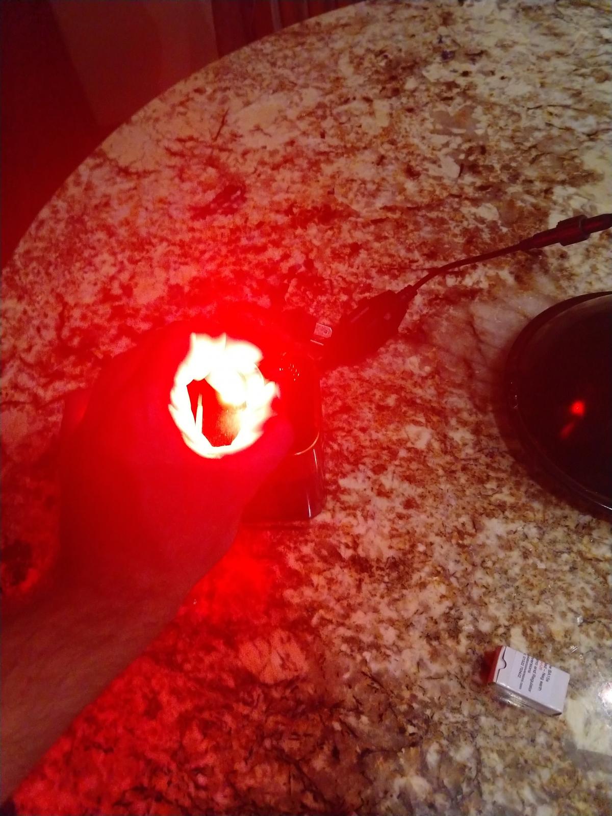

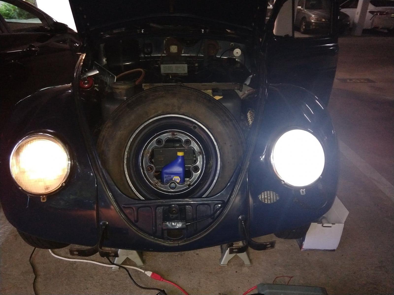

Splitdog, solved a bad harness issue (original), makes it safer to drive at night, greatly lowers battery consumption (6V).
Can have the radio and full beams on without diming; use the technology out there to enhance the rideability/safety; everything is reversible back to stock if needed.
Alot of people said the same, offered suggestions to find the problem, nothing worked - this did; old cars are just old
[one day I'll do a harness replacement, not yet - with this stop gap measure]

JPB1
Posts: 53
Location: Hawaii
JPB1 is offline
PostPosted: Thu Apr 04, 2019 10:35 am    Post subject: Re: Can the semaphores be made to blink? Reply with quote
Could not load a video of the blinking Semaphores: 31mm AMBER FLASHING FESTOON BULB Choose type: EA2D - 6v 31mm with 7mm pointed caps (see below)
These are a simple remove out old bulb insert LED!
That simple - works great
LEDs http://www.dynamoregulatorconversions.com/
Rear license plate light: WHITE FESTOON BULBS
Choose: Voltage and Size: 6v 36mm long ED2C
Heart tail lights and Hella Stop lights: 5W 12 LED BA15s RED
Choose Type: 6v BA15s Neg earth - AA2B
Front headlights, parking light: BA9s LED Bulb
Choose Voltage: 6/12v DIFFUSED - CE2B
Front Headlights: 5th generation H4 replacements (6V) – 6H4 5th Gen
DIPPED BEAM FIX KIT
Item# DBFK Choose Quantity: Buy 2 DBFK2
Reflector – semi-seal-beam
7" 6-Volt Stock Style H4 Headlight 55/60W 6V Halogen Super White Light Bulb Pair
https://www.octanelighting.com/
