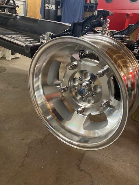

PostPosted: Sun Apr 30, 2023 5:07 am    Post subject: Re: BEST wheels for a buggy? Reply with quote

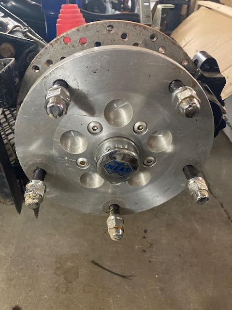

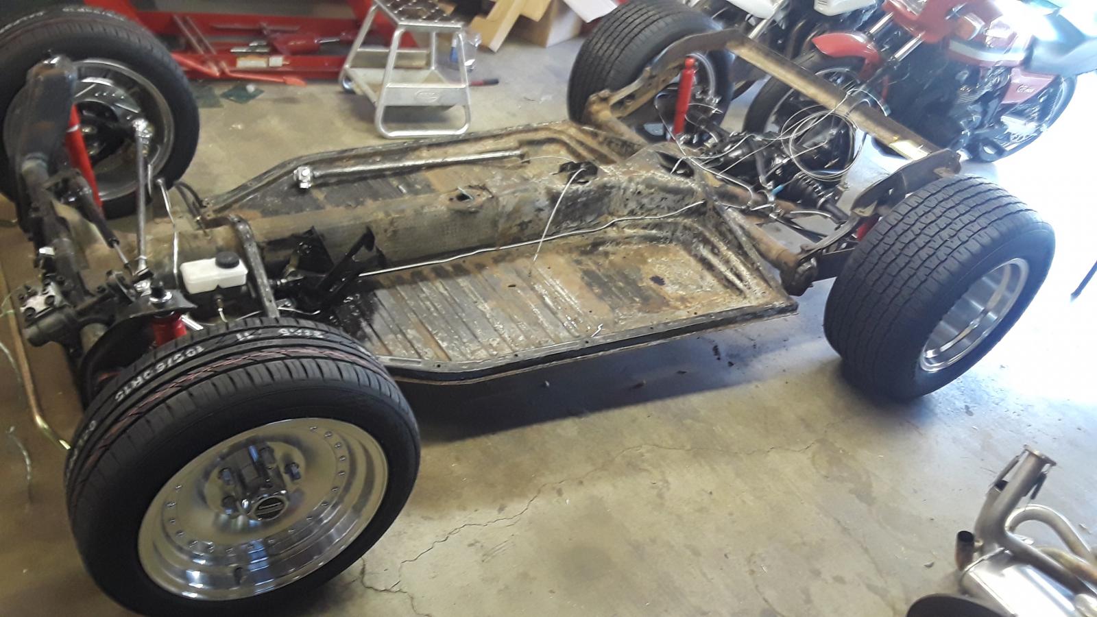

I must say that I really like the look of your GM rally wheels. They match the car nicely. However my Buggy came with VW/GM wheel adaptors and wide tires on the front. The car had a lot of bump steer, wandered bad on the highway and was heavy to steer in the parking lots.
I knew the wide rubber up front combined with the offset of the wheels and adapters was a problem. I had a set of Porsche Fuchs wheels so I got front brakes that were drilled for Porsche bolt pattern and put a set of 165 80 15 tires on them. The steering effort is way less now and it handles like a different car altogether on the highway. Long trips are far less exhausting now!
Whatever changes you make I suggest you try and eliminate as much of that offset on the front as possible. You will be glad you did.
Before.
After.
Some guys use a narrow front beam to get the tires under the fenders but that does not fix the problems that the large offset causes.

Hello All,
Struggling with finding new wheels for my buggy. Curious how you all went about sourcing wheels. I have been scouring FB marketplace. I have GM adapters(4.75" bolt pattern) and want staggered front/back 15's. I know there are sources for new, but trying to save some $$. Hope to find a VW/Chevy/GM flea market is another option. Please share your thoughts. Here is what is on my rig now. Would like to find slotted mags or the torque thrust(?).

Mine came with fake centerlines and looked fine but they were Chevy bolt pattern with adaptors.
The extra width and the adaptors made for an offset on the front that caused very poor road handling at highway speeds. I am in the process right now of getting rid of the adaptors and going with genuine Fuchs front and back. Fronts are done and it pulled the tires back under the fenders nicely and made a world of difference on the highway.
Working on the rears now.

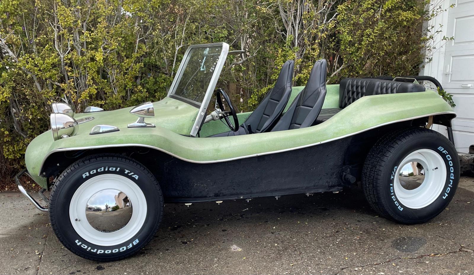

EVFUN,
Correct on the front, the rears are 255/60/15 I had some four lug smoothies widened to 8 inches in the back and all powder coated white. Stockton wheel did the widening / powder coating... and took forever. Their work is good but they are short staffed.

Davz912/911 wrote:
Just got my new wheels and tires...Now it looks "right"
I like the look! Who supplied the wheels, and what tire sizes did you choose? I'm gonna guess P155/80R15 up front because I think that is the only close size available in a BFG Radial T/A.
