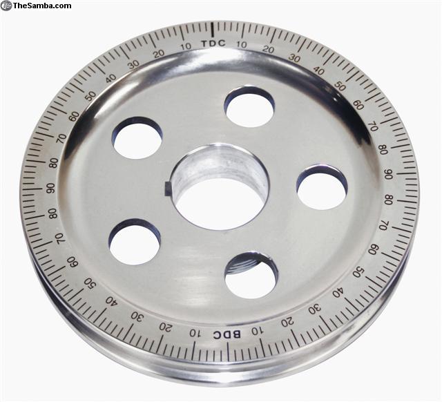

That degree wheel only shows BTDC marks and references on the TDC mark so may not work well for adding ATDC timing marks. Also it may not help if you don't have a TDC mark to center on (not all pulleys have a TDC marking).
It can be helpful to note where 270BTDC (or 90deg ATDC) is as this is where the crank pulley woodruff keyway is located on all ACVW engines. This slot is at 9-o'clock on the ID of the crank pulley when TDC is straight up, as seen on the degree pulley below.
Using this keyway as your reference you can ID where TDC is located in case your pulley does not already have a TDC mark.
I made this paper template a few years back.
It has lines that extend to the center of the wheel. This way you can cutout the center and line up the 270deg line with the center of the woodruff keyway at the 9-o'clock position.
Print it out full size and it should be a 7-in diameter wheel.

Bringing back this one from the dead because I came here looking for a printable degree wheel. Link is dead or gone, can we get this added to the first post some how?
https://www.hot-spark.com/Hot-Spark-009-VW-Type-I-Pulley-Degree-Template.pdf
