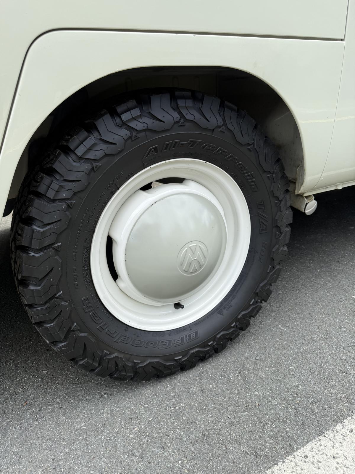

So I decided to take the Pepsi challenge.
These are both in flat lip 15 inch rim bus’ with stock suspension
1.) Wildpeak A/T 215/75 R15:
The tread is a little less aggressive, but surprisingly they make a little more noise. Not super loud, but a bit. The great part is they’re “D rated” up to 2095lbs, so for a camper they’re working really well. They fit nicely but do rub if I make an aggressive full turn at full lock, but that’s only happened twice in 2 years and it’s been minimal.
2.) BF Goodrich AT 215/75 R15:
I really like the look of the tread on these. They’re “C rated” up to 1765. Not loud at all, but that could be a function they’re on the pick-up truck. I think I’ve had them rub once at full turn and full lock, but that’s only happened once in 2 years and it’s been minimal.
Overall im happy with them both.

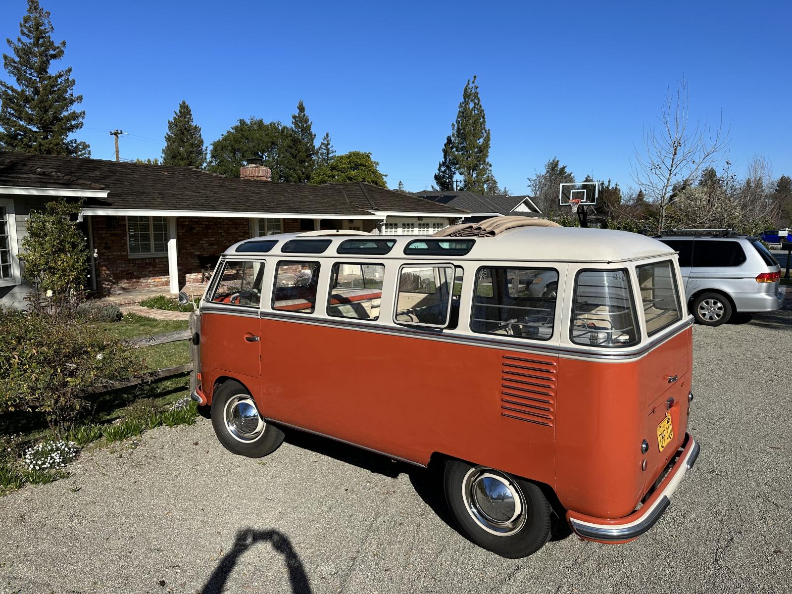

Here is my '56 with the Coker Firestone 6.70 bias plys. I wouldn't exactly call them "meats" but they are a bit larger than normal.
I love the tall look, and also the sturdiness of these tires. They drive really well. No flexing.
-Wade

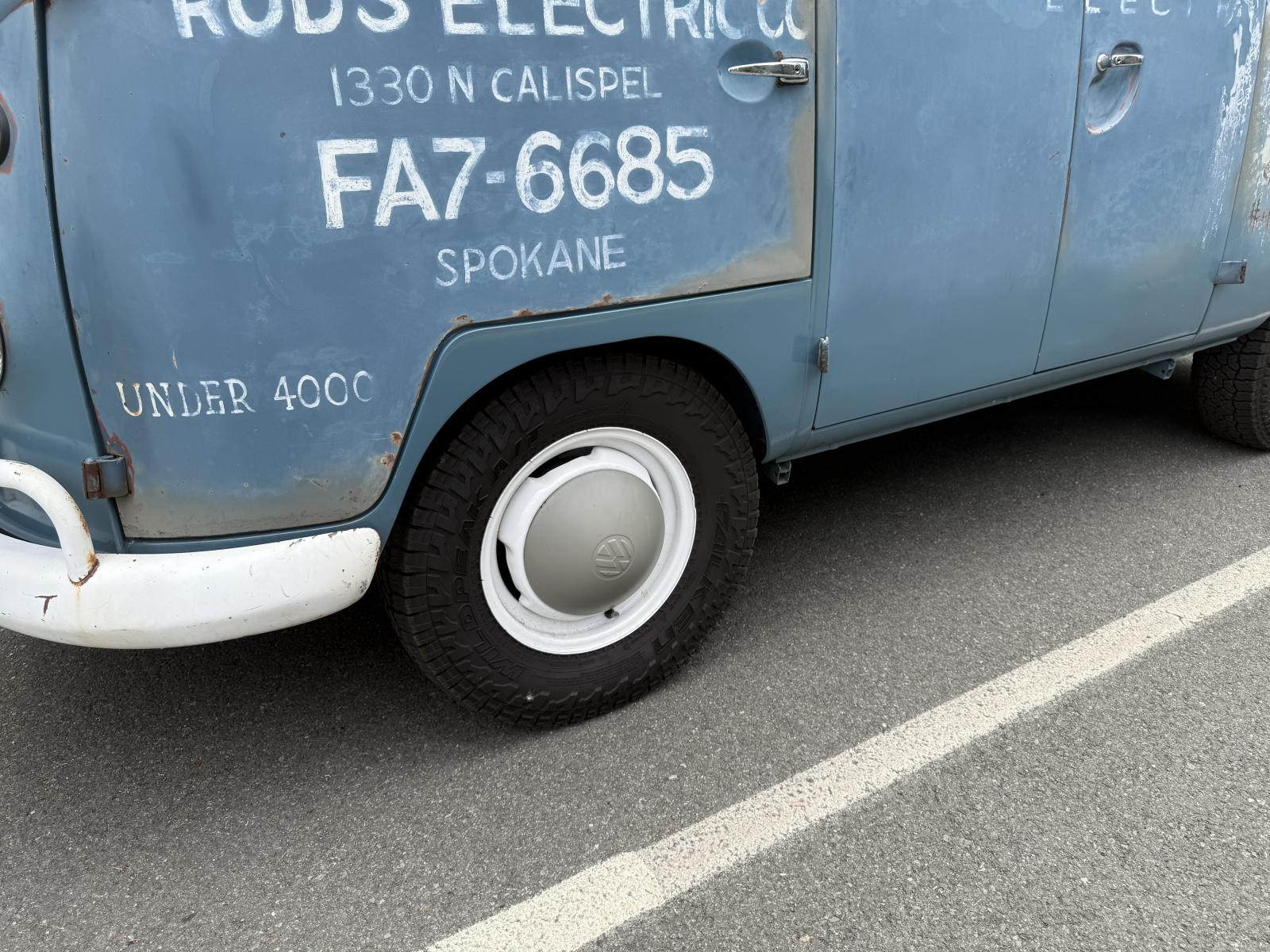

PostPosted: Fri Nov 29, 2024 8:37 pm    Post subject: Re: Large tire/big meats - Stock suspension Bus thread Reply with quote
205 75 15 AT2 Grabbers on my '58, good fit, tough enough, on/off road, quiet, nice ride, 4ply on stock rims. Getting hard to find. Next set going to 215 75 15 KO2's ,a bit taller, but a 6ply rating, more meat for overlanding.
