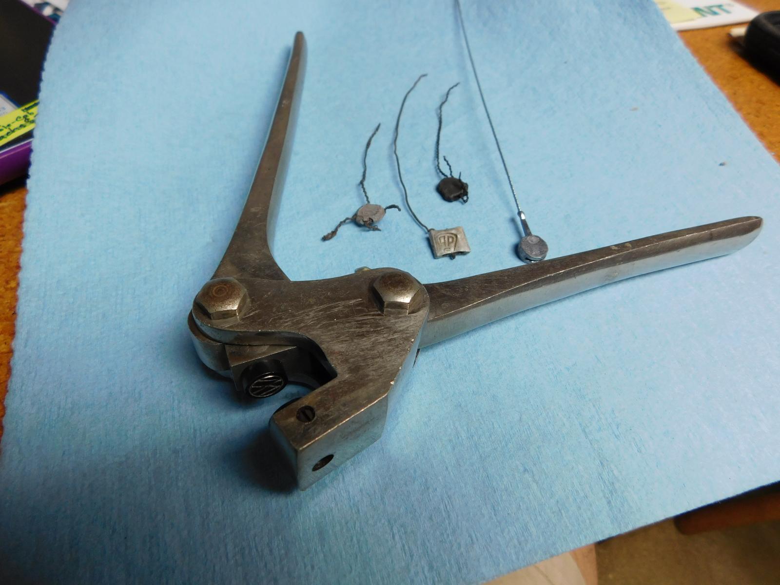

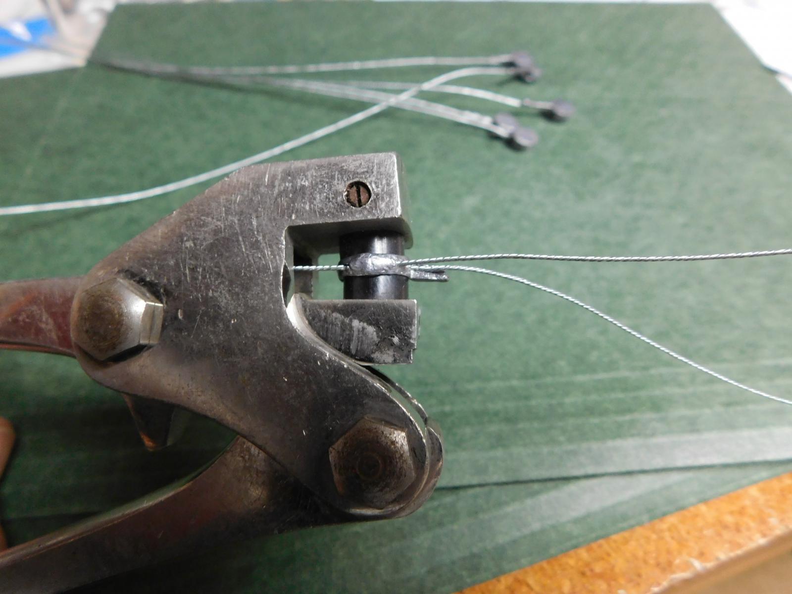

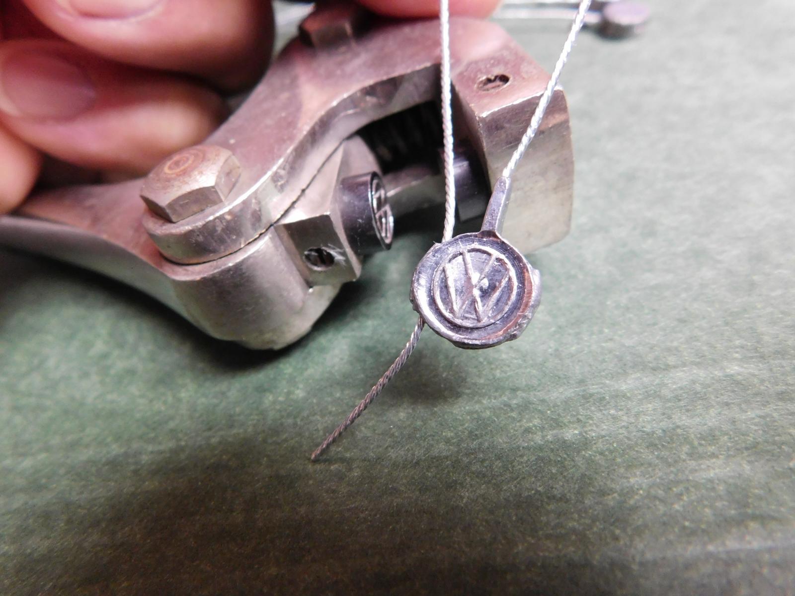

Ah! I found a couple of photos of the VW dealership special service tool that I have that a technician would use to install a tamper evident lead & wire seal onto the closed-up cover of a Transporter "speed limiter" (governor) and then he would crush the new lead seal and impress a VW logo into the lead seal.
before: three old used and removed seals on the left, and a new ready-to-go lead and wire seal on the right.
during: the special service too with VW logo dies crushing the seal.
after: the the wire and seal are locked and the VW logo is impressed into the seal.

Hi all,
I kinda suspect that one of the main reasons for these "speed limiter" devices was to keep the engines in work Transporters alive a lot longer. Workers who didn't care to treasure or protect their employers work truck that the employee drove around might ocassionally (or even always) drive them abusively. To keep repairs and engine rebuilds down, "speed limiter" equipped engines could be set by either the employer or at the VW dealership to prevent over-reving. They could be sealed with a tamper-evident wire with lead seal.
I even have a special service dealership tool in my collection that was used by dealership mechanics to crush the lead seal on the wire while at the same time impressing a cool VW logo into the lead seal! This made it evident if anyone tampered with the speed limiter rpm settings...
I'm pretty sure I remember writing a whole article in my "Transporter Talk" Hot VWs article days all about these "speed limiters" if someone needs more info...

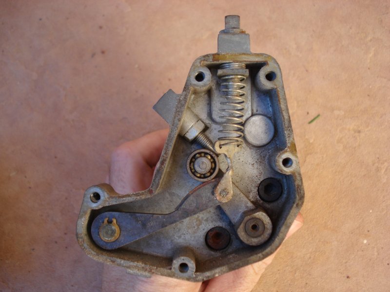

I have one that has the cap loose, here's what it looks like with the cap removed:
It's had the entire valve removed too
