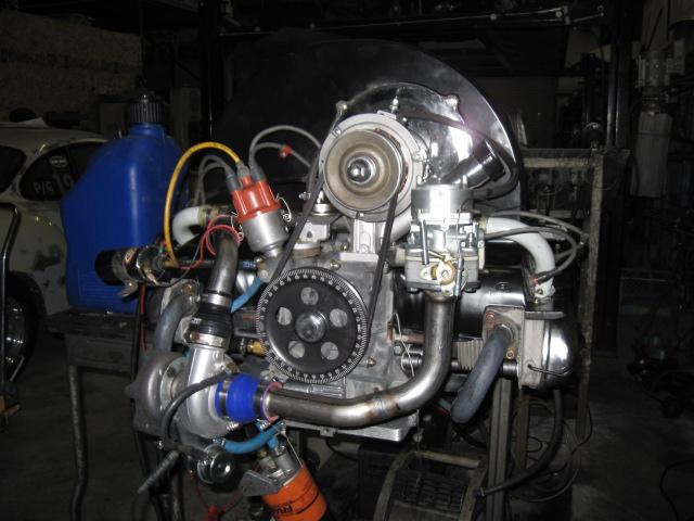

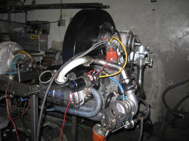

Joel Mohr
Joined: March 07, 2002
Posts: 269
Location: High Desert SoCal
Joel Mohr is offline
PostPosted: Tue Jul 19, 2016 9:24 am    Post subject: Re: Homemade Turbo 1600 Single Port recipe, DYNO'ED, NOW T3/T4!! Reply with quote
Just finished dyno tuning a 1915 with our kit, 200 HP 220 TQ...small cam and some head work...
SEE YOU AT THE RACES!!!!
Joel Mohr
Posts: 269
PostPosted: Thu Jul 14, 2016 10:48 am    Post subject: Re: Homemade Turbo 1600 Single Port recipe, DYNO'ED, NOW T3/T4!! Reply with quote
Pretty much! The kit doesn't come with a locked out 009, but other than that, It doesn't require any other parts. The turbos went up though, and the kit is now 1900....throttle cable for a bug, header, rebuilt Kadron pre-jetted, intake, boots, clamps...as you see in the pics...

PostPosted: Thu Jul 07, 2016 8:09 am    Post subject: Re: Homemade Turbo 1600 Single Port recipe, DYNO'ED, NOW T3/T4!! Reply with quote
Just thought I'd update what has happened with our kits....I built a 1600 SINGLE port, all stock, and the first set of pulls it made 170 TQ, and 139 HP at 11 psi with a measly T25 with a 49 ex housing and a 48 compressor housing...on pump gas....with race gas and more boost, I'm sure I could confirm the original posters findings....amazing...
