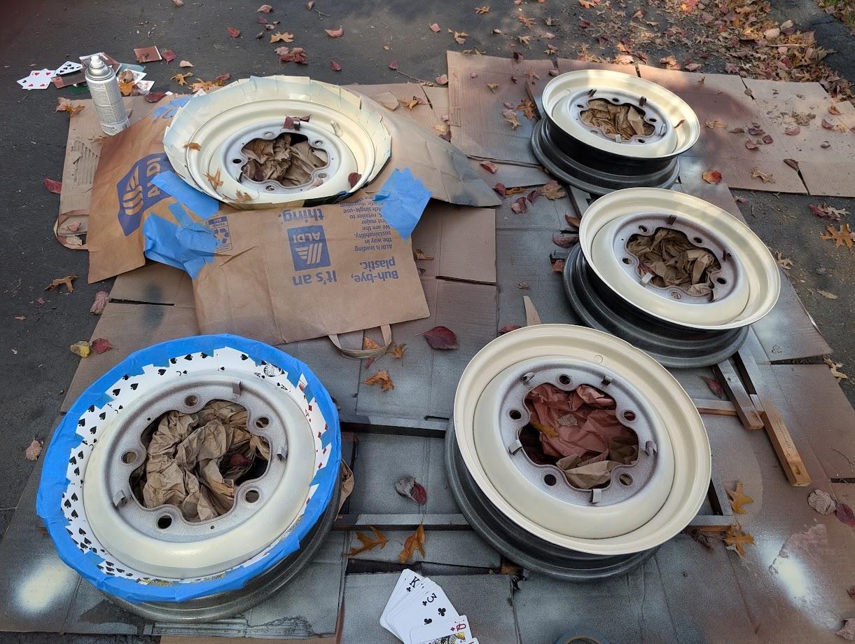

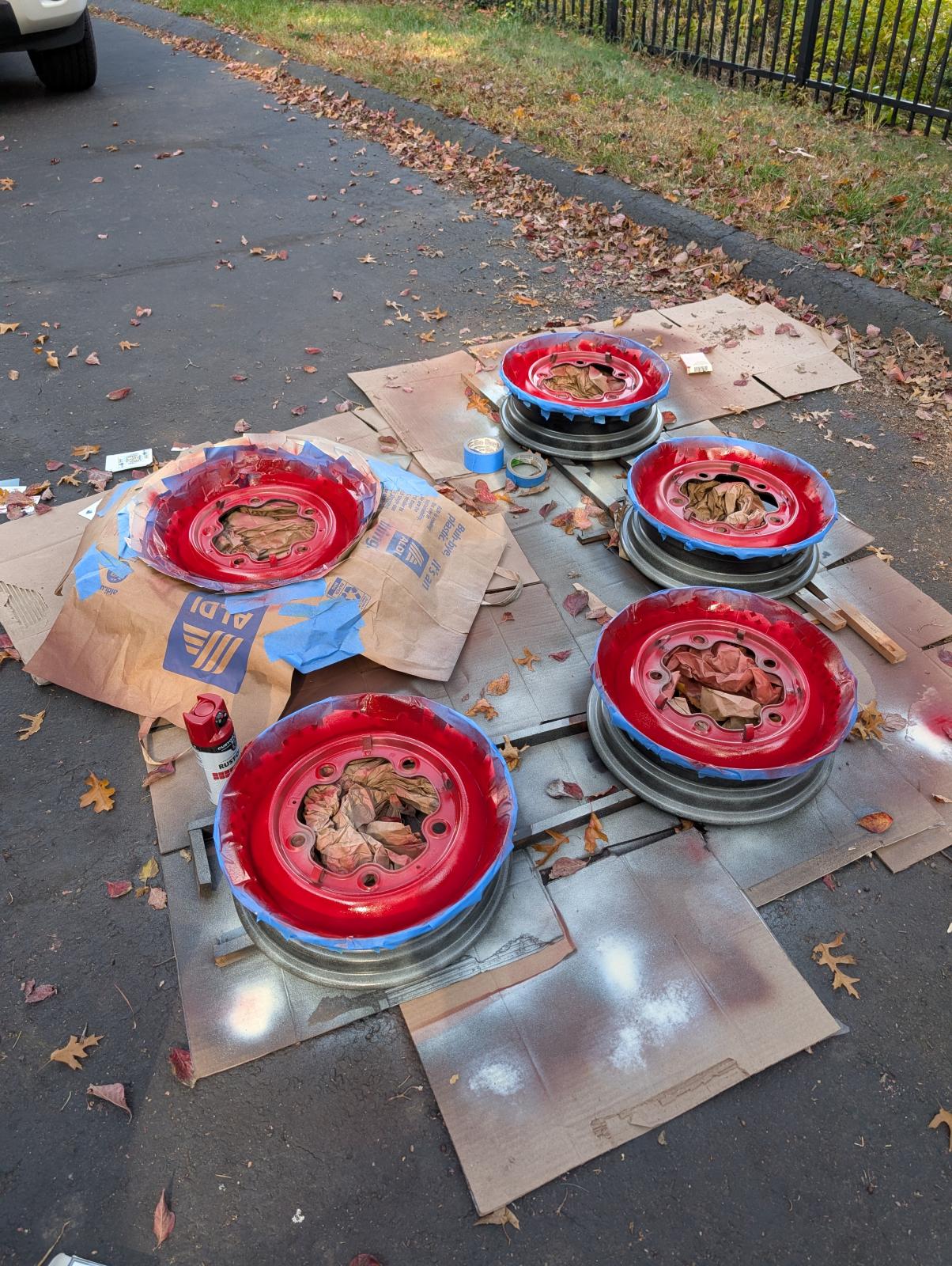

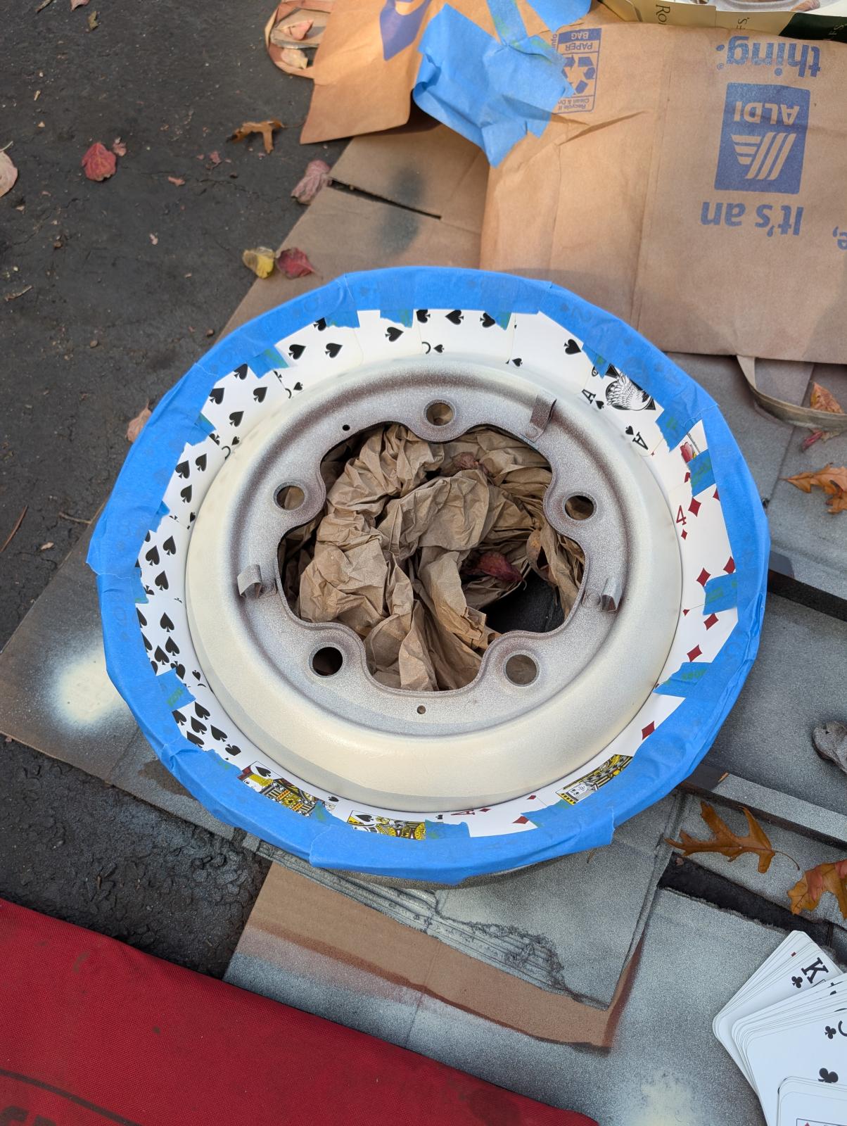

My '62 currently has later slotted rims with rotted tires, and I really want to ride with the baby moons. I had three period correct smoothies, just need to acquire one more. I scored one, and this week I de-rustified, cleaned them up and painted.
I knew I wanted two-tone, with red to match the interior. I just used Rustoleum rattlecans from Lowes. The red (Regal Red) was a little brighter than I wanted. They had Brick Red which would have been perfect, but only in satin. I wanted glossy. I researched as to whether the ivory should be on the outer rim or inner, but I've seen it both ways. Ultimately, after looking at numerous photos here and elsewhere, the ivory on the outside looks better with blackwall tires, acting as a substitute for whitewalls. Running with whitewalls, the darker color would look better outside.
The fifth wheel in the photo is the spare that is already mounted with a very nice looking old bias-ply. It's not holding air, but it looks damn good in the trunk. I'll address that in the future, but for now, four new 165/80R15s are on order at the tireshop.

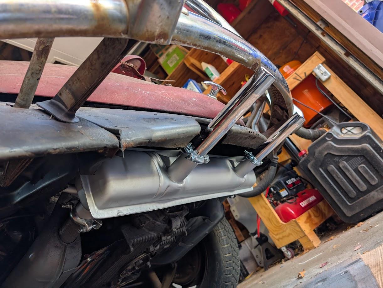

Installed a new muffler on my '62 with fresh air heat. Stripped and repainted with VHT primer and aluminum paint.
I could NOT get one bolt started in the threaded hole of one of the Heat exchanger connections. I could get the holes lined up, but I think the gasket was to snug to easily adjust, so it may have been getting in the way. I finally dug up a slightly thinner bolt to pass through and attach with a nut. That seem to do the trick.
The heat exchanger heads lined up with the heater boxes close enough to get the clamps around, but barely. But she sounds nice with the classic "fweem".

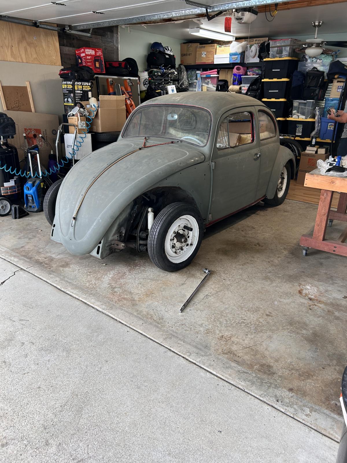

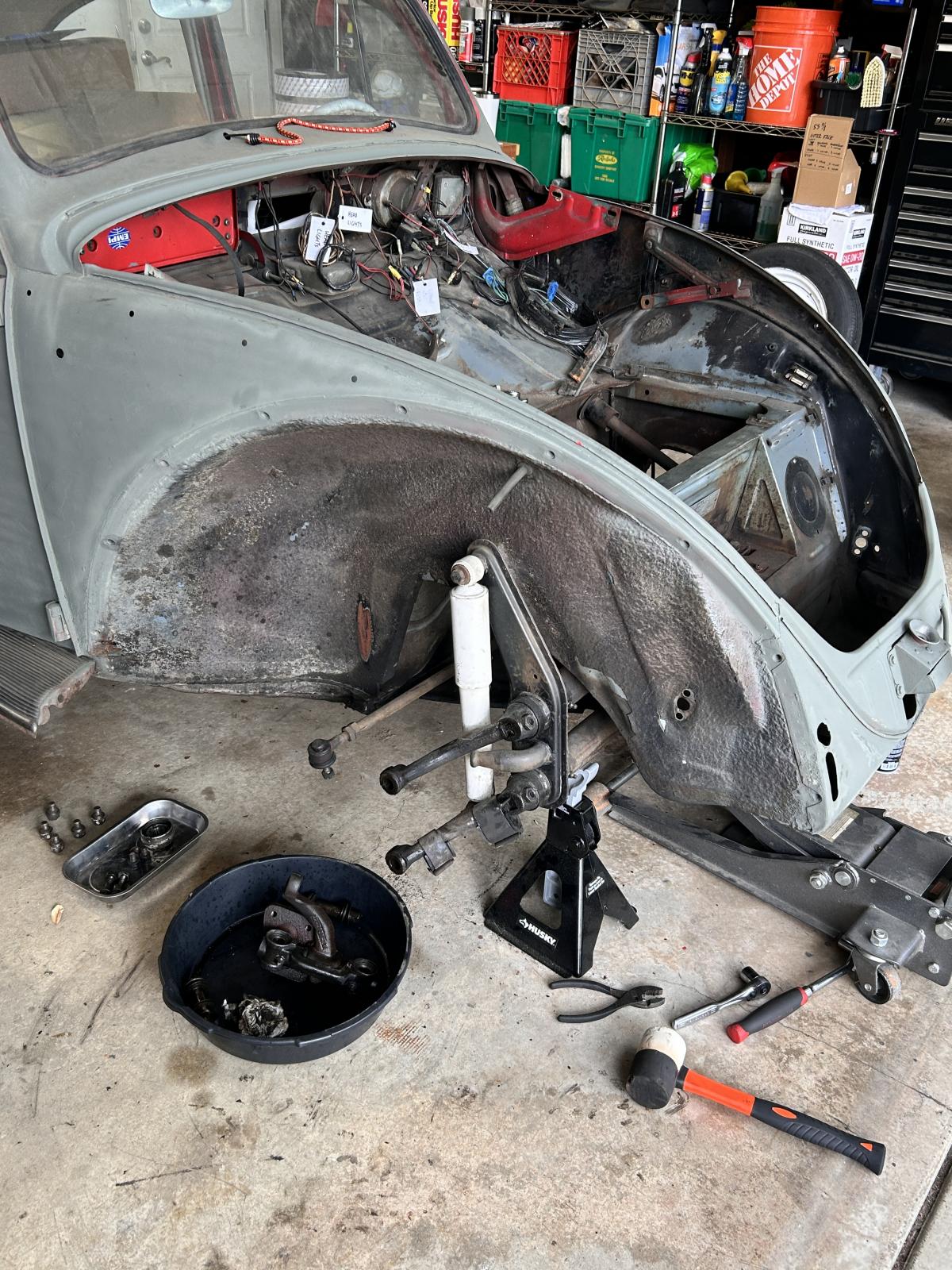

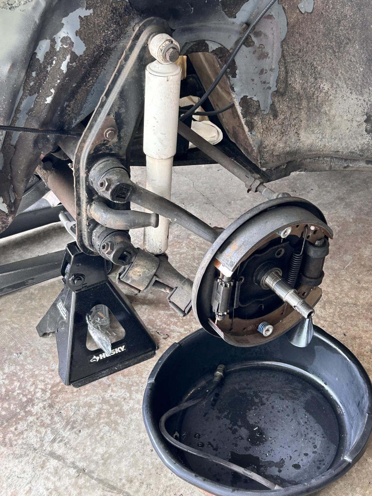

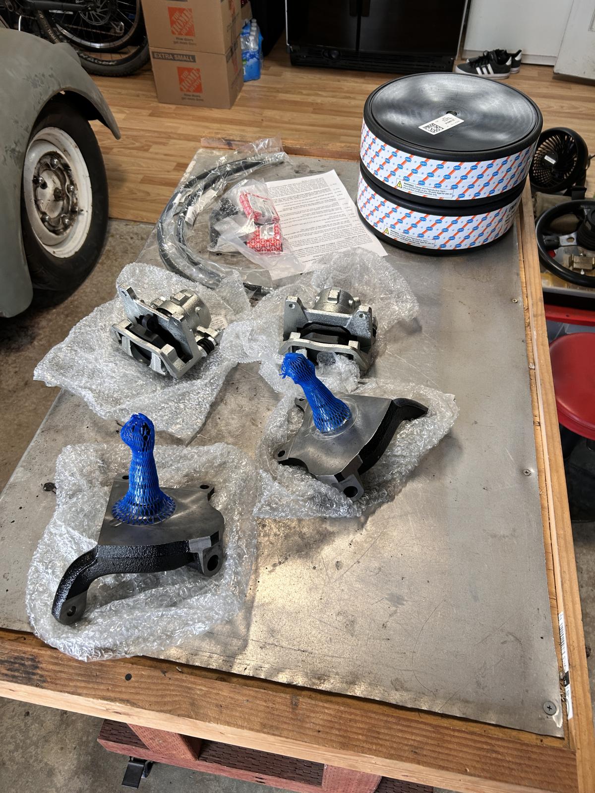

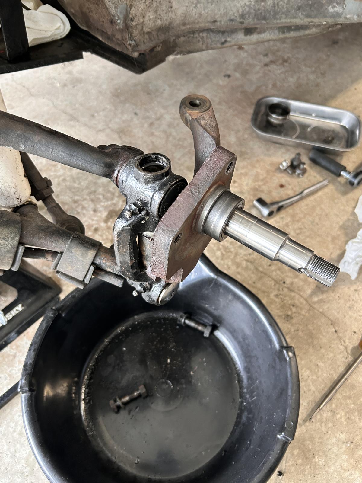

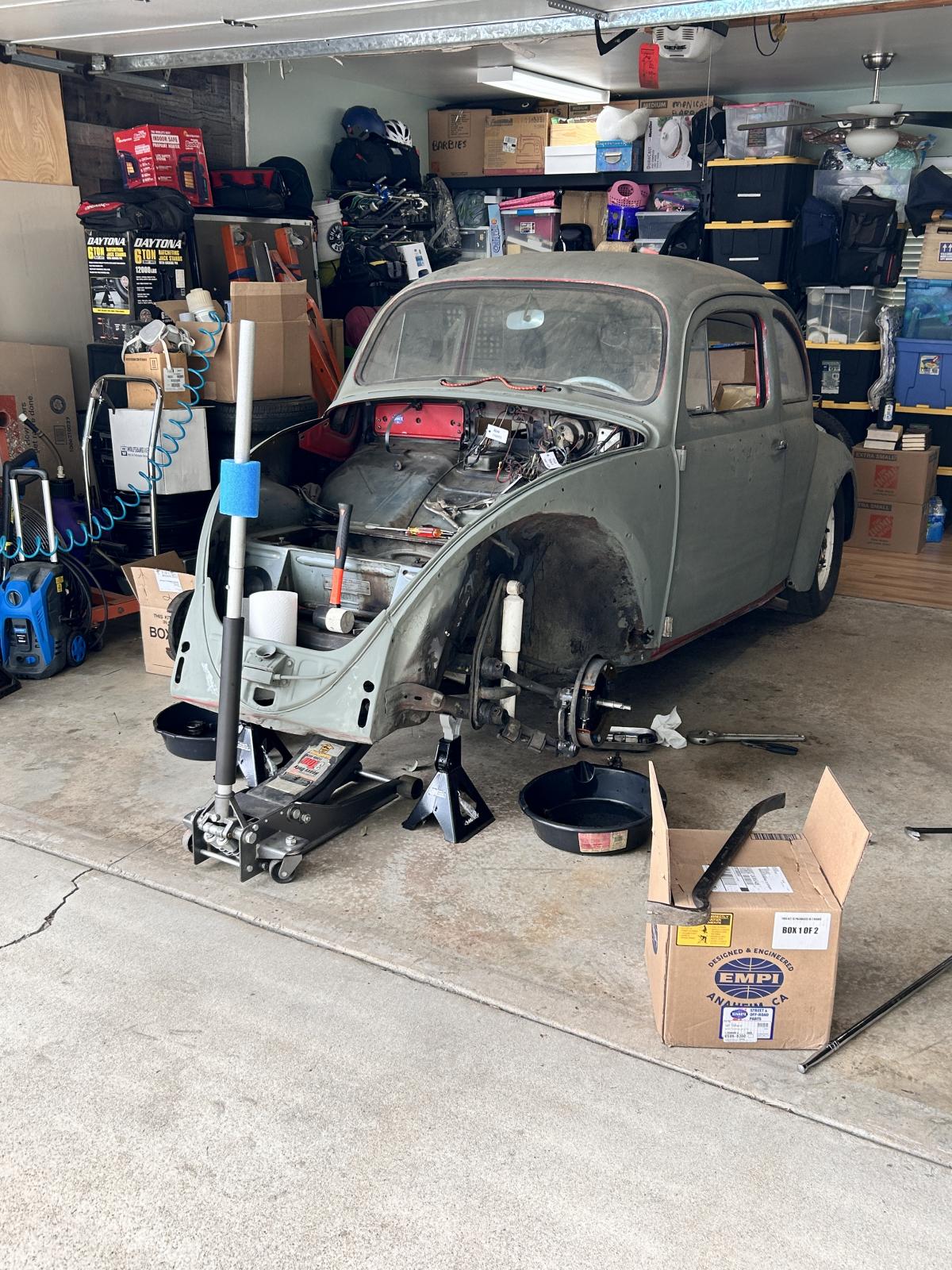

Prepping for a front brake upgrade on the ‘58 with an EMPI disc brake kit.

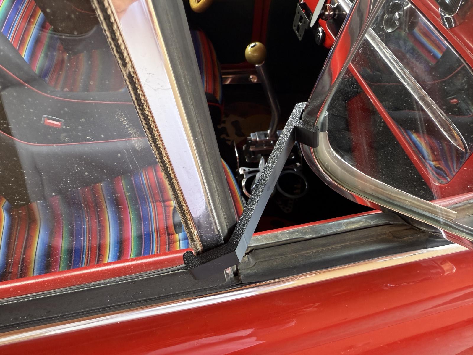

I printed a copy of Uniwerks vent window Cool Stik. I did not see a beetle version on his site, so I feel it is ok.

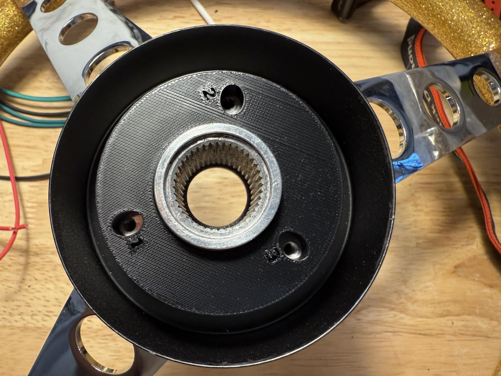

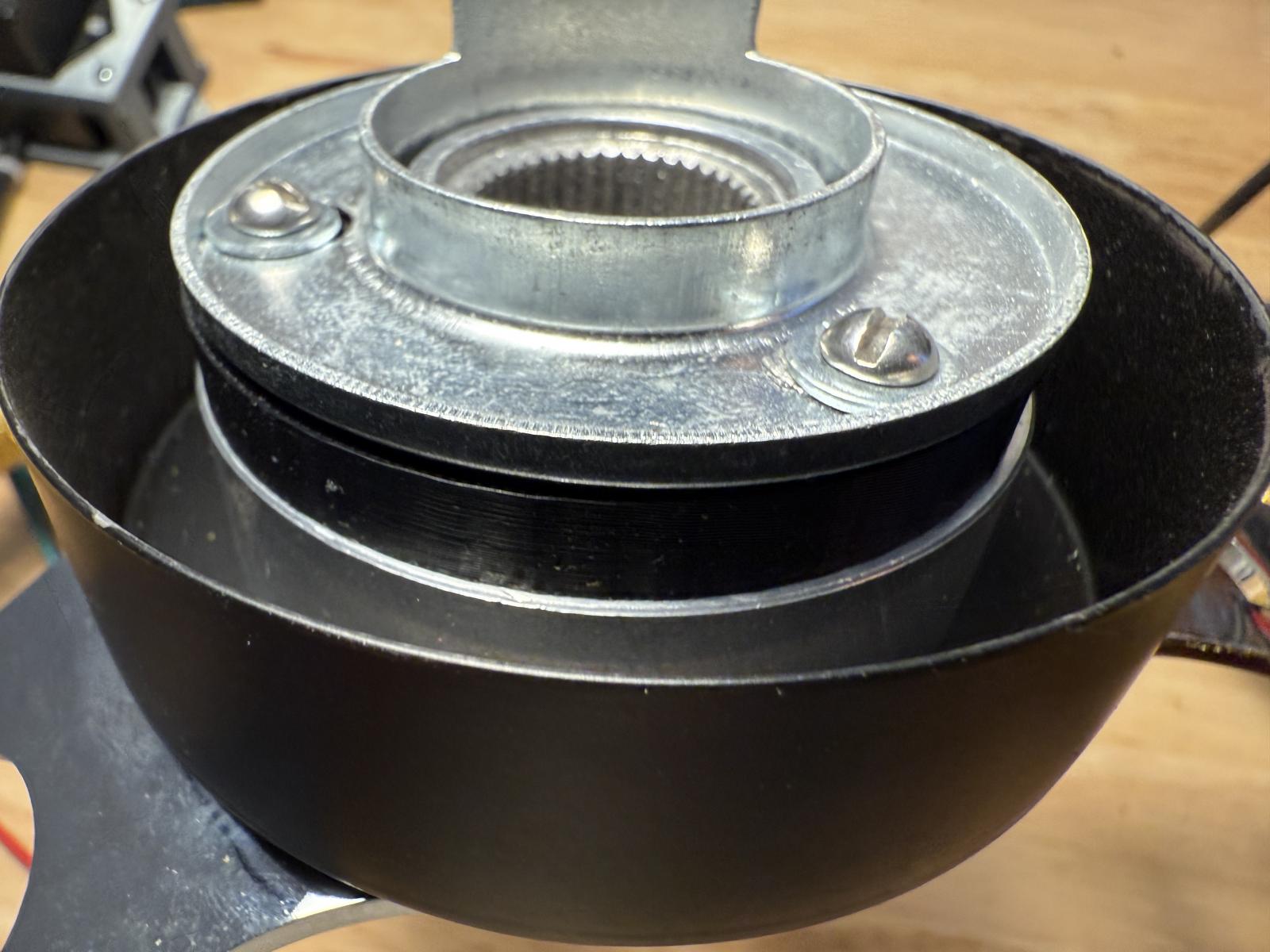

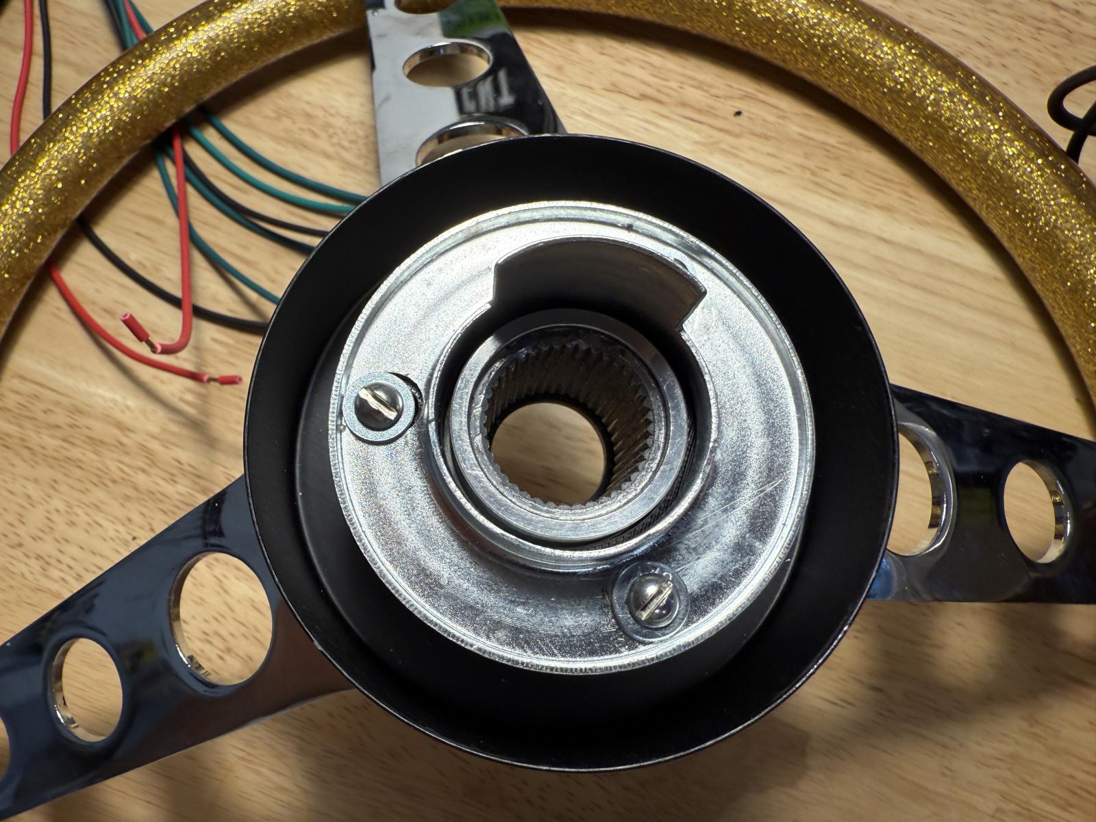

Got my baja back from the shop and I wanted to fix something that always bugged me, the cancel ring did not sit quite right on the Moon eyes wheel. So I printed a spaced, which I like a lot more.
