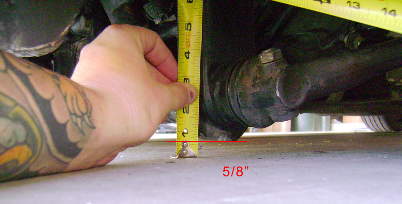

On my ride I did the thru rod on one beam only, leaving one beam with the stock spring leaves. I narrowed a set of the teflon bushings on my lathe. It doesn't go insanely low but serves my purpose.
At stock height I could roll a basketball under the front of the car, it looked stupid that way!
I have several photos and my complete writeup way back in this thread somewhere

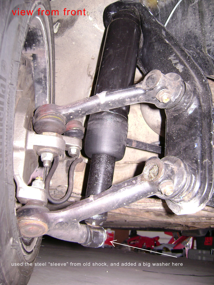

While ordering parts, I tripped across the Monroe air bag shocks, since they were stupid cheap, and this project needed shocks anyway, I decided to score a set so I could join the cool kids with air ride.
Upon the first trial fit, I found that not only was the lower eyelet was too small a diameter to fit over the stud on the lower trailing arm, but to was also too long.
Well, I remedied this by pressing the lower collar out of the old shocks...
And stuffing them into the new ones.
I was then able to install the shocks onto the trailing arms but I then found that the shock bodies were too large in diameter & were fouling against the upper arms.
After a bit of research in the late model Beetle forums, I found that this was a common occurrence & that quite a few grind away on the upper control arm to gain the necessary clearance. This has got to be the stupidest fucking idea ever.
Knowing that there had to be a better way, I came up with my own solution.
With a bit of adjusting, I determined that the shock needed to be moved inboard roughly 1/2” and the hole in the beam needed to be opened up about 1/4” and the shock body would just clear the upper trailing arm. However, there is not enough length on the lower stud to slip enough washers on before there aren’t enough threads to install the nut, so I made a longer lower shock collar that was also the nut.
First, I welded a nut to a washer...
removed a collar from another old shock, slipped it onto the trailing arm, tightened a nut against it & welded them together.
Not having a lathe, I threaded a stud into the collar & chucked it into the drill & turned the weld & nut down with a die grinder.
Once it was ground down to size, I then welded the other side of the washer to the pared down nut & turned it down too.
After applying a bit of SilGlyde, I then pressed it into the shock.
Then, using a carbide burr on the die grinder, I opened up the hole on the beam a bit to the rear & towards the inside & after mounting the shock in place, I checked for any clearance issues throughout the range of motion.
