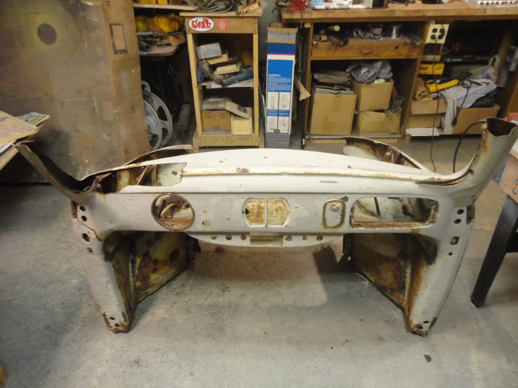

PostPosted: Sun Dec 05, 2010 9:25 am    Post subject: Reply with quote

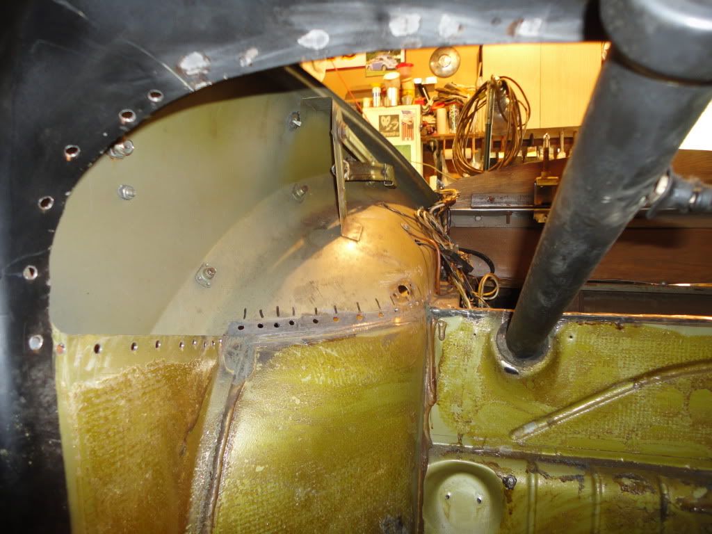

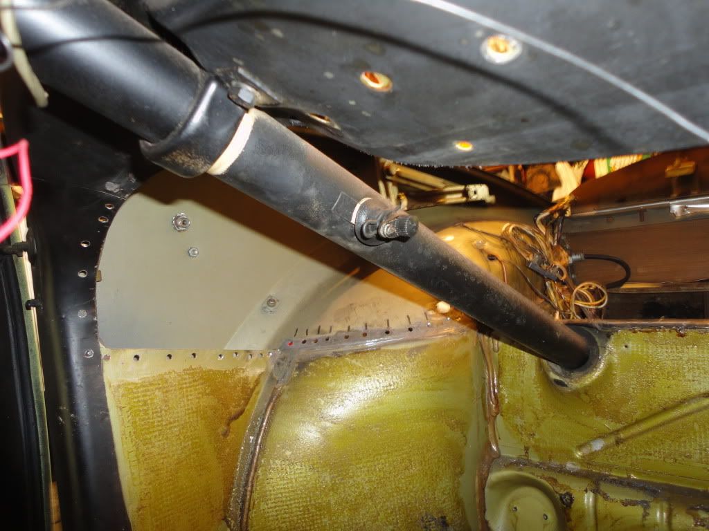

Made patch pieces for the holes. Tacked them completely in until I got the hole seam covered.
I then ground the welds down until it was smooth.
Cut this piece out too. This part is partially under the radio.
A little filler and you'll never know
This has to go too.
Tacked in and ready to go.
Clean OG paint under the layer of undercoating Very Happy
Garage shot

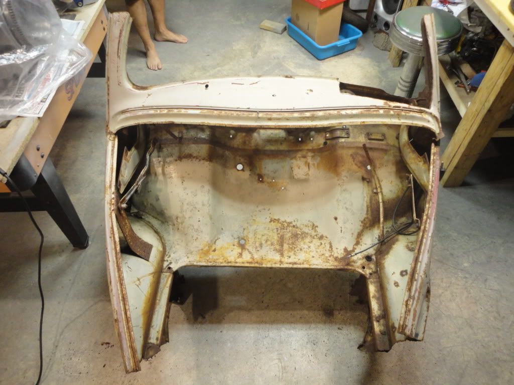

PostPosted: Fri Nov 26, 2010 7:08 pm    Post subject: Reply with quote

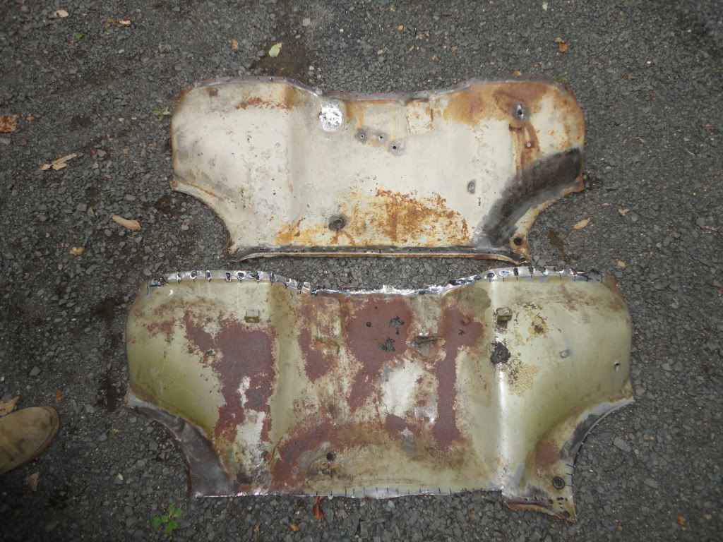

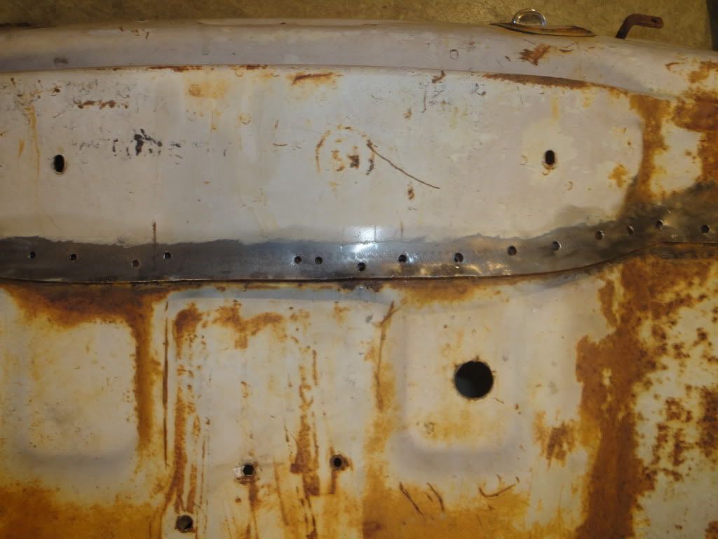

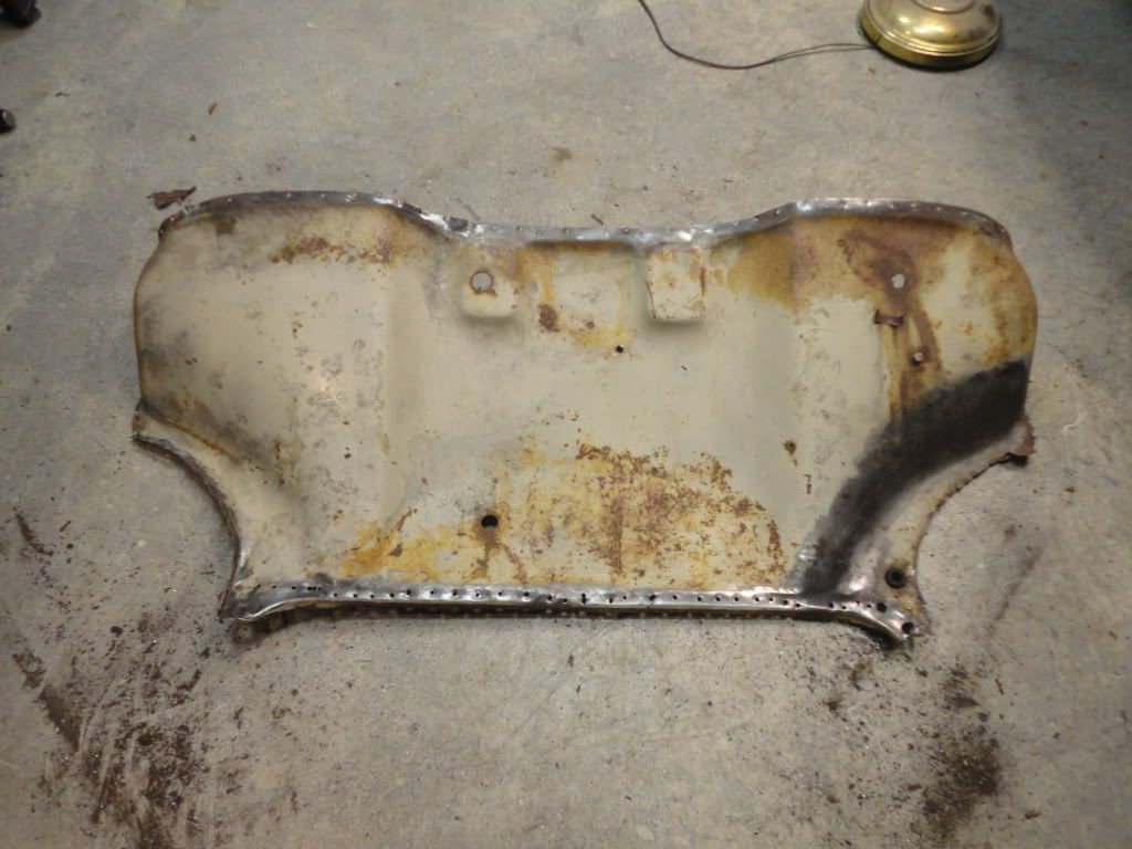

Next project. Donor '54 front clip.
Painstakingly drilling out every spot weld.
Finally out. Now I just need to do the exact same thing again to the one on the car. Rolling Eyes
BAM and it's out. You can see the one I removed from the car (bottom one) was full of rust in the middle and along one of the edges. It was from mouse urine that soaked in the old cardboard trunk cover and rusted through.
It's weird seeing the car like this.

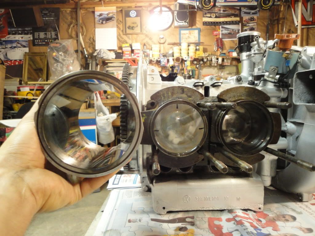

PostPosted: Wed Nov 17, 2010 5:47 pm    Post subject: Reply with quote

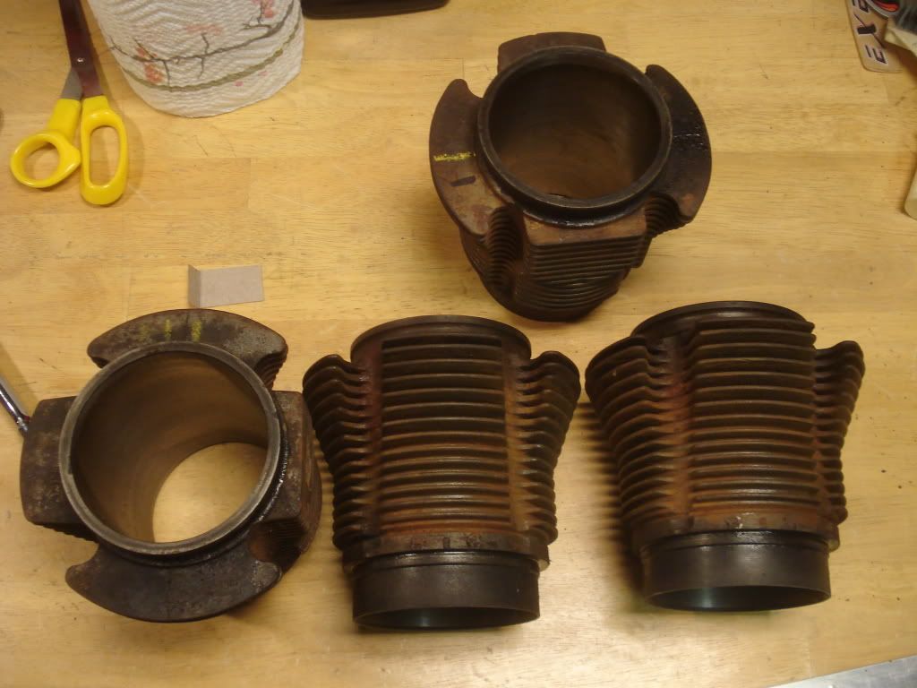

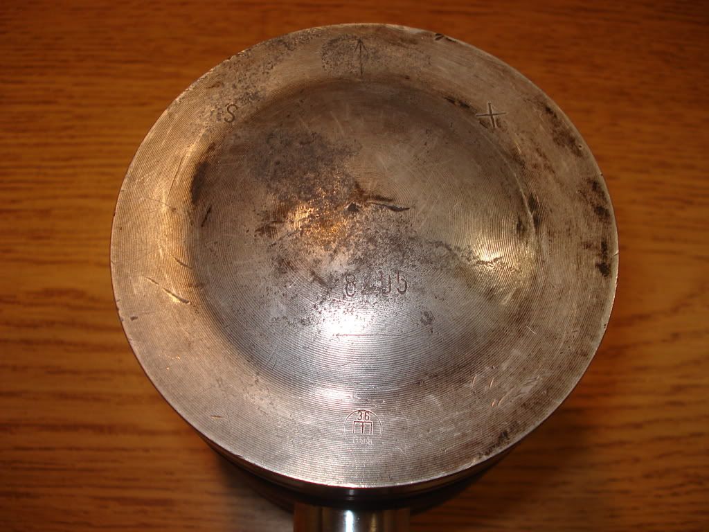

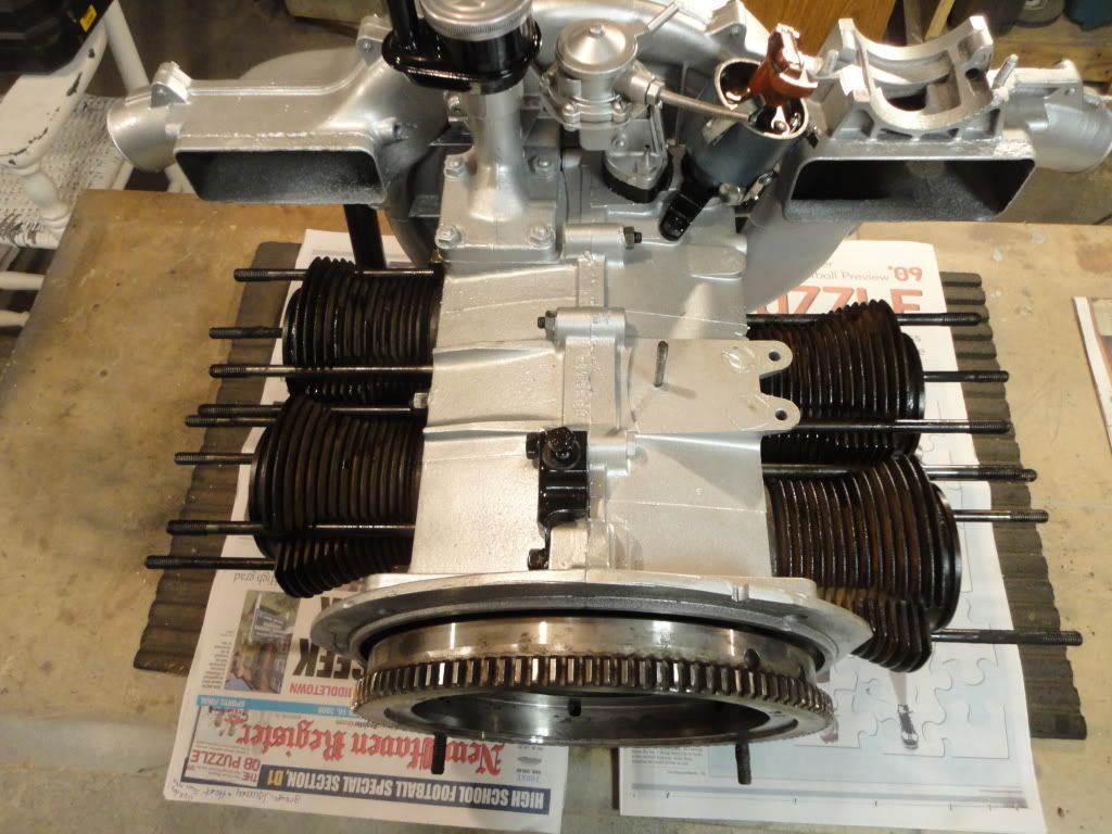

Assembled
Top Fuel Dragster sleeve vs. 1500cc aircooled piston Laughing

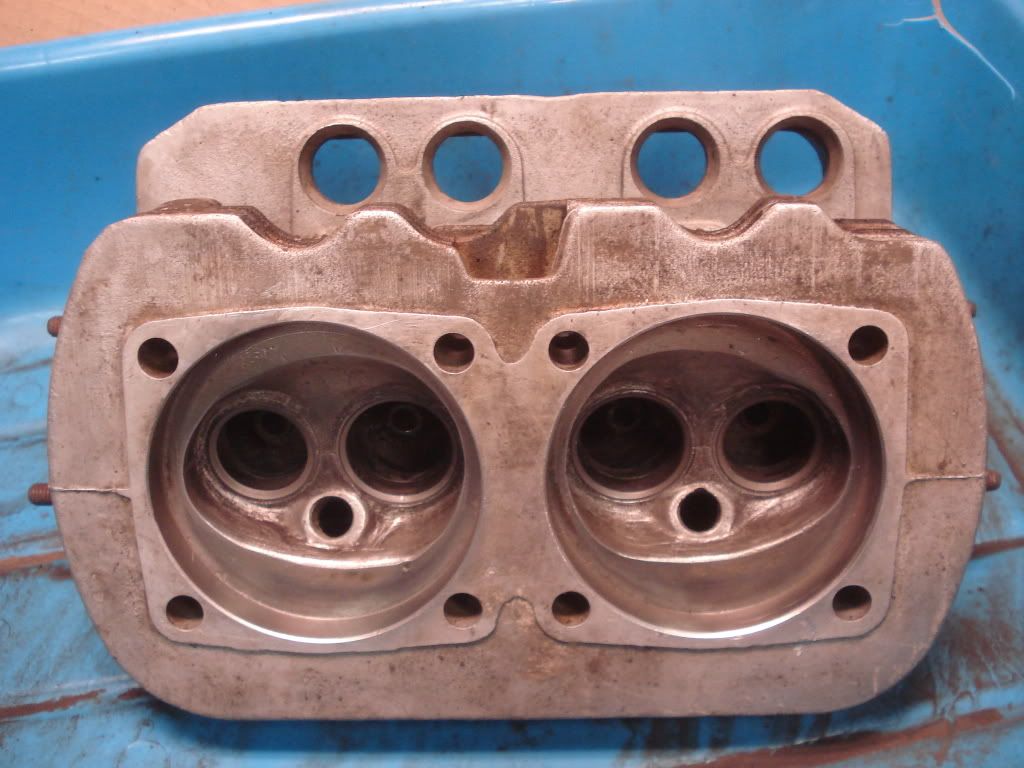

PostPosted: Wed Nov 17, 2010 5:45 pm    Post subject: Reply with quote

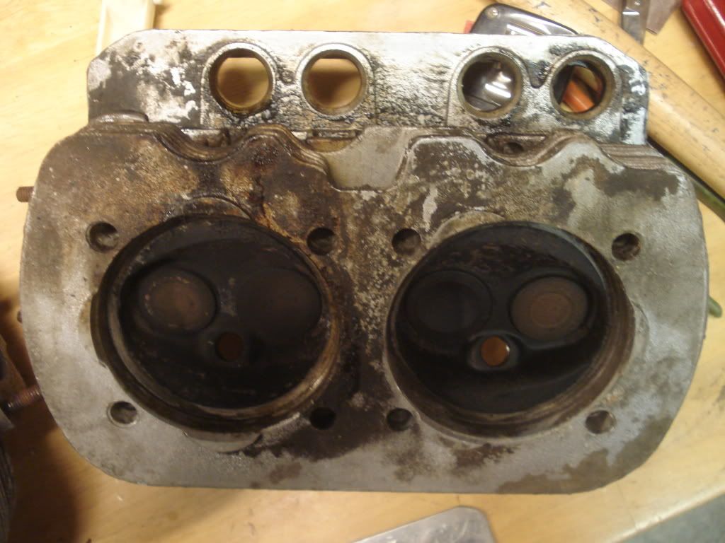

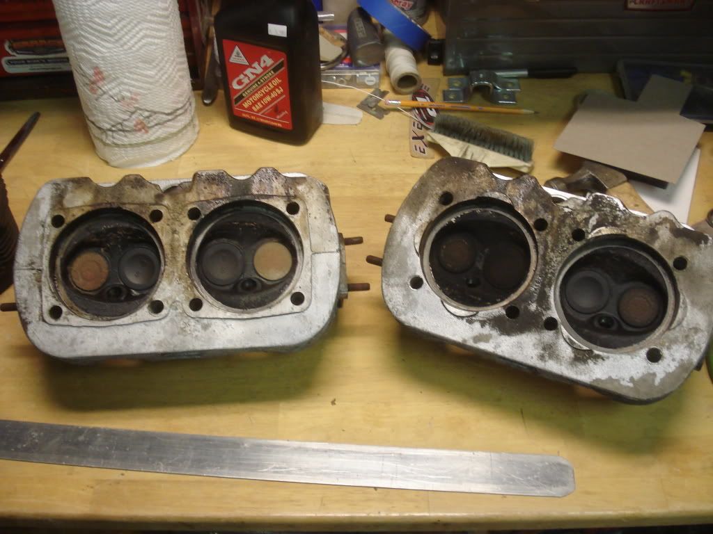

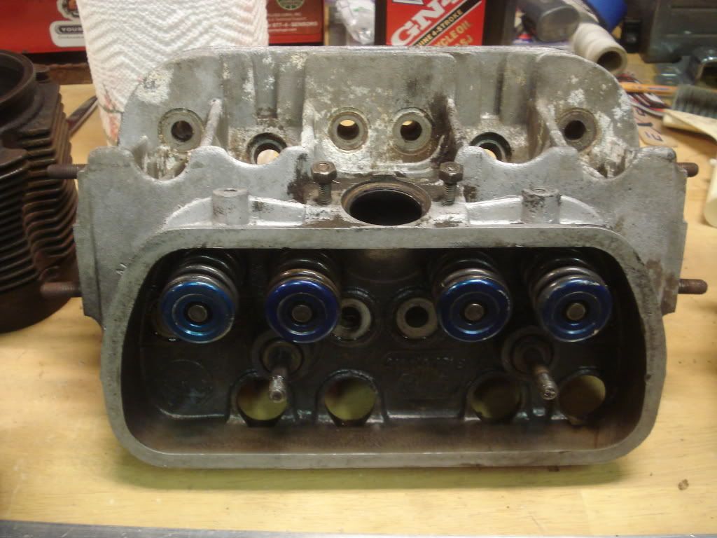

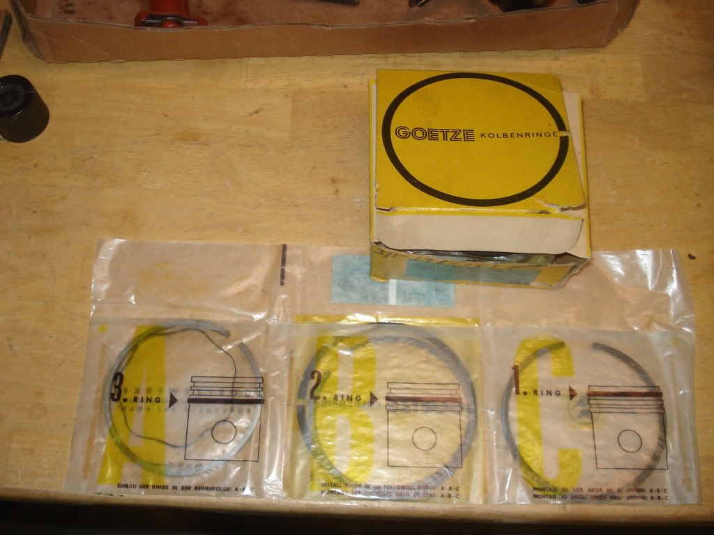

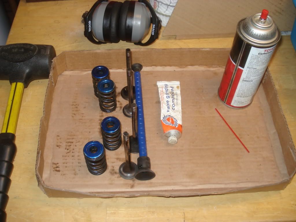

Honed and ready to go
Freshly cleaned head
Complete set of NOS 83mmx2.5+2.5+4mm Goetze rings I got at a swap meet for $5 Very Happy

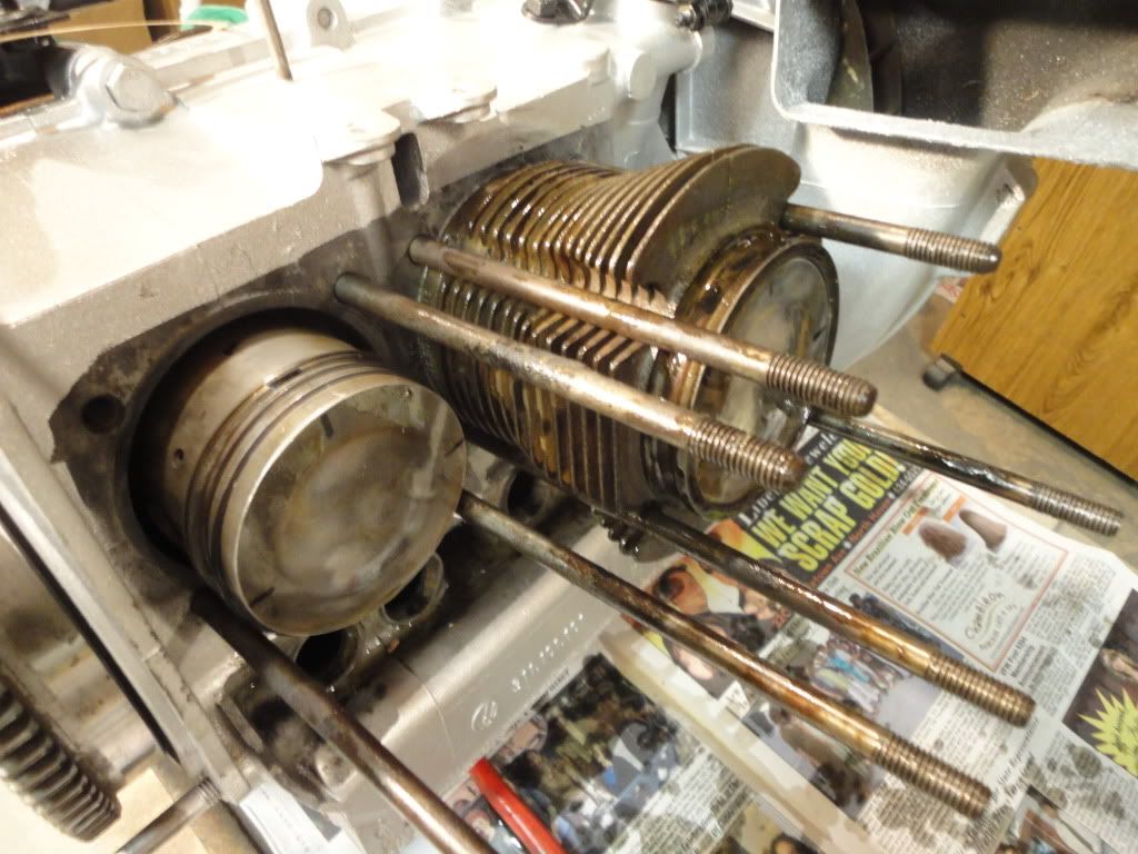

Nice R-code engine, not a lot of them around anymore. If you're going to run the domed 83's, don't fill the tank w/87 octane. This was a 2-year, high-compression engine ('64-'65) and a lot of owners blew them up by being cheap at the pump. That's why VW went to the 1600--you can run them on regular.
I guess this qualifies you for membership in The 1500 Club...

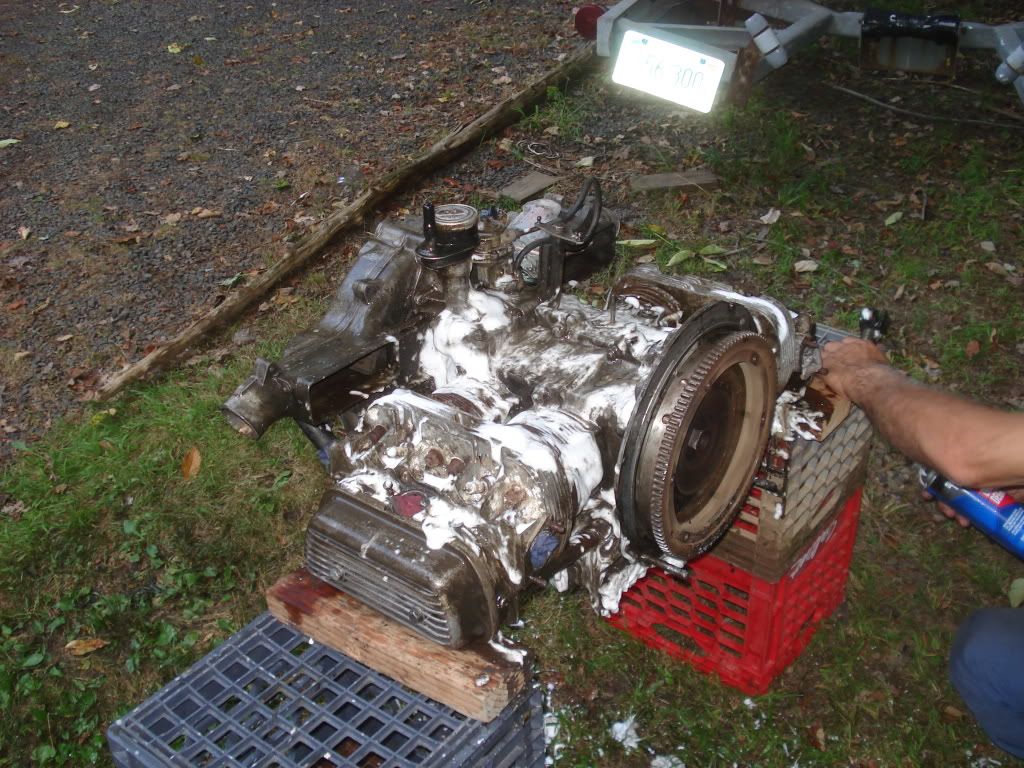

PostPosted: Fri Nov 12, 2010 4:57 pm    Post subject: Reply with quote
paulsvwbug wrote:
nice build you got there, what did you use to clean your engine with?? lots of foam on the engine, I need to do the same to my 40 horse this weekend hopefully.
We just bought some engine cleaner/degreaser at WalMart, using a hard bristled brush to get between the cooling fins and a power washer. Worked pretty good. Then as we took the motor I cleaned everything with carburetor cleaner.

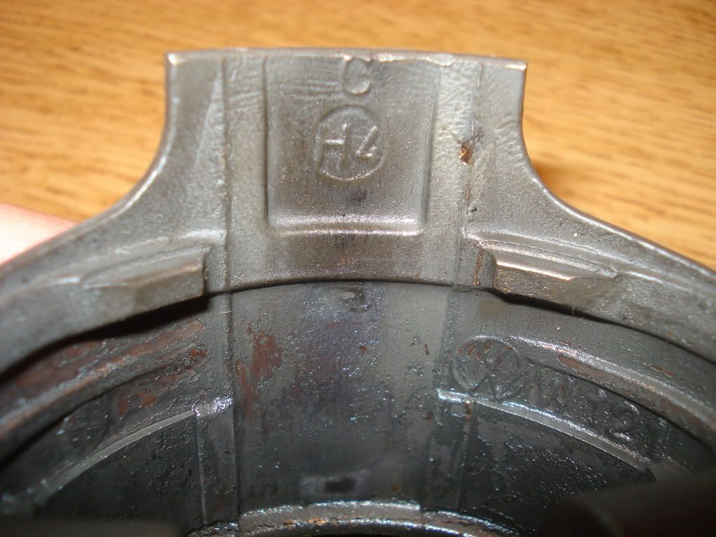

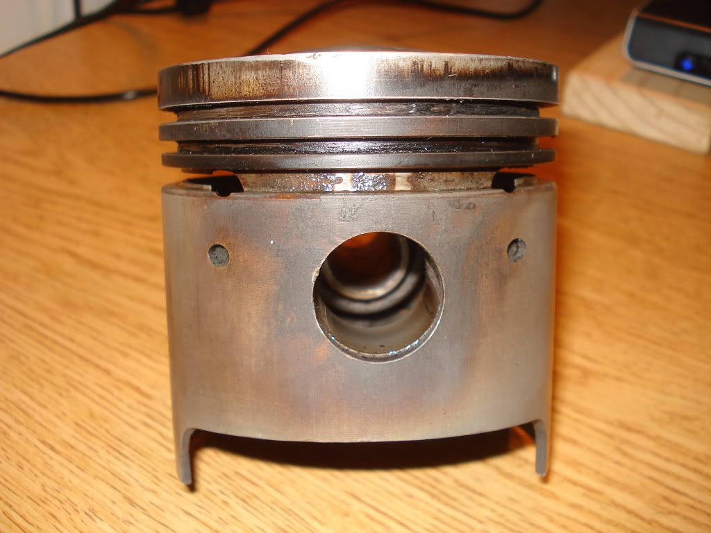

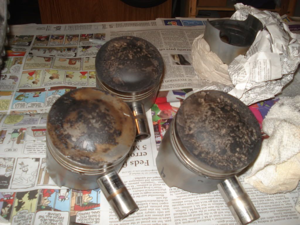

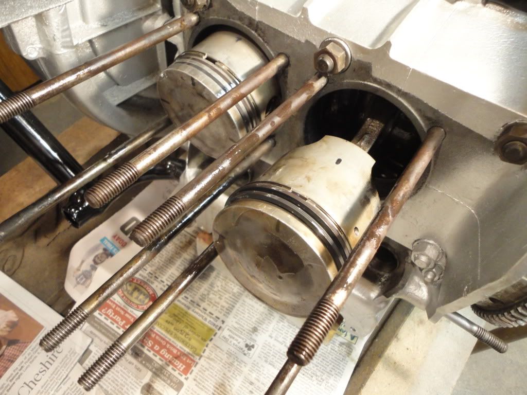

After we got the motor all cleaned up we started breaking it down.
Crusty 1500 pistons
stock 83mm's
Mahle's
'67 Beetle (sold) http://www.thesamba.com/vw/forum/viewtopic.php?p=3289202#3289202

PostPosted: Thu Nov 11, 2010 4:41 pm    Post subject: Reply with quote

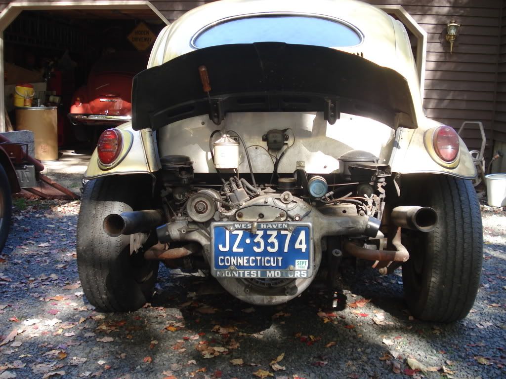

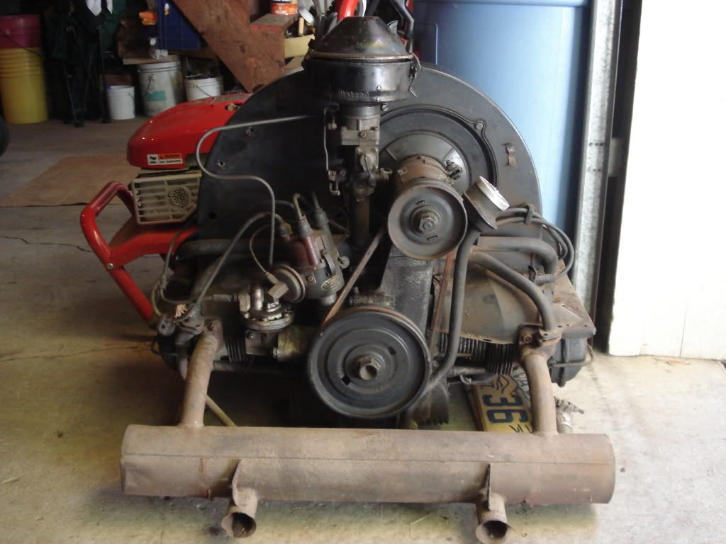

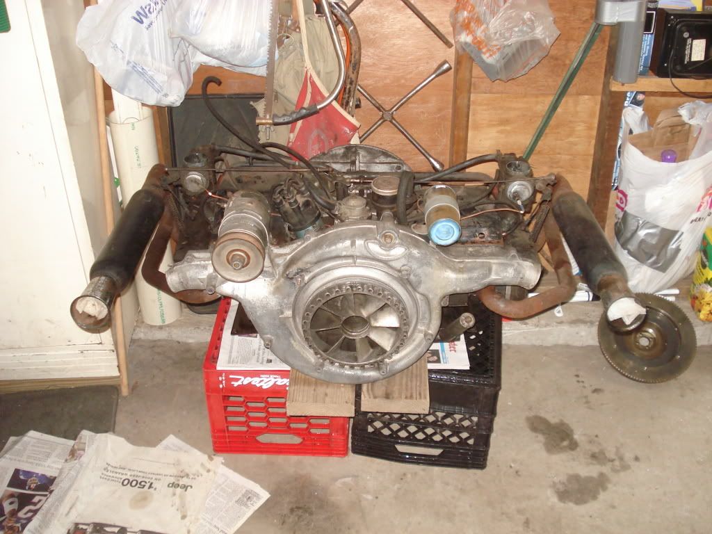

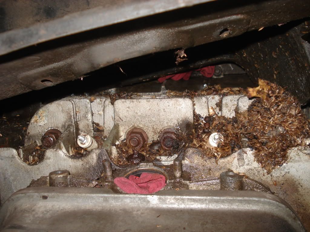

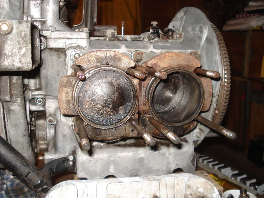

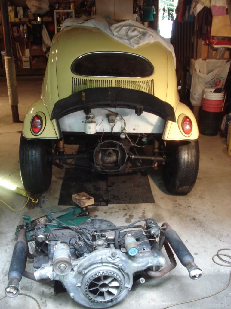

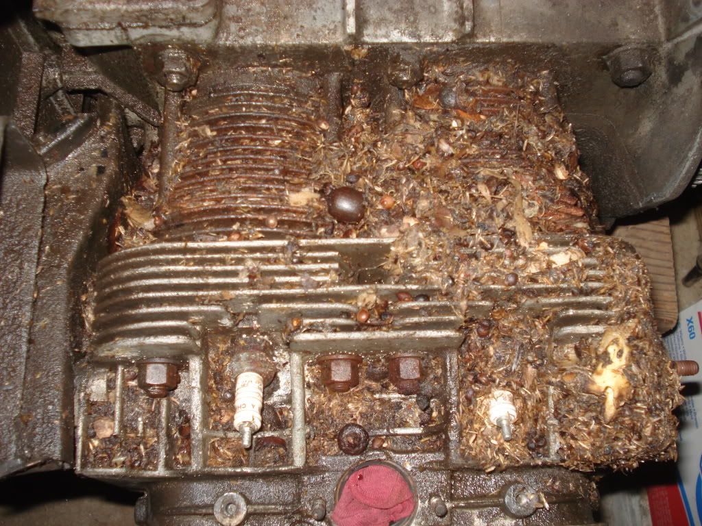

It's been absolutely way too long since I've updated this, so here goes. I have a bunch of stuff to add, so I'll do it slowly.
Engine out...so easy when the rear apron is cut off Smile
This is just the beginning.
Ohh yeah, could you imagine the smell if we tried starting it and all those nuts and mice poop started burning!
It deserved a good scrubbing
