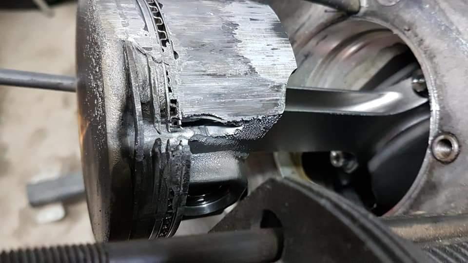

oprn wrote:
That piston had more than just a lean mixture, my guess is it went lean under full throttle, full boost and maybe some nitrous too!
Nope, it was at break in, in a sand rail. The guy couldn't shut it off and ran the buggy around his yard till the carb ran out of fuel. No nitrous, no boost, no full throttle

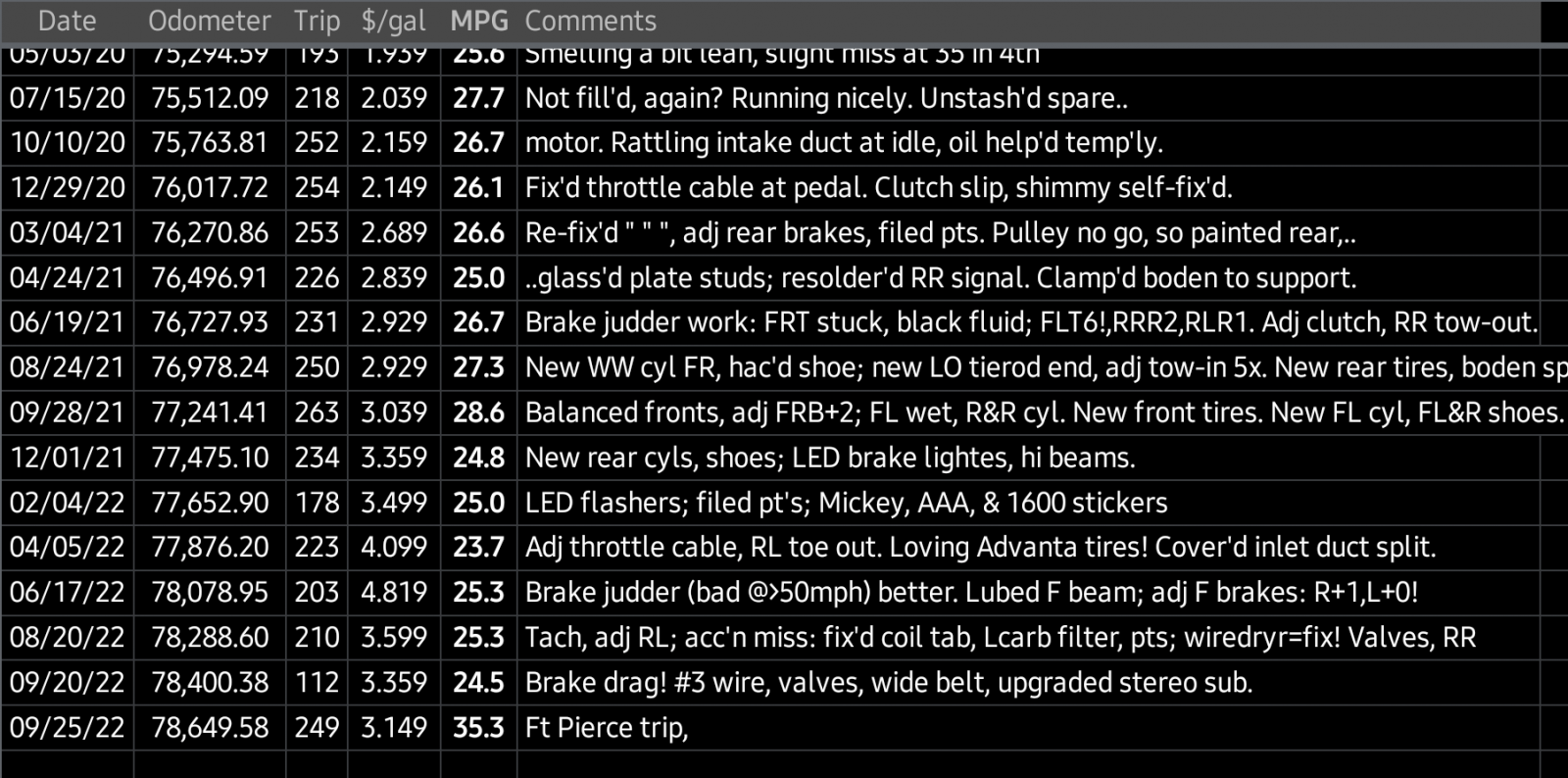

Here are current entries in the mileage log for my somewhat aerodynamic kitcar with 1600dp, twin 32mm carbs, and 009 distributor:
MPG figures are indicated miles per US gallon. The very most recent fill-up entry is almost all highway miles; to and from a car show that got cancell'd, but still had some VW people which made the trip worthwhile. On the way there, I tried to get an estimate of how far off my odometer's indicated miles are from what interstate mile markers show. Unfortunately, I-95 has lotsa curves; never got even one straight mile! Best I could do was average a few 4 or 5 mile segments. So I can't be real certain about correction data accuracy, but my odometer came out 10.2% high with current tires, which have been on since last fill-up of 2021 (an even larger correction is needed for MPGs before that, due to worn-out tread). Applying this correction factor to the latest entry, for example:
35.3 / 1.102 = 32.0 actual MPG
BTW the complete top and plexiglass side windows were on for ~40 miles of the trip there and again on the way back, both times due to rain. All the rest was with driver's side T-top and both side windows removed, stash'd. On longer highway trips, I like having the shotgun side window up. Just that 1 side helps alot on my buggy because it not only reduces turbulent airflow; it also helps direct air into my cooling air inlet scoop, ram charging air into the duct which feeds directly to fan shroud inlet. This may reduce engine load caused by the fan, further helping MPGs. And it probably helps to have windshield laid back more than 45° from vertical.
I used to get better MPGs, back when gas was leaded and my buggy's engine was 1600sp with a 28 PICT-1 and JC Whitney mechanical advance only. Once got over 50 actual MPG on a mostly downhill run at night with top and windows up coming out of the Smokey Mountains. Here are a couple typical pages from my log for 1987 and an additional page from 1990. All the following MPG figures are already corrected from odometer indicated to actual by 8% to 12%.
Although mileage was better back then, I never really liked the way it ran. I'm not heavy footed, only wanna keep up with traffic, and can do that better with current setup while getting just mediocre MPGs.
