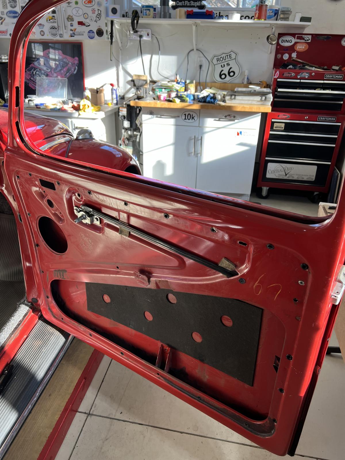

19) Time for more fun…reinstalling the regulator and glass. Start by shoving the regulator up into the door the way it came out. Line it up temporarily by putting the window crank mechanism into its hole in the door panel, then rest the very bottom of the regulator into its support. Now rotate the vent window back into position, making absolutely sure the top of the regulator is INSIDE the bottom of the vent window upright. You should be able to squeeze your hand or fingers up there to hold the regulator tight against the inner panel as you rotate the vent window back in place. From inside out, you’ll have the inner door panel, regulator, window upright, outer door panel. At this point you can put the screws back that hold in the vent window. Give it a good shove toward the front of the door and bolt it in. Check all the rubber and felt around the window channels and replace anything that popped out.
BEWARE: it is pretty easy to locate the regulator improperly.
Make sure the top of the regulator hoop locates toward the interior of the door. If it locates to the exterior of the door it will interfere with the glass path. Quite obvious when you go to install the glass! Tell me how I know! Can’t fix stupid.

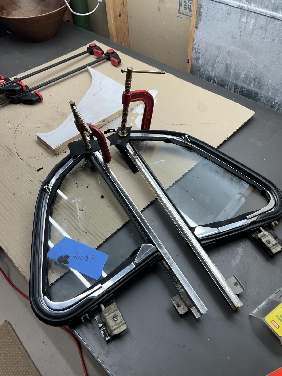

I’m having a similar issue as vdubber with the glass jamming. I replaced all the scrapers and channels as well as the regulator. Now the window rocks forward and jams against the vent channel. I can manually pull it back but I can’t seem to adjust it away. Any tips?
Edit: just needed to take a break. Came back a couple days later and was able to adjust the window mounting properly

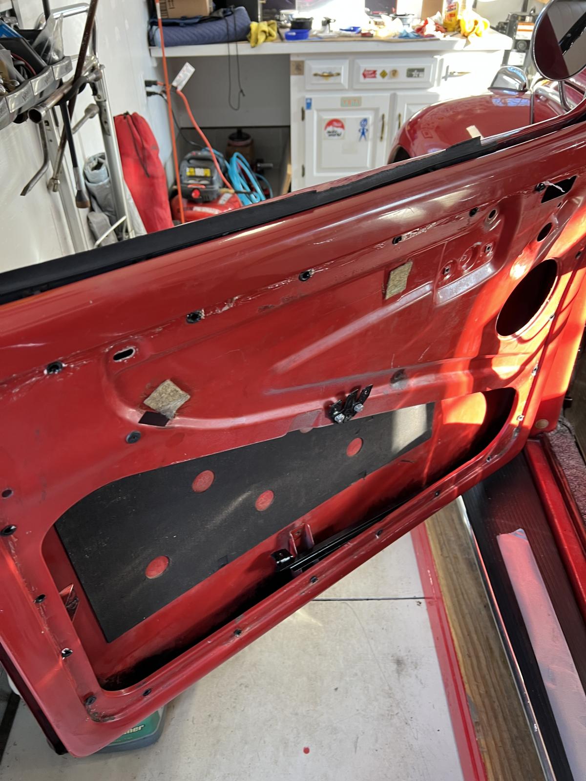

Hey Mike! First of all, thanks so much for the post. I'll be tackling this on the passenger door for my project '71 Super Beetle (got it 3 weeks ago!) this weekend.
I'd like to do the same for the driver's side, but there's a problem.
7) Remove the single bolt at the very bottom that holds the regulator to the door. Depending how tight the regulator is against the glass you may choose to remove the glass next (at step 9) or remove additional bolts first (step 8 ).
My door is missing the small bracket where the regulator bolts on. The bottom of the regulator is hanging loose. I'll try and post a photo soon.
Do you (or anyone else on this thread!) know where I could get a replacement bracket? I've looked online for the past few days and have yet to find anything.
Thanks in advance!
