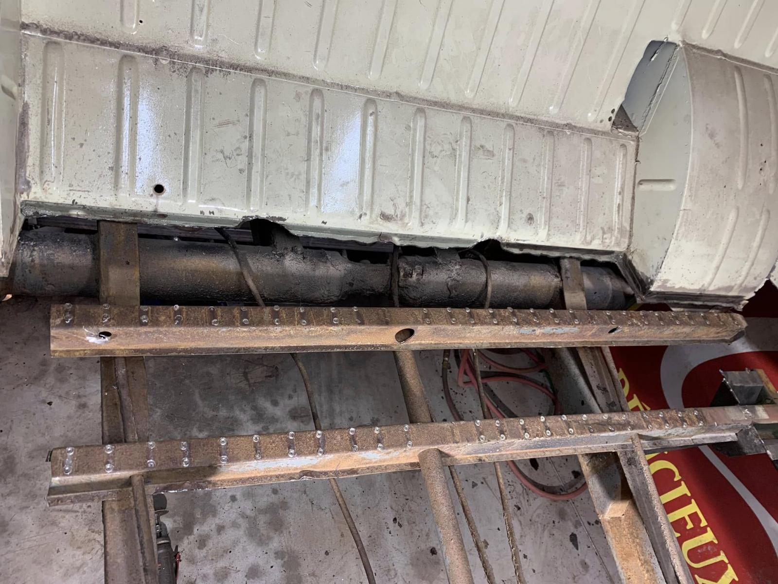

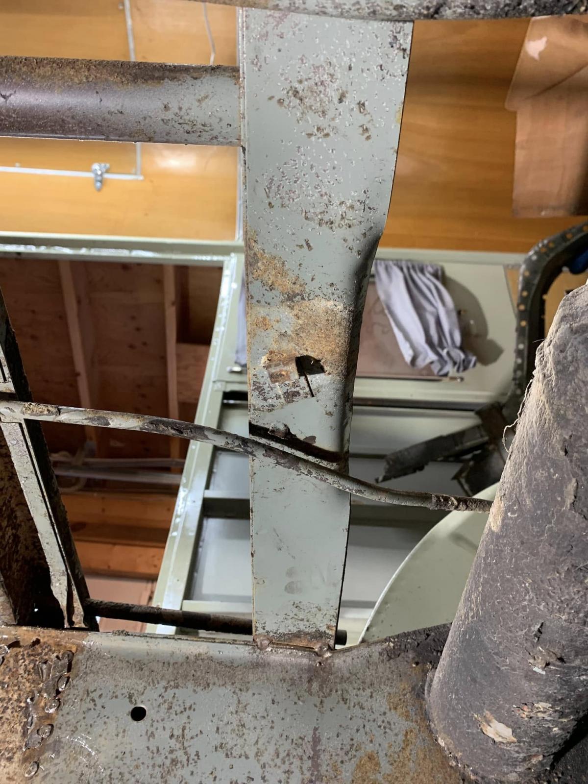

I continued by removing the rear cross member under the floor section:

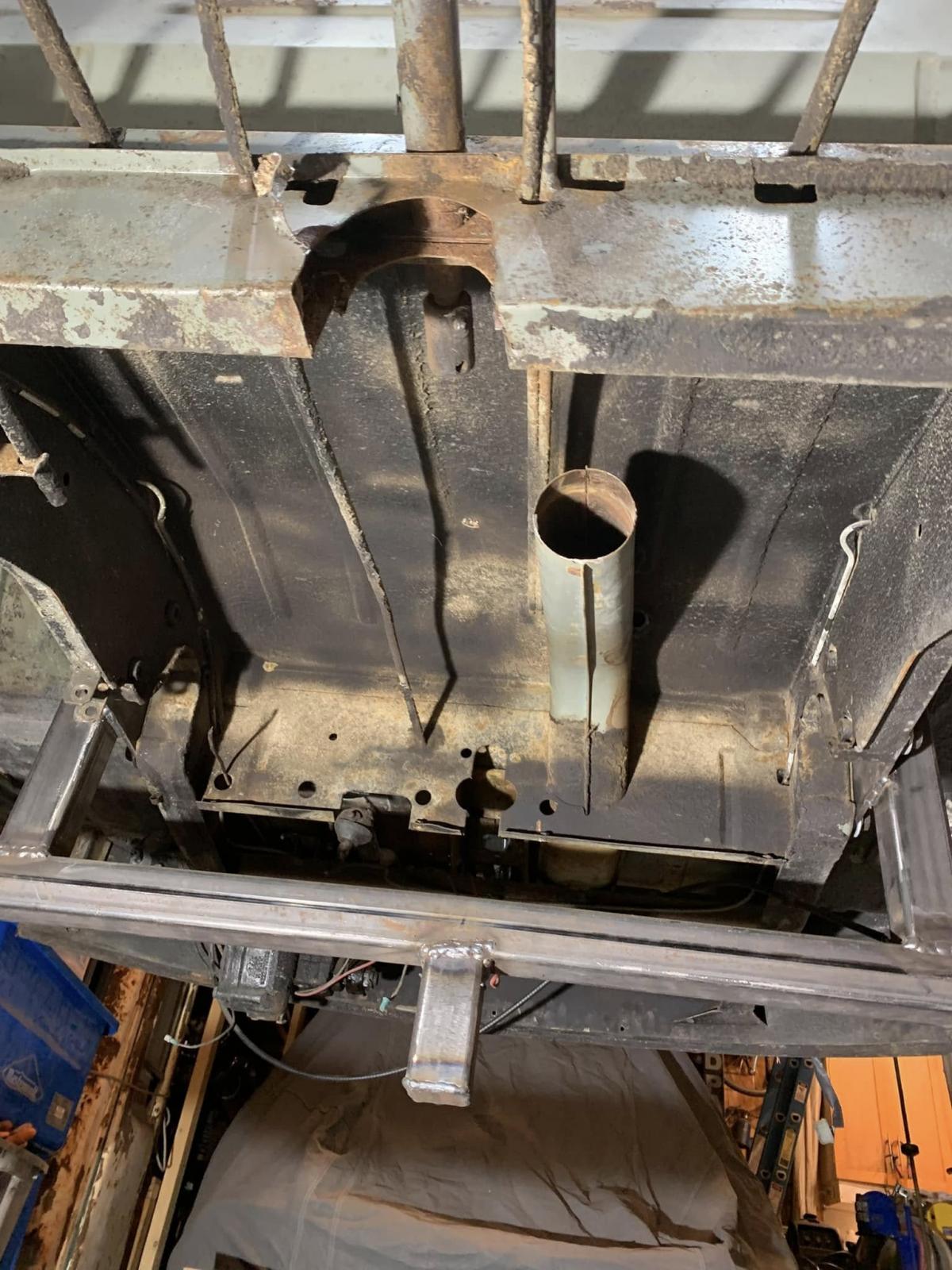

PostPosted: Wed Dec 25, 2024 8:15 am    Post subject: Re: 1960 SO23 Westy - Cabinet and Metal Restoration Reply with quote

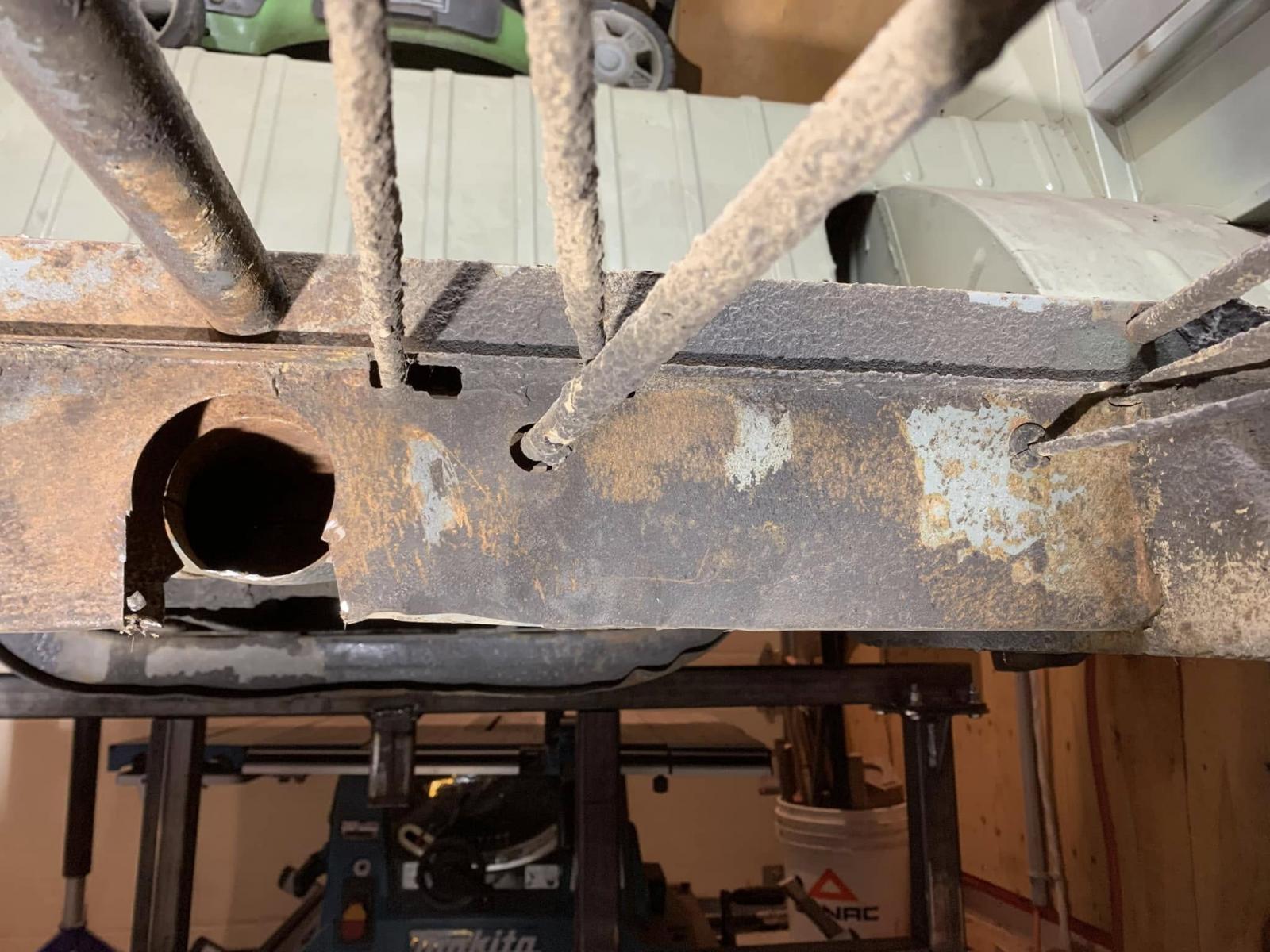

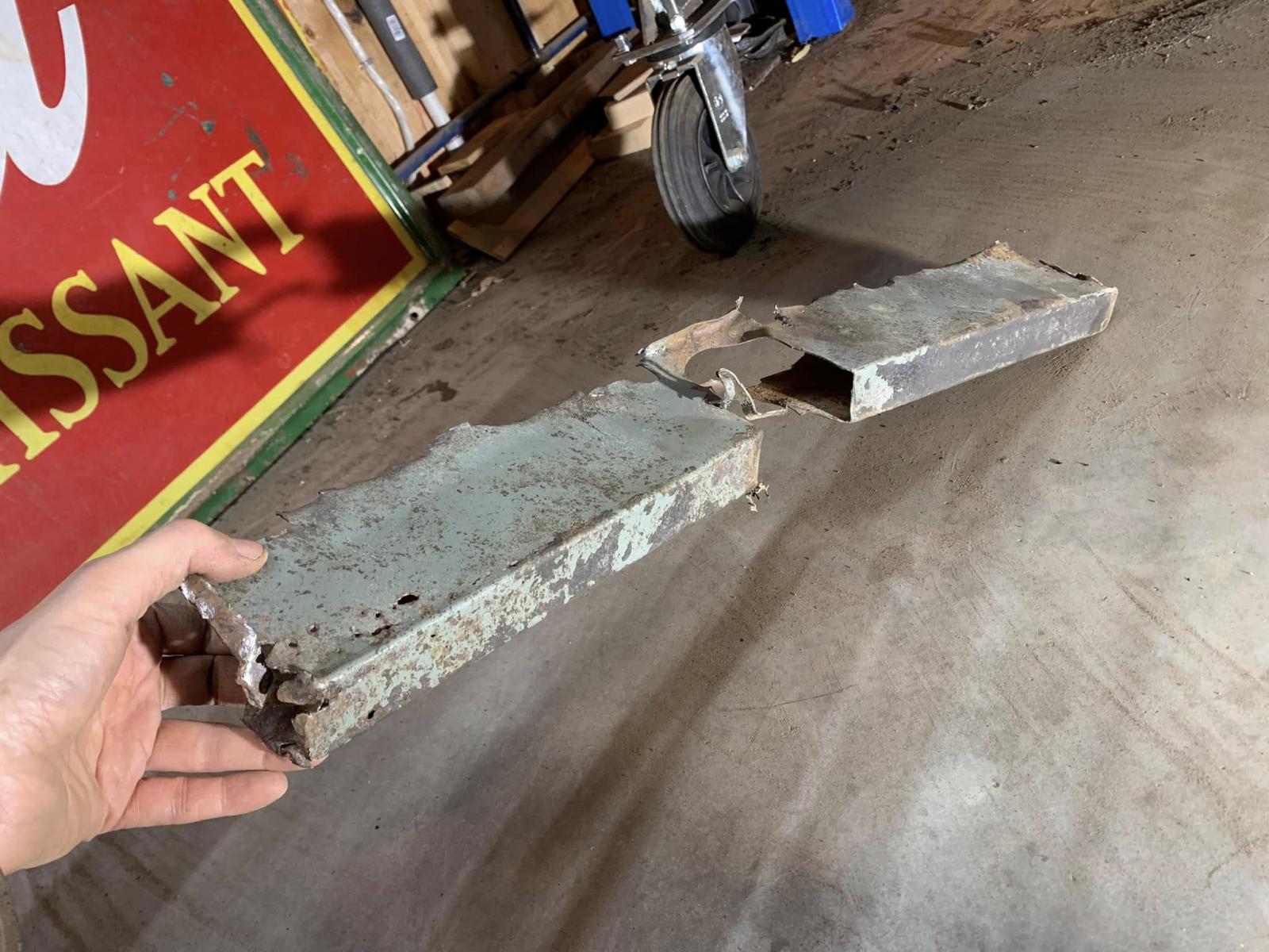

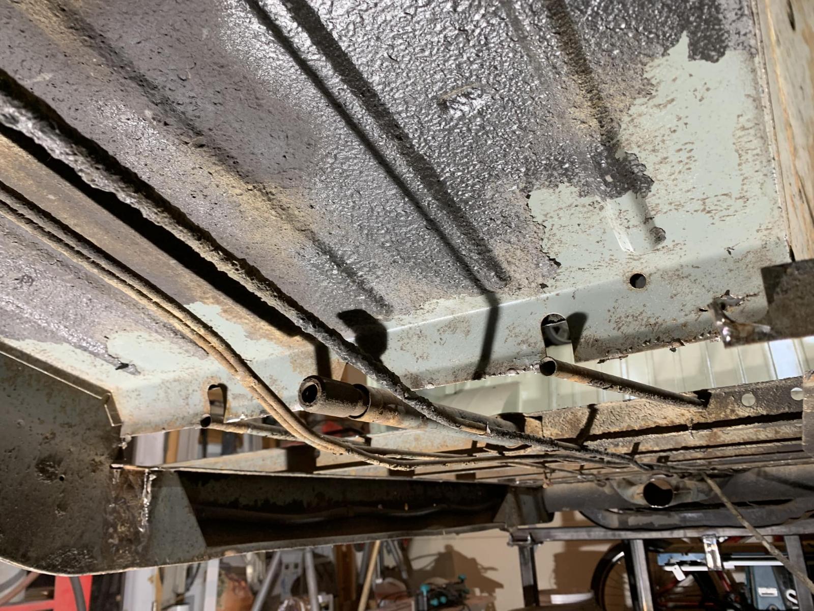

Now I am addressing the floor cross member section by removing the from section at the cab devider:
I was able to remove it in one signle piece so I can use it as reference when new parts will be installed:

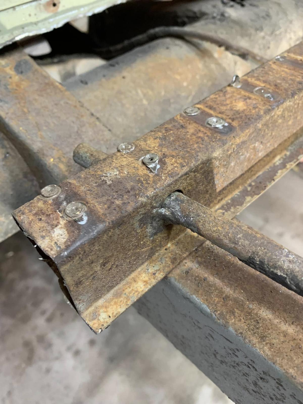

continuing with the rear cross member:
[/url]

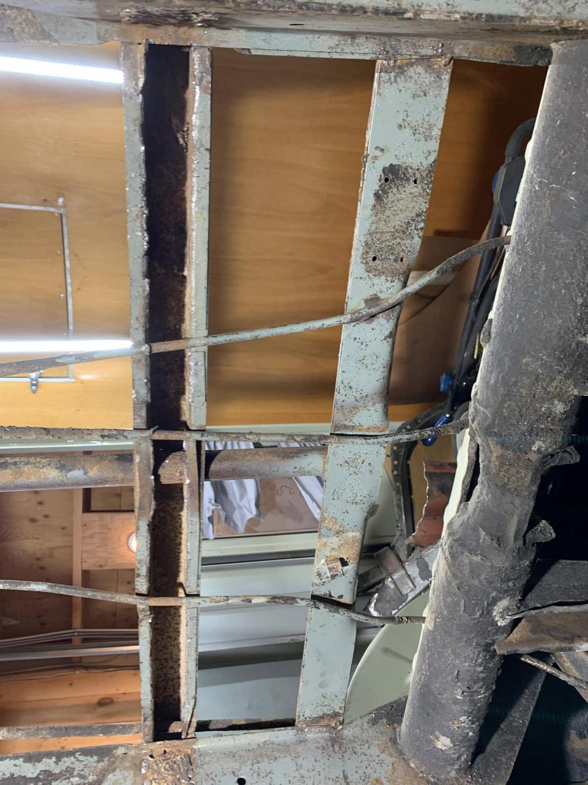

PostPosted: Wed Dec 25, 2024 8:05 am    Post subject: Re: 1960 SO23 Westy - Cabinet and Metal Restoration Reply with quote

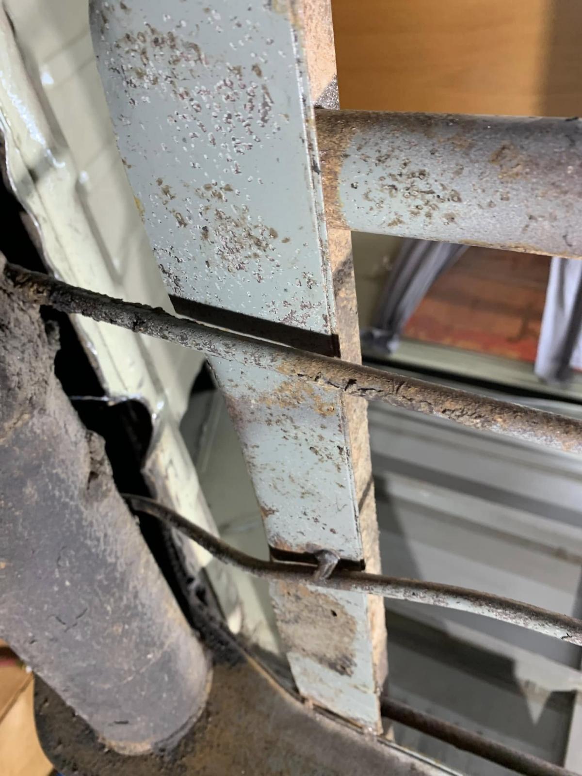

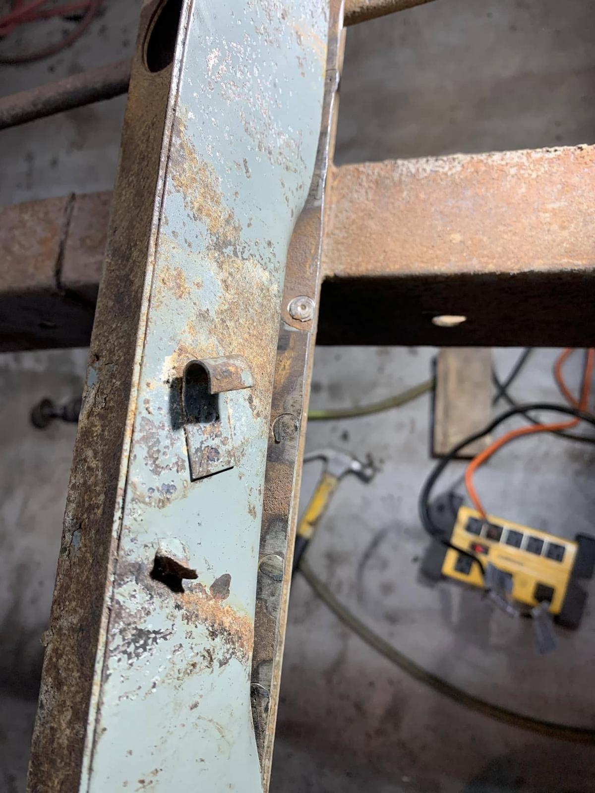

now removing the section under the cab driver area:
there is always some little findings in where you would not expect:

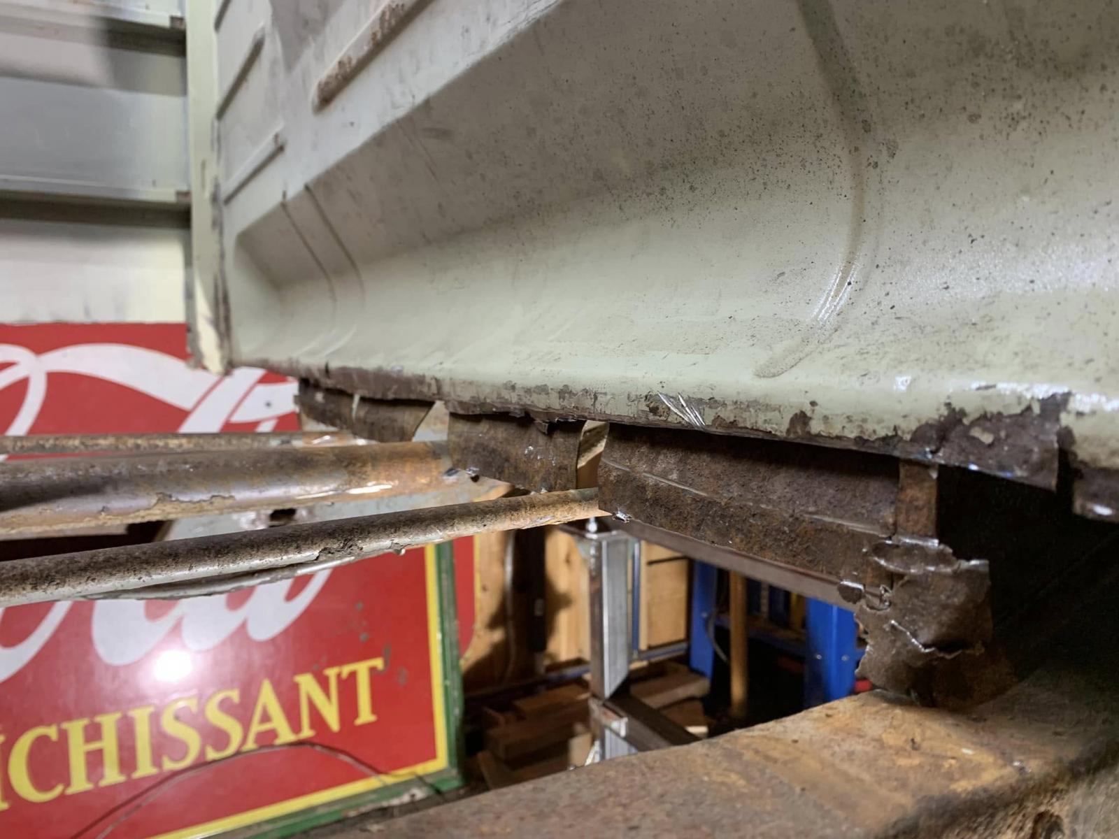

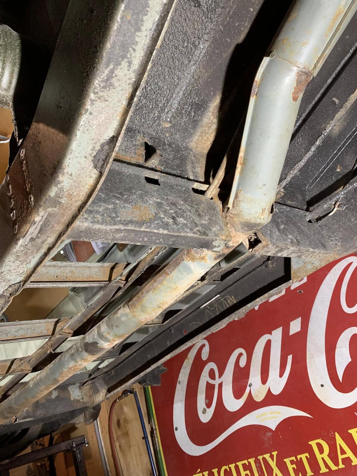

PostPosted: Wed Dec 25, 2024 7:59 am    Post subject: Re: 1960 SO23 Westy - Cabinet and Metal Restoration Reply with quote

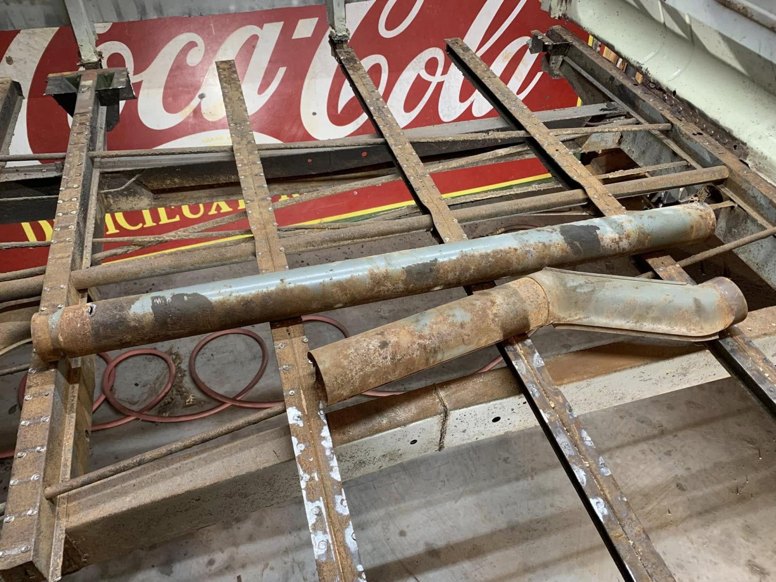

Here is the main tube an the collector that makes junction between the rear floor area and the driver cab.
After removal:

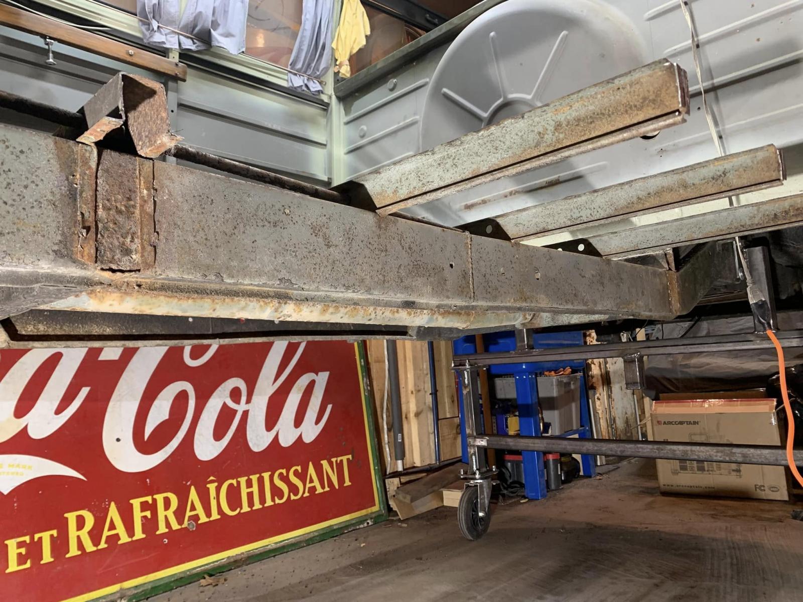

PostPosted: Wed Dec 25, 2024 7:52 am    Post subject: Re: 1960 SO23 Westy - Cabinet and Metal Restoration Reply with quote
Now that the restoration frame is built and I am able to go under bus I started to remove all of the cross members under and above the frame.
the goal being to remove them as carefully as possible so I can get access to all of the original details when installing new parts.
So here is the starting point:

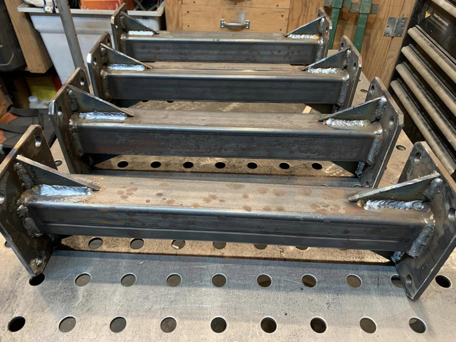

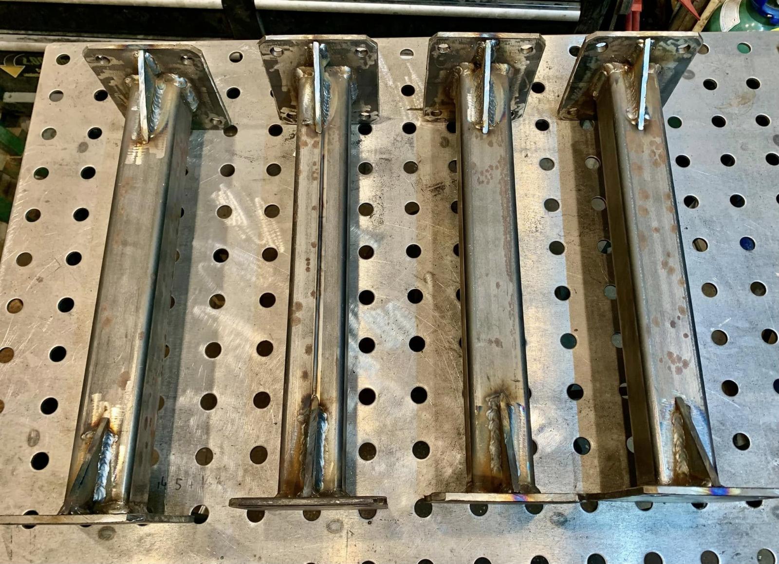

here is a quick update,
as I do not have enough space to build a rolling rotisserie I have decided to build additional legs raise the height of the bus bus almost 17 inches which gives me about 32 inches total to go undert the bus.
I used 2x2 square tube abd 1/4 metal plates.

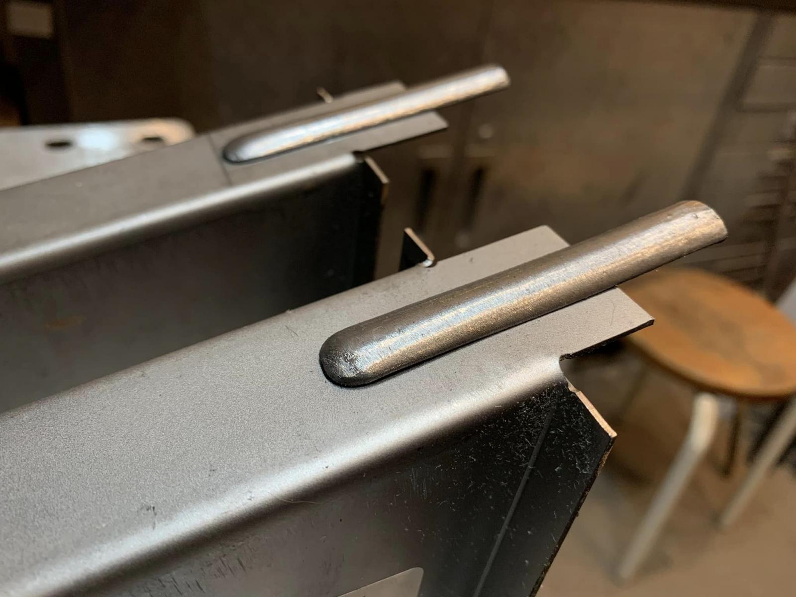

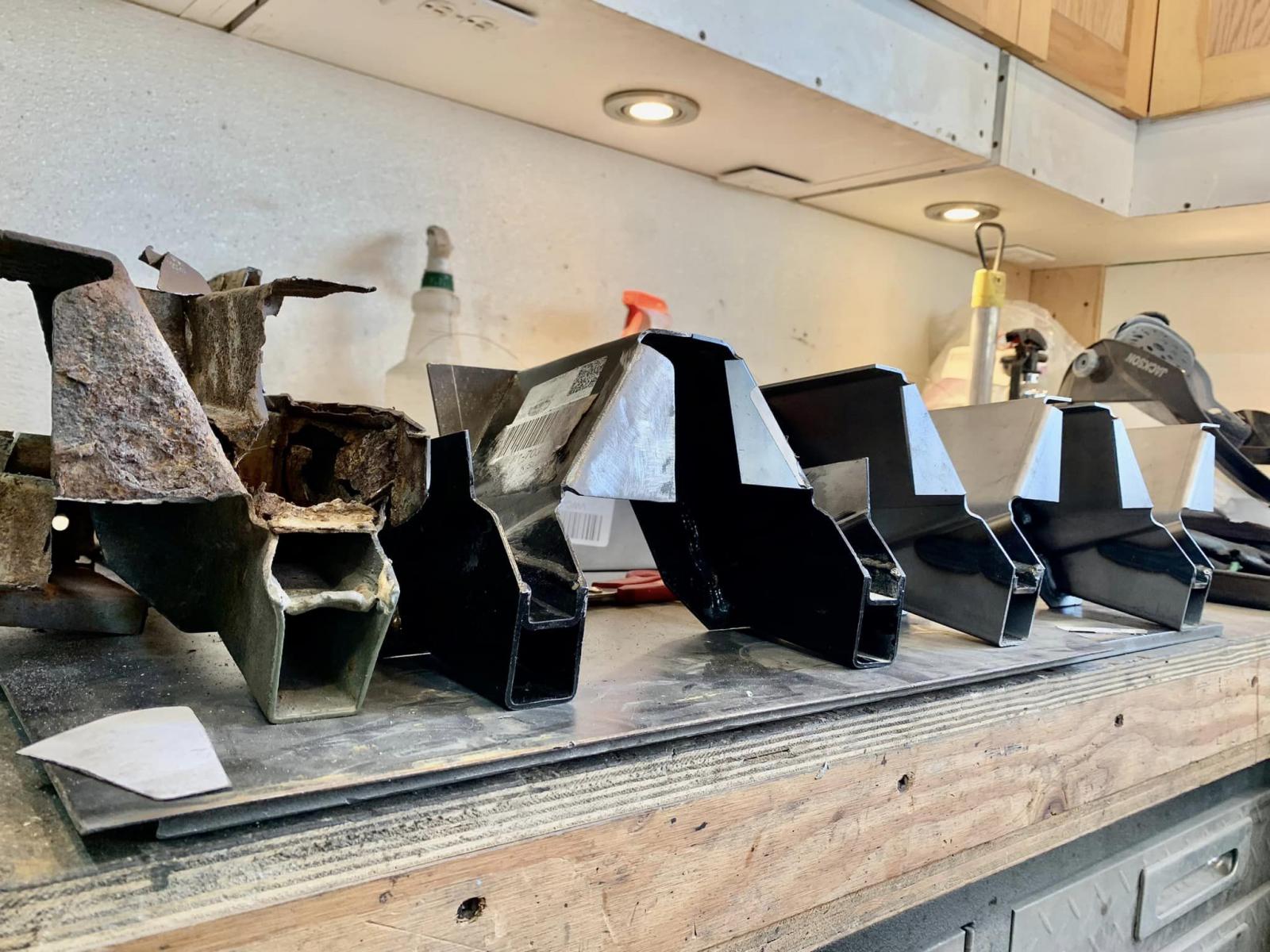

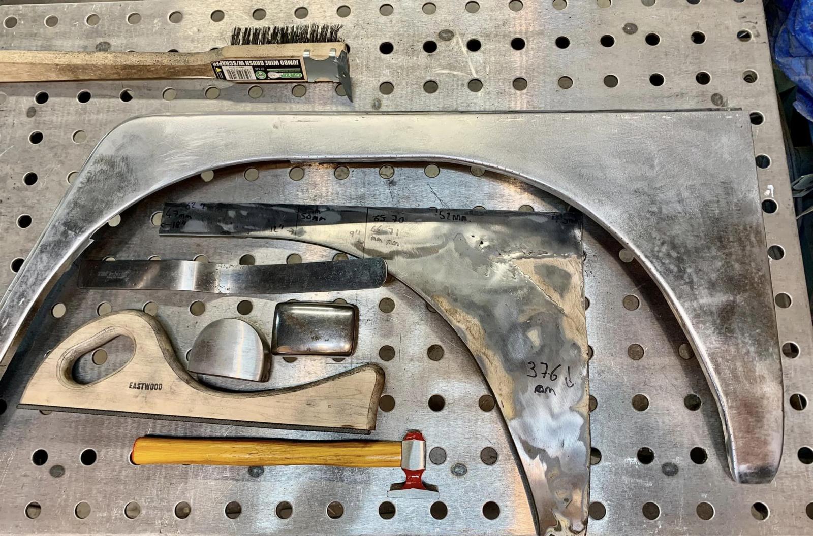

PostPosted: Sun Apr 07, 2024 2:28 pm    Post subject: Re: 1960 SO23 Westy - Cabinet and Metal Restoration Reply with quote

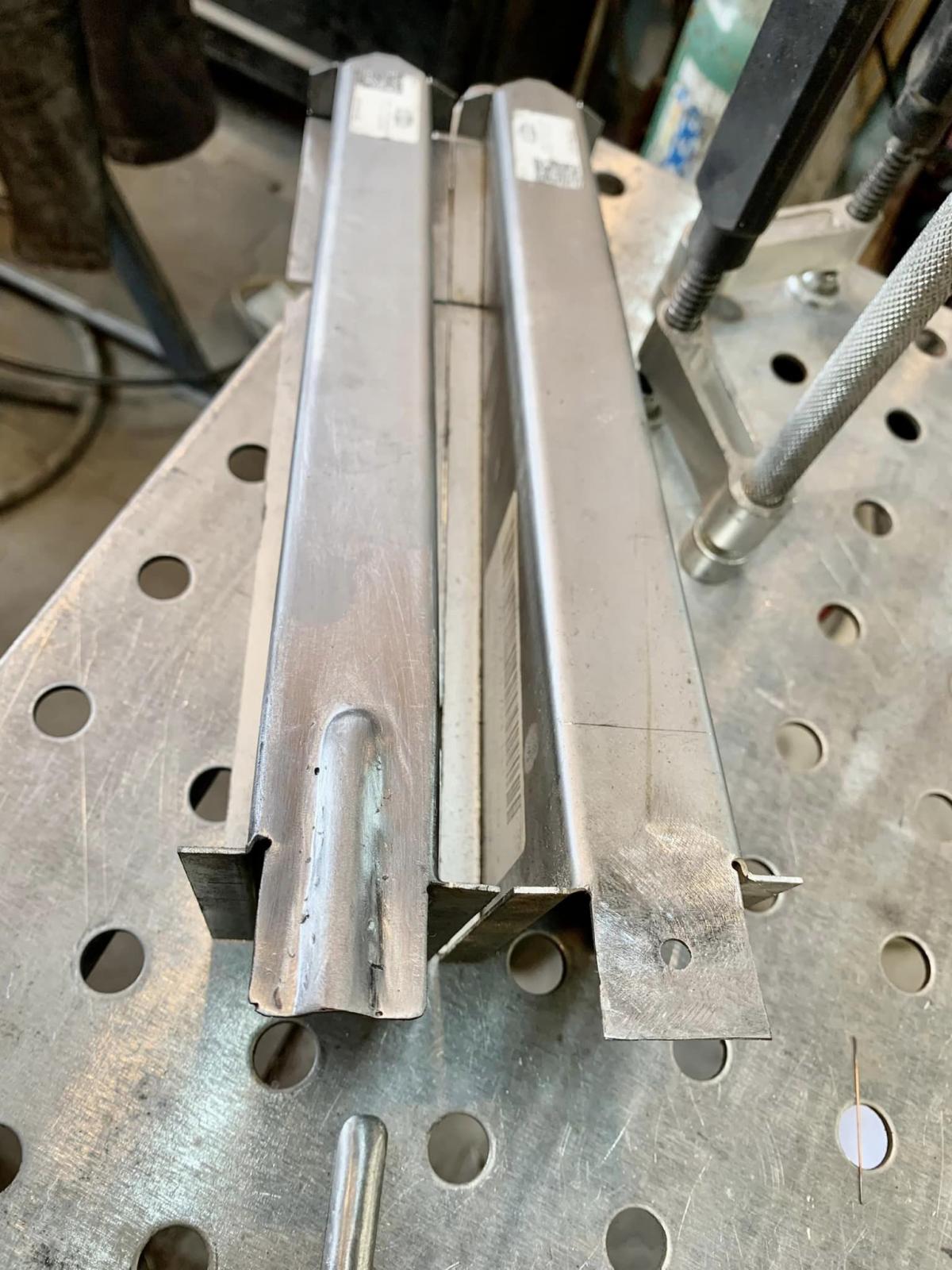

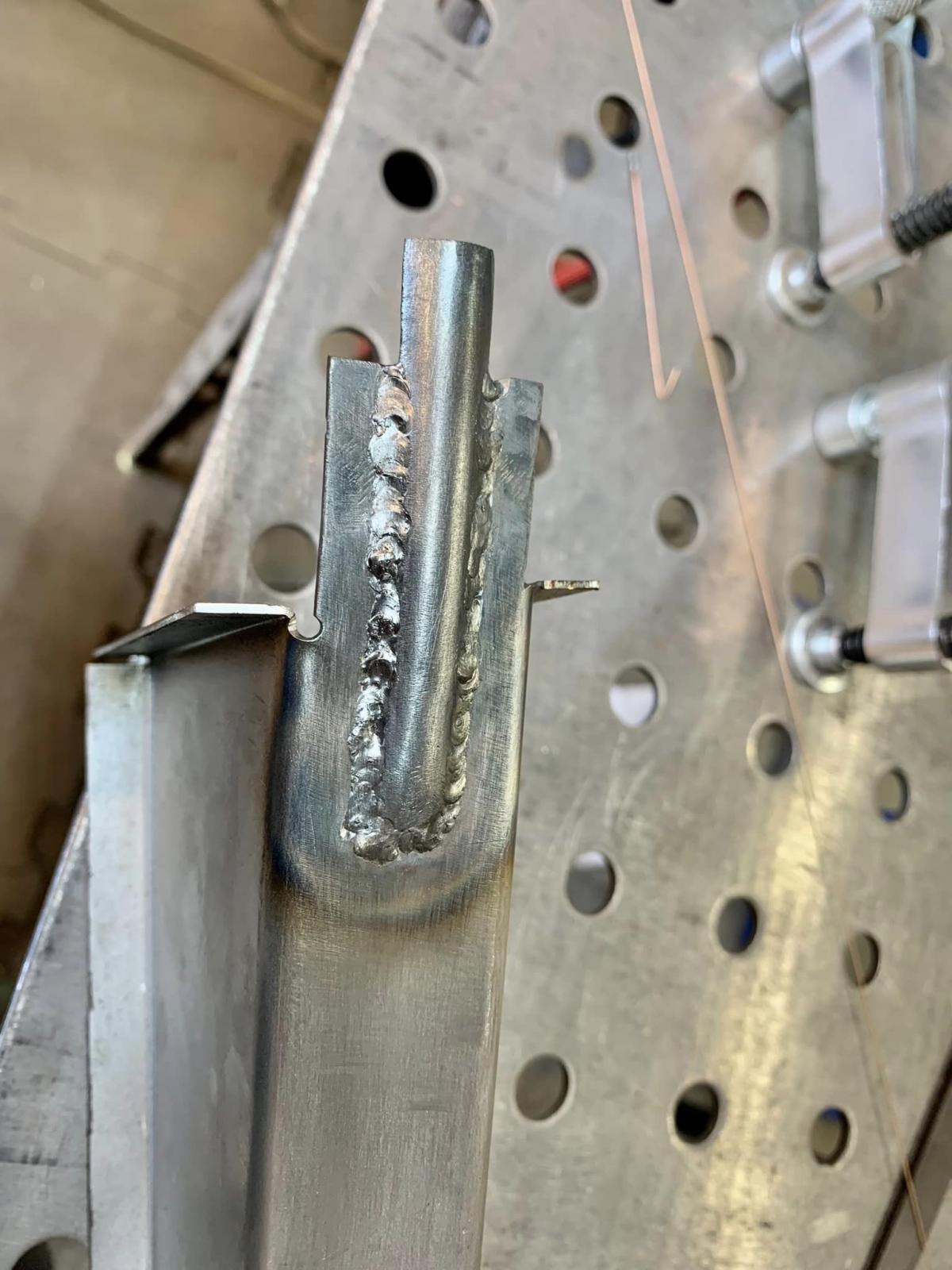

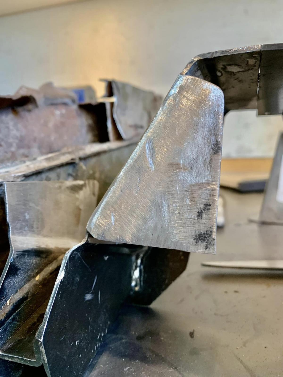

I also strated to address the flange on the jack point the weld on the C frame.
original:
Repro before:
Repro after, I used 2mm thick sheet metal that i welded back in place:
I have 5 more flange to go, front end right and rear left and right....

PostPosted: Sun Apr 07, 2024 2:24 pm    Post subject: Re: 1960 SO23 Westy - Cabinet and Metal Restoration Reply with quote
Here is the latest updates:
I an currently working on modifying the Autocraft repro part for the outrigger and jack too look like the original.
On the rear outriggers I added to embossing at the bottom of the piece like original
when done. looks much closer to factory details:

PostPosted: Fri Mar 08, 2024 7:34 pm    Post subject: Re: 1960 SO23 Westy - Cabinet and Metal Restoration Reply with quote
here are all of the section of the dogleg I fabricated and welded

PostPosted: Fri Mar 08, 2024 7:32 pm    Post subject: Re: 1960 SO23 Westy - Cabinet and Metal Restoration Reply with quote
here the last repair on the dogleg:

PostPosted: Sat Mar 02, 2024 3:16 pm    Post subject: Re: 1960 SO23 Westy - Cabinet and Metal Restoration Reply with quote
the section is now welded and finalized:

PostPosted: Sat Mar 02, 2024 9:33 am    Post subject: Re: 1960 SO23 Westy - Cabinet and Metal Restoration Reply with quote
Braukuche wrote:
Curious why you didn’t just buy a new repro dogleg?
This way I know the fit will be spot on repairing the OG part and I won't spend hundred of dollars to buy repro parts that will need an amount of rework in any cases.
