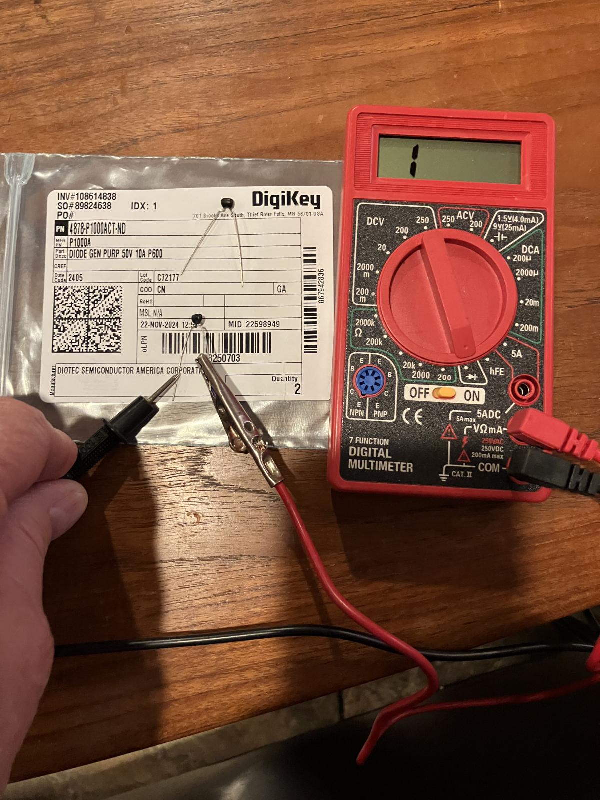

Busfixer
Joined: March 13, 2016
Posts: 56
Location: Midland, Texas
Busfixer is offline
PostPosted: Tue Dec 03, 2024 7:48 pm    Post subject: Re: dead van diagnostic tools, wiring bypass Reply with quote
Thanks Dan, jlr and TJet - I believe Dan is right and these electrical components are capacitors. Dan, when I put them in series as described previously, they would show 6V, 3V, 1V then 0V, allin about 1-1/2 seconds. 0V steady after that. So your recognition of them being a capacitor combined with the quick voltage falloff to0V sounds like you are correct. I will call DigiKey tomorrow. JLR, attached below is a pic of my fine Harbor Freight multimeter in the Diode test position and it reads “1”. Apparently this means no flow. Confirms capacitor idea. Thanks for teaching me that function. TJet, if I don’t get satisfaction from DigiKey, then I may go your route. Thanks for the links.
Thanks again to all - I love the Samba! Busfixer

jlrftype7
Joined: July 24, 2018
Posts: 4765
Location: Chicago
jlrftype7 is offline
PostPosted: Tue Dec 03, 2024 3:46 pm    Post subject: Re: dead van diagnostic tools, wiring bypass Reply with quote
Busfixer wrote:
Help! I almost have the wiring bypass built but ran into a snag. When testing the diodes pictured below (50V, 10A), I cannot get voltage to flow through either diode regardless of orientation. 12.8V flows through my test leads hooked in series to my volt/ohm meter, but it quickly drops to 0V when I insert either diode in series. Am I doing something wrong or are these diodes bad? I must admit that I am a rank amateur in the electrical category.
Puzzled, Busfixer
Does your Meter have a Diode testing position on its dial? Not all do, but, so many do that I need to ask.
It will look like an Arrow, with a line drawn across the arrow.
Here's a Fluke Meter as an example, the Diode test is one to the right of the Middle/Top OHM symbol, like 1 o'clock on the dial.
S:Paid:MS:CSM-2295:YF1CA5:20501201:APZ_1&gclid=7c2e0a20f8cb1aa6c3716d6f729eac6" target="_blank">https://www.grainger.com/product/4EB18?gucid=N:NRazz...d6f729eac6

DanHoug
Joined: December 05, 2016
Posts: 5914
Location: Bemidji, MN
DanHoug is offline
PostPosted: Tue Dec 03, 2024 3:43 pm    Post subject: Re: dead van diagnostic tools, wiring bypass Reply with quote
Digikey RARELY makes a mistake but those are NOT diodes!!! those are capacitors. here's what that part number should look like:
-dan
www.thefixitworkshop.com
Busfixer
Posts: 56
Busfixer is offline
PostPosted: Tue Dec 03, 2024 3:38 pm    Post subject: Re: dead van diagnostic tools, wiring bypass Reply with quote
Puzzled, Busfixer
