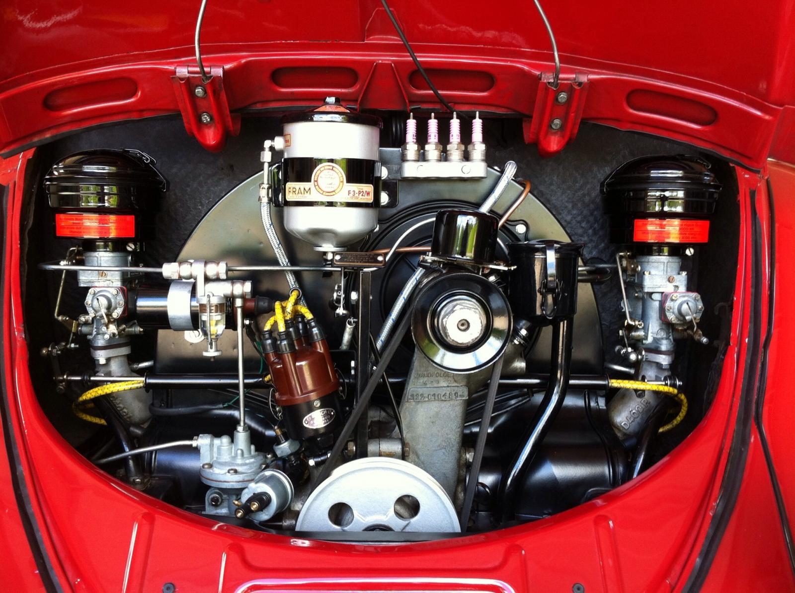

Motor is still running strong so no real updates, besides I’ve added a Mann fuel filter inline with the fuel pump.

Guess not, next plan is a set of 80mm cylinders.......

About what jets to use, i cant remember which ones I started out with, I´ve done alot of upgrades to my motor over the years and now I´m running 32 Solex´s.
But one thing I always has is having the final adjustment done on a dyno.
http://vw-bluehats.blogspot.com/

Hi Jerome very nice set you have there.
My arms for the linkage aren't original, I made my own with baljoints at both ends of a adjustable arm.

PostPosted: Sun Jul 12, 2015 10:52 am    Post subject: Reply with quote
I understand your text - you put the bottom carburetor connection in the center instead of it being offset. Cool.
Yes, I would be hesitant to cut 2 original strap air cleaners too. Smile
But now there are 2 original filters less out there, making the remaining ones more rare Wink

What did you change in the air cleaners?
If you take a look at the bottom of the filter you can the flange that goes over the carb is of center, that of course to move the filter back towards the fan shroud on the stock motor otherwise it would hit the decklid.
But not having that problem I moved the carb flange so it is centered with the inside pipe, and almost works as a stack now. I can take some pics if that explains it better?
Can't tell if it's the filter or carbs, but I have less carb "noise" now than I used too.
Btw it wasn't the best day cutting up 2 original filters Confused But the end result was good!

Again this year I made some updates.
I changed the carbs to 32pci and modified the original 54-55 strap over filters so they aren't as restrictive.
It now makes 61hp and I'm quite happy Laughing
