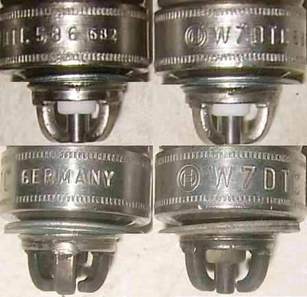

First of all platinum plugs were originally designed for airplanes because for some reason unknown to me airplane plugs corrode faster. Platinum plugs usually last 50,000 miles while copper plugs last only 10,000miles.
But,
If your are looking for efficency and performance then the question is which of the two metals conduct electrictiy better.
The answer is copper.
Copper=better mpg=more hp
Second of all why in the world would anyone want to pay extra money for the extra electrodes. Electricity is lazy and will take the shortest path. Always. So whichever electrode has the shortest path is the one and only one that the spark will go to. Meaning that it dont matter how many electrodes you have only one will be used and the rest of them are there just for looks.
Third
Please forgive me I don't know the proper terms here
But
just compare a bosch platinum to any other average spark plug
the peice of metal that sticks out of the white ceramic part.
Notice how on most spart plugs it actually sticks out
But on the bosch platinums it doesn't
I'm no expert now but way I see it with less metal being there then the quicker it can corrode and loose effiecency.
So with all that in mine I will NEVER volontarily so long as there is another option use a bosch platinum plug again. I know bosch makes good products but this one here is one big scam.
Champions are great as well as NGK's are great.
I would get eithor or but whichever you get go with copper.
