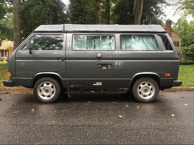

Stance before and after the spacers. Just enough lift to make a difference.
Before
After.

PostPosted: Sun Jan 26, 2020 4:53 pm    Post subject: Re: 7 Steps to a happier back end - Vanagon sag. Reply with quote
Got my spacers installed, 15/16" total for the three 5/16" pieces that boosted that corner by a significant amount while simultaneously adjusting the other corners as well, giving an overall improved stance that is slightly higher at the rear. No pix of the spacers installed but there are plenty of those in this thread and mine can't be seen from the side in any case. I have enough material left for a couple more and might add one on the right side to even things up, but I'm very happy with this change.
Before
LF=16 5/8" RF=16 7/8"
LR=15 1/2" RR=16 1/2"
After
LF=16 3/8" RF=16 1/2" Actually lowered the front a little and did so evenly.
LR=17" RR=16 3/4" Raising the left side also raised the right a bit.

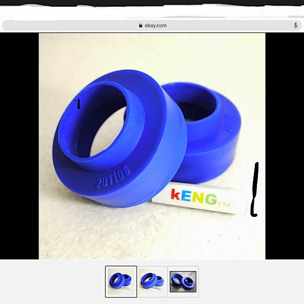

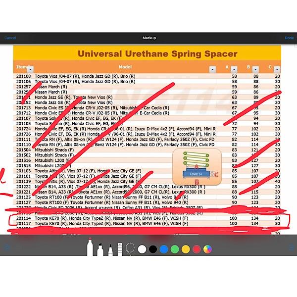

Hi, I am getting ready to do a Bilstein B6 HD for 16” shock install on my Syncro Adventurewagen (Weekender set up. No cabinets or roof bed instead a hammock up top!) Aka
Syncrohammer!
I was gonna go GoWesty 2” lift springs but read several people who found that to be not a good pairing? And After reading this thread on to lift or not to lift ?
https://www.thesamba.com/vw/forum/viewtopic.php?t=538751
I have decided to go the spacer route. As many people chimed in and would not go through the effort of lifting it over again!
Currently in the mid to low 17” range front and mid to low 18” in the back.
Want to bring it up to 19.5” stock early Syncro hardtop range or possibly a mild lift beyond that. Considering the limit of potential lift with washer or cutting board spacers (risk of spring shifting position) and the expense of custom made spacers that retain spring position (often times costing the same as buying lift springs!) I did a lot of research and found what appears to be a good reasonably priced solution!
These have an internal neck that retains the springs position and come in 20mm and 30mm shim height.
Roughly 5.2 inch diameter
Roughly 3.9 inch internal neck
See the attached chart below. Wondering what other people think of this idea?
And if there is any reason it is not a good solution?
Or would not work?
