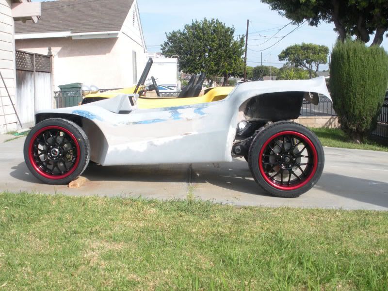

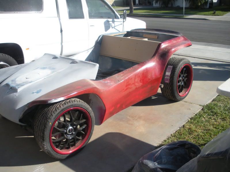

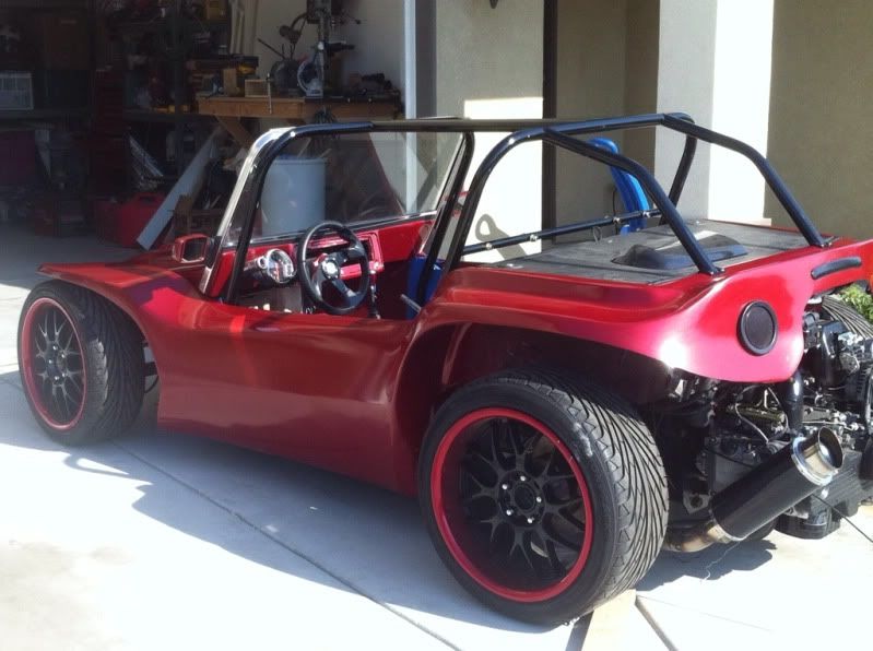

PostPosted: Fri Jun 08, 2012 8:58 am    Post subject: Reply with quote

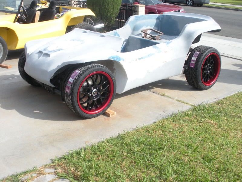

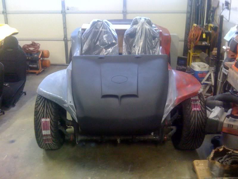

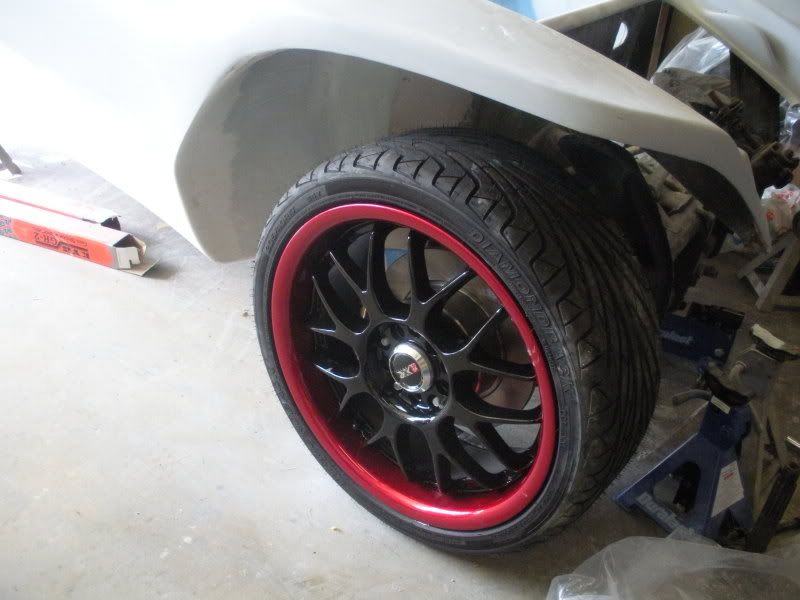

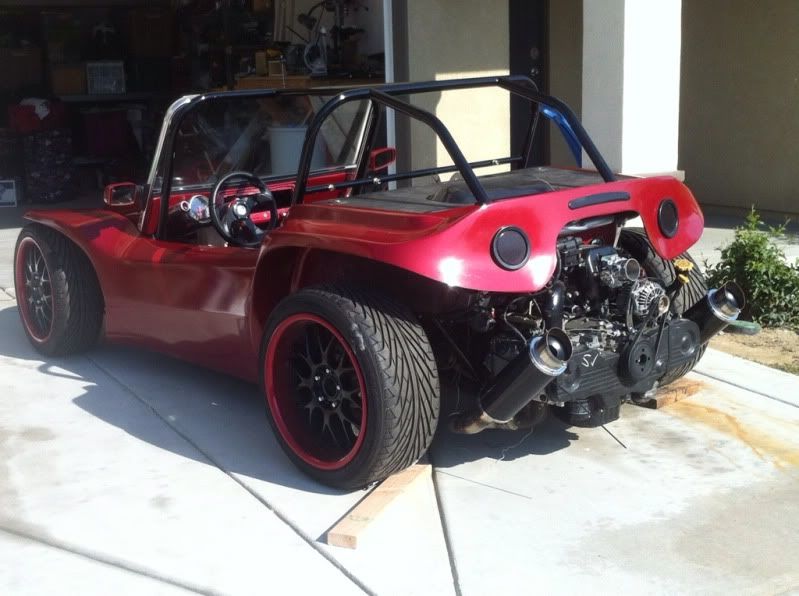

Rear tires are 245/40/r18's. Also a 9.5" wide wheel. If I was buying tires again I would go with a little bit bigger side wall to fill the space better but also to provide a more cushioned ride.

PostPosted: Thu Jun 07, 2012 5:16 pm    Post subject: Reply with quote
When you get a chance could you look for me. I am haveing a hard time trying to find the right tires. Work has been killing me no time to work on my buggy but I did find another set of wheels I might get.

PostPosted: Thu Jun 07, 2012 1:18 pm    Post subject: Reply with quote
Not sure of the tires sizes off the top of my head. 18" wheel in back. Just put some 2" wheel spacers on back. Very happy with the look of them. Can wait too see your spoiler come together hotair.

PostPosted: Thu Jun 07, 2012 12:54 pm    Post subject: Reply with quote
What type of tires do have and the sizes of them. It looks like 205- -17 front ? ans back. Buggy is looking great.

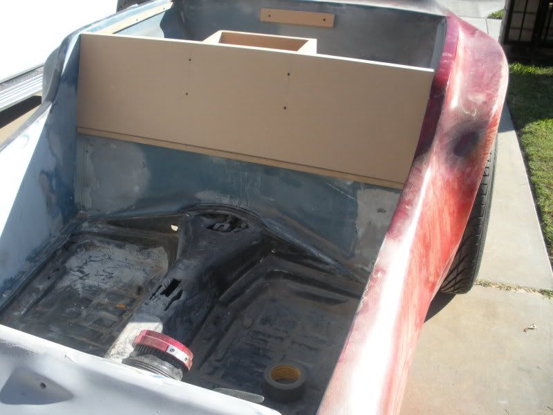

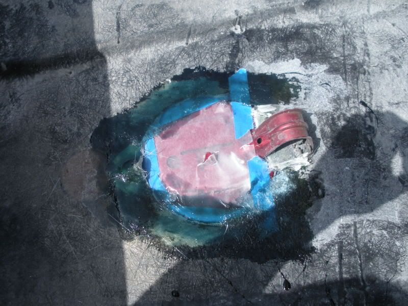

PostPosted: Thu Jun 07, 2012 10:10 am    Post subject: Reply with quote

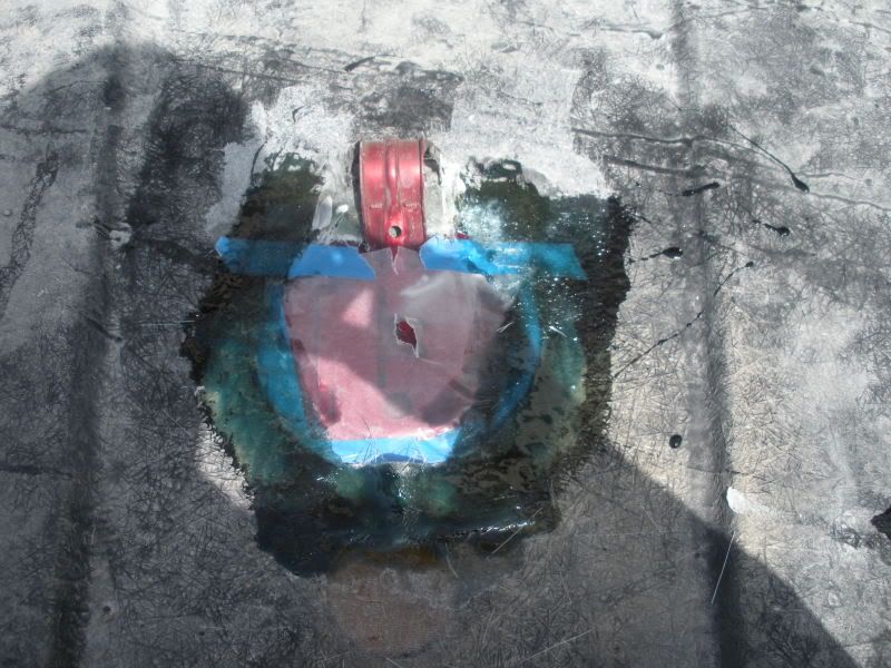

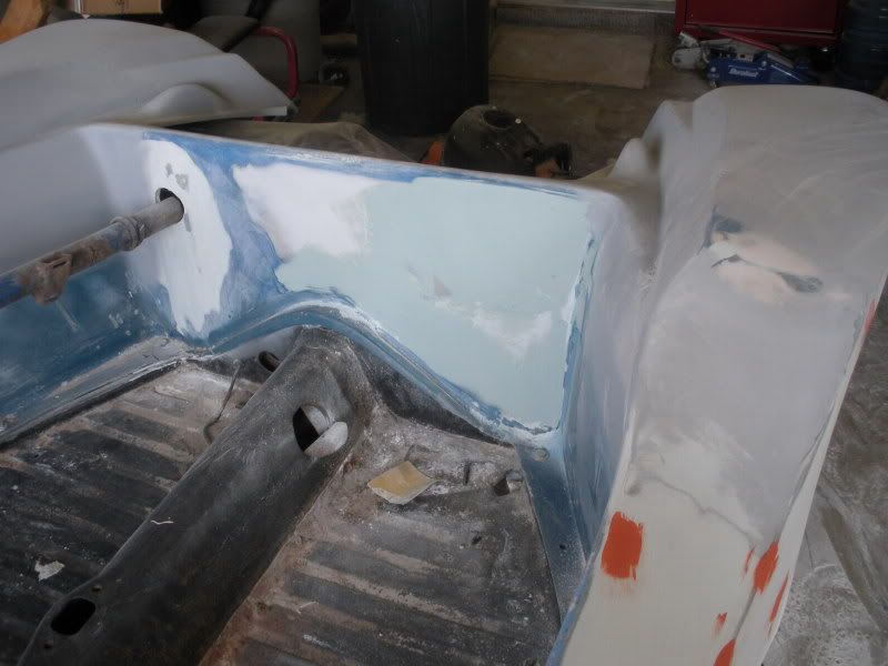

I had to further modify the gas tank because it was hitting one of the steering u joints. This time I welded it myself and had a couple of areas that I popped through. I am planning on cover the outside with some jb weld or seal all and I have some red kote tank liner in transit. Once I get everything in place there I will be able to gas it up and turn her over. I'm excited for that day and I will definately be putting up a video of it running. I hope it isn't to loud with the silencers cause I love the look.

PostPosted: Mon Jun 04, 2012 1:22 pm    Post subject: Reply with quote

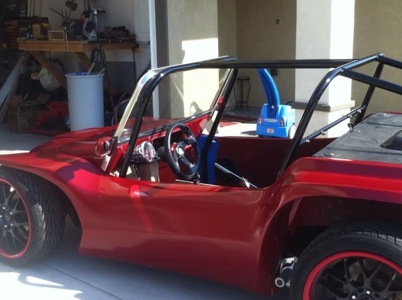

Favorite picture yet

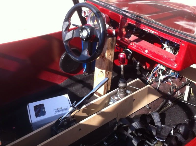

PostPosted: Mon Jun 04, 2012 1:19 pm    Post subject: Reply with quote

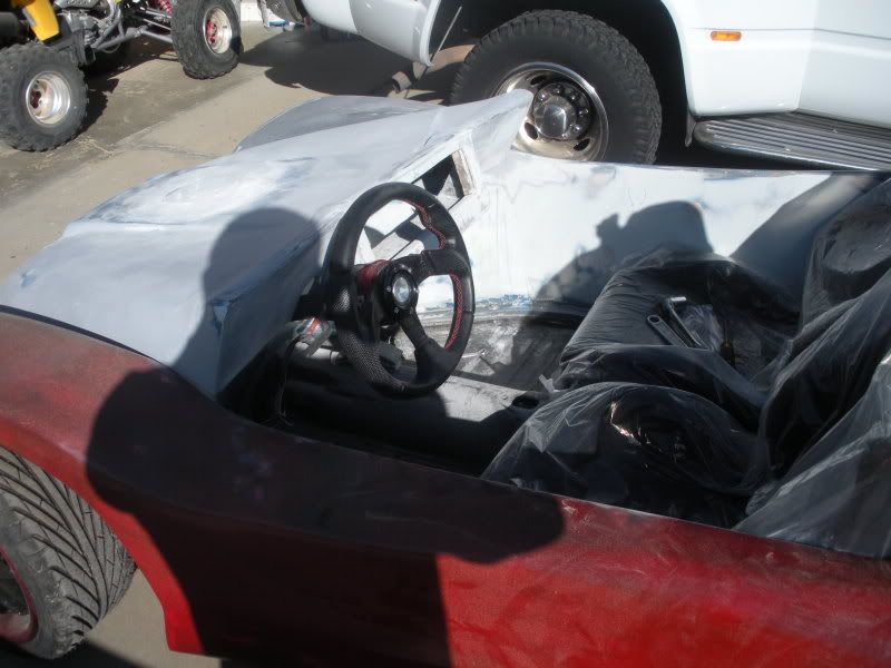

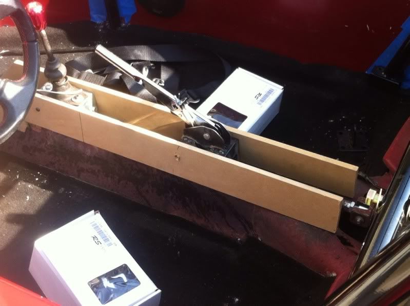

Cleaned it up and started to work on the center console.
Will cover in vinyl and add a top piece covered in carbon fiber

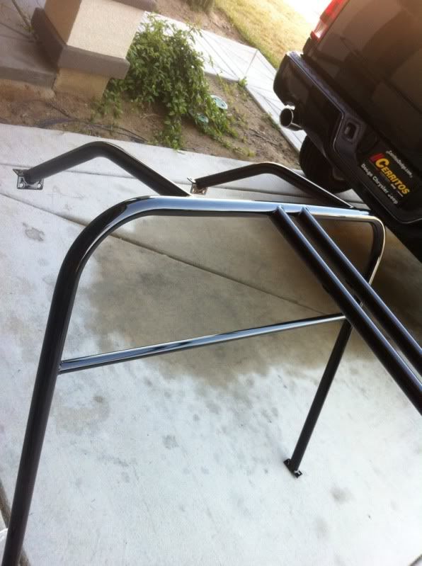

Got the cage back from the powder coater. Amazed at the quality that powder coating produces. Mirror like shine. Really happy and at only $100 I think I got a great deal.

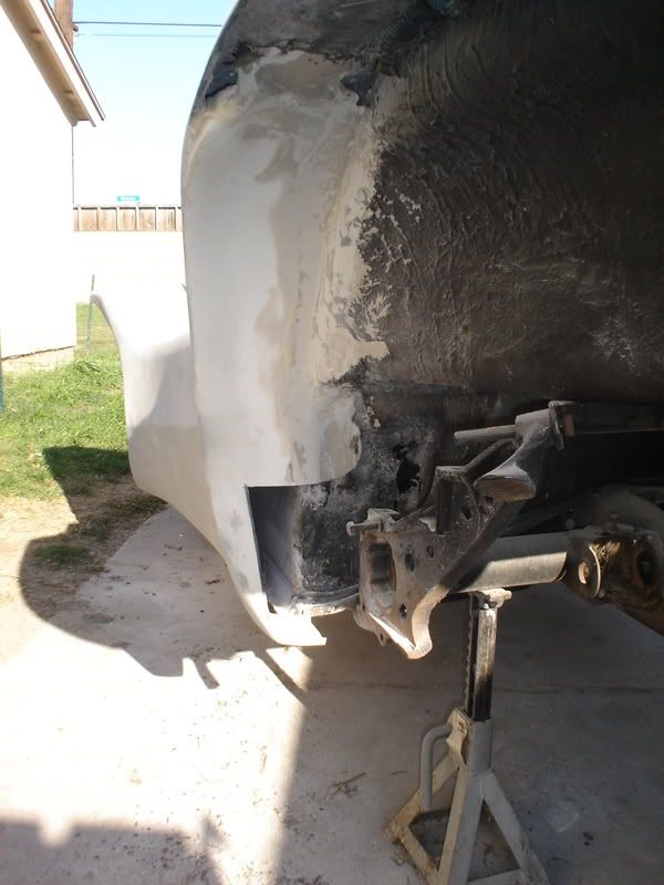

Yeah. E guy that is going to help me clearance the tank did it already. It was at his house for about 2 months. He went on vacation and forgot he had it.

streetbuggy8804 wrote:
I knewt was going to be a problem but I was hoping that I could use a piece of square tube to lift the tank a little. The problem is that it is slightly more than a little. I will be headed to an old timers shop this weekend to modify the tank. Really want to get that fuel tank done and in place.
Have you had the return fitting installed yet?

PostPosted: Wed May 02, 2012 12:38 pm    Post subject: Reply with quote

PostPosted: Wed May 02, 2012 11:48 am    Post subject: Reply with quote
I was wondering about clearance when I saw the pic of the rack ontop the frame head.
Looks like you have figured out the resolution though.

The only problem with sack and pinion so far
