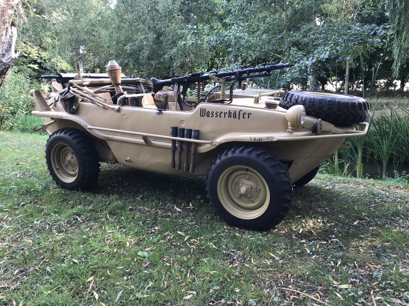

PostPosted: Wed Aug 17, 2022 6:22 pm    Post subject: Re: Kubel and Schwimmwagen destroyed in fire in Amsterdam Reply with quote
congratulations!! that is an amazing transformation.

banana split
Joined: January 22, 2002
Posts: 1134
banana split is offline
PostPosted: Wed Aug 17, 2022 11:12 am    Post subject: Re: Kubel and Schwimmwagen destroyed in fire in Amsterdam Reply with quote
Wow !!!! Applause Applause Applause Applause

PostPosted: Wed Aug 17, 2022 7:47 am    Post subject: Re: Kubel and Schwimmwagen destroyed in fire in Amsterdam Reply with quote
Unreal work! Congratulations! The world of VW history has benefited from your talents and perseverance.

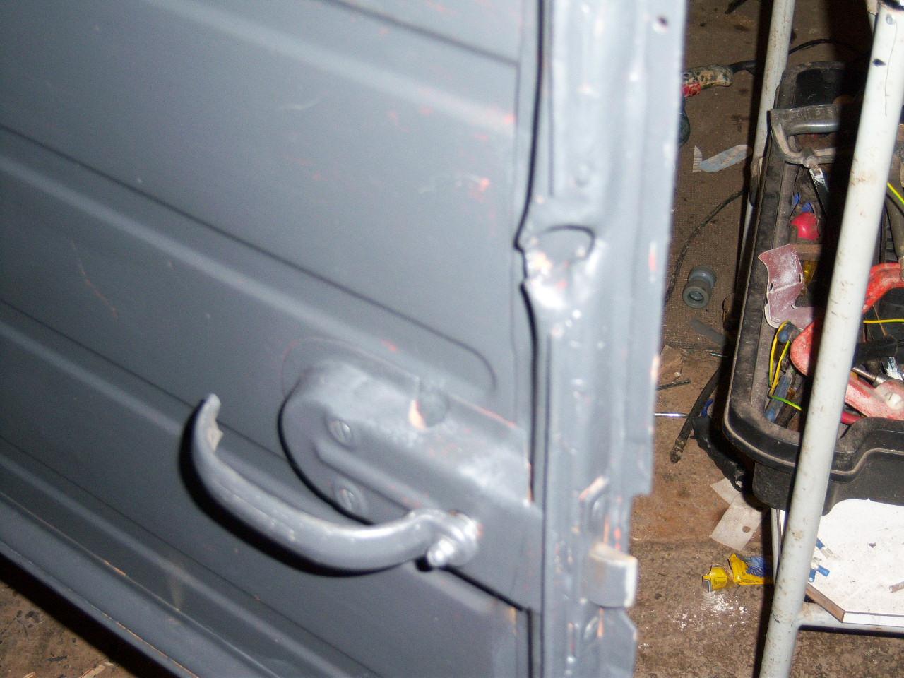

10+ years ago, a friend purchased a 41 Kubel, which we collected in bits & pieces from the seller. The rear door always interested me, as although very solid & original, it had some very strange damage, which I have always assumed was caused by a bullet. Shame the camera focused on the distance and not the door, but it clearly shows the damage.

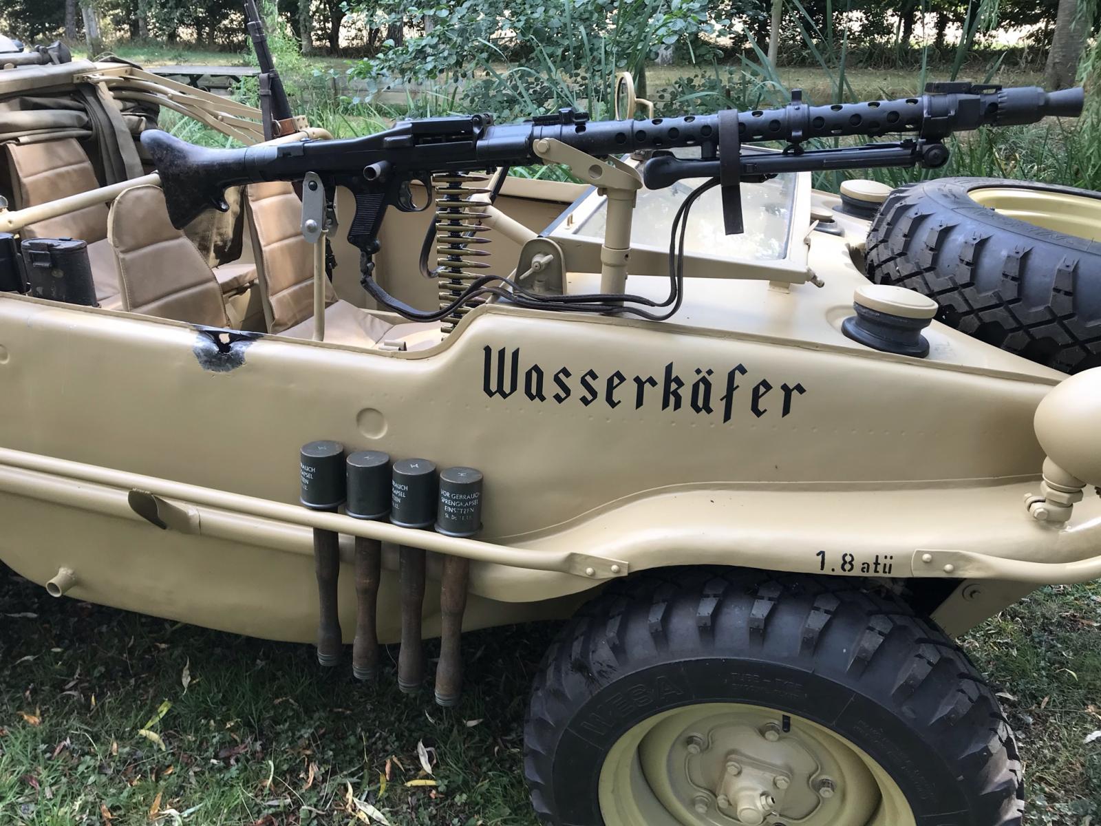

Mr Slug wrote:
. . . . The now familiar, and increasingly frequent bullet strikes.
Be curious to get measurements, but as a collector of soviet weapons that looks like a 7.62x54r. Which is the round used for the Mosin nagant rifles as well as machine guns like the DPS.
Check if the bullet has a steel core with a magnet and measure it’s outside diameter. Bores of these rifles are between .311-.313
A vehicle like this would have easily been a target of a sniper or a squad. If you see numerous strikes in the same area it’s most likely a victim to a DPS, or if you see only one bullet hole it might have been a sniper. It wasn’t uncommon for soviet snipers to use aircraft 7.62x54r to target things due to their accuracy and armor piercing being superior.
I find the battle damage to be fascinating as it gives insight to the history of this vehicle. If it only it could tell it’s tale. The eastern front was brutal.

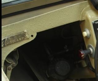

This VW166 is serial number 7-000649, built 31 December 1942 and is one of the last with an Ambi-Budd built body so the Ambi-Budd plate is original after all (last Ambi-Budd body is Nr. 705; body number is not necessarily the same as serial number though in this case it appears to be):
And this is how originally VW added the serial number to the Ambi-Budd bodies, later VW built bodies had the number stamped on a separate triangular piece of sheet metal spot welded to the body in the same location:

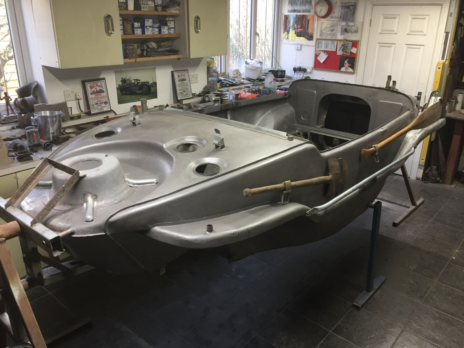

A little update on Phoenix - I had bought some replacement panels from the Czech Republic, but at the last moment I decided Id rather put the time and effort into repairing the damaged ones that I have.
Now I have elected to keep the combat damage, and accepted this will never be the smartest 166, it may as well be as original as I can make it.
I am aiming to increase the ratio of original to replacement steel, and as the balance increases in favour of original, so it follows that straight, unmarked pieces decreases - never mind.
So, here is a nice remade part from CZ, that will be left out.
In favour of a repaired part.
And, when parting the two sections by removing the spot welds, it revealed inside the previously hidden channel . . . . . .
