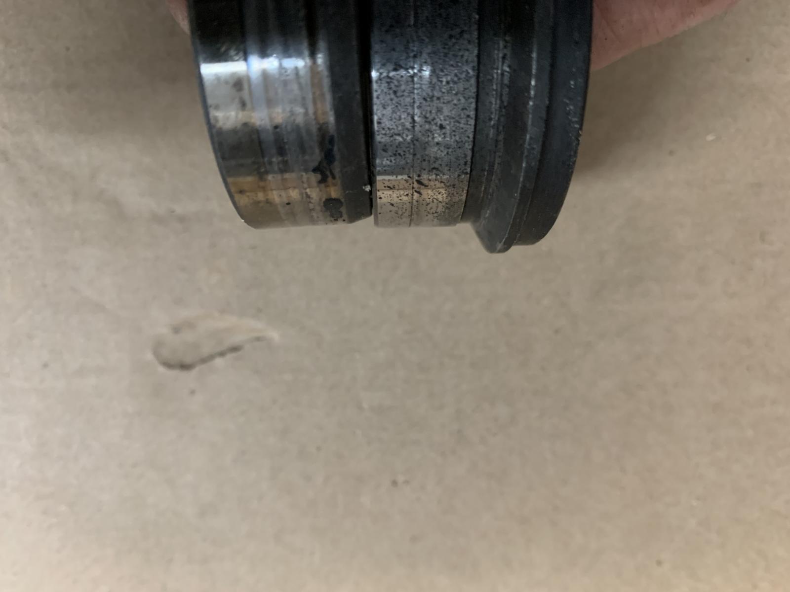

BarryL wrote:
If your new spacer looks like this WW one then beware it will need smoothing. If your old spacer is smooth then definitely use it. The o-ring thing is just how WW does it. It supposedly works.
Wow, wonder how long a new seal will last riding on that. Laughing
FWIW, I've removed enough material to clean up the seal surface on original spacers and everything sealed up just fine. They were given a high polish in the end. The groves were deep enough to catch you fingernail. I think I spun them on a bench grinder, but a lathe would be ideal.
What do your spacers look like?

Lost John wrote:
The groove that I'm talking about is the ridge from being torqued on old installations. The new one is sharp on the top edge but I suspect that it will mash abit after being tightened?
You want the the ridged kind. The ridge helps seal the o-ring. It is made intentionally like that. The material hardness of those spacers is one of the hardest things on your bus comparable to a connecting rod in hardness. They do not squish.
Here are a couple different genuine VW ones I found.

BarryL Premium Member
Joined: November 01, 2004
Posts: 15191
BarryL is offline
PostPosted: Mon Oct 16, 2023 6:35 pm    Post subject: Re: HOW TO: Install rear axle seal kit Reply with quote
Use the new o-ring as supplied with your old spacer. I wouldn't worry about that small a groove as long as it's smooth.
Posts: 15191
BarryL is offline
PostPosted: Sun Oct 15, 2023 11:39 am    Post subject: Re: HOW TO: Install rear axle seal kit Reply with quote
Lost John wrote:
Now I know -No washers,-small o-ring will strech and work,no large o-ring unless seal housing has a groove .
Correct. No bus cover has a groove that I know of. If you can, put tape over the splines and something slippery to install the o-ring or just be super careful not to cut into it from the splines.
Lost John wrote:
I did notice that the new spacer ,where it goes against the o-ring is different. Might use the old spacers .
