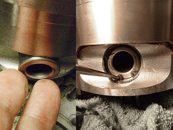

ouch piston out of cylinder 1989 wbx 2.1

I bought a pair of long reach n-nose pliers that are at about 20 degree angle and with a dremel wheel notched the tips to remove/install pin clips on the wbx. Soak the pin area with carbcleaner for a bit and makes getting pins out easier.

i am obsessed with designing a tool...that does not make us take off the pistons..i tried flashing and a hose clamp...to know avail...im thinking.. a vice grip type appuratus..that will let us get between the center of the jugs..

Oh - and to the original poster's problem - I've noticed in the past a couple threads where someone's rebuild was undone by not having the wrist pin clips in all the way. It's really tight in there and I can see how someone might miss this. After popping the rings in, I double-checked and triple-checked by turning the rings a few revolutions with an ice pick.

To get deep in the engine, where you can reach the rods and not "understand" the necessity to replace the faulty rod bolts you risk throwing a rod and wasting all the time/$$$ spent on the top end.

heehee..in all actuality...i first started doing this headgasket job because...people told me i couldnt...and that fueled the fire..in the mean time i bought another 2.1 ..
with 75k on it ..and am doing total top end rebuild with of that one ...

Replacing #'s 1 and 3 onto rods not so bad but 2 and 4 is soooooo much fun.

the van is in the air...im luckcy enuff to have a freind with a lift in his garage..i have free run of the place.
i will be checking cvs and all that fun stuff..
im oging to attmept to do the rings by hand...we shall see what happens..
i may jsut slpa new heads on the engine thats still in the van..
the enigine out of the van is one i bought with 70k on it..
but now i may save this for my 85 camper..

There is a first time for everything but a halfassed job will usually result with a hole in the block.
Strange, i did over 40 top end, of what i know, most of them not to say all are still on the raod.
properly reworked heads.
Rework those head is a waste of time and money.
If the engine is out do the ENTIRE clutch assembly, pilot bearing AND the trans input seal.
I agree but many are on a tight budget.
Nice time to do the CVs with all the extra room to move around and why not the rear brakes while it's up in the air.
Unrelated and i'm sure his van is not in the air.
Take your Bentley to the can when you go and absorb some Vanagon instructions.

Or, if you don't understand how to do this then this is a perfect time to slow down, study up, search the samba, buy some tools, learn, and do.
>>>>>>>>>>>>>>>rant alert<<<<<<<<<<<<<<<<<<<<<
Whenever the heads need to come off on a 2.1 it is prudent to R/R the rod bolts,rod bearings,piston rings/ hone the barrels and all the gaskets/seals that can be reached not to mention the properly reworked heads. If the engine is out do the ENTIRE clutch assembly, pilot bearing AND the trans input seal.

... Also, as long as you have the engine out, this is a good time to check the end-play and replace the mainseal.
So right. If you haven't watched this video at least 5 times, it is time to do so....
http://www.bostig.com/files/bostonbob&bostig-proper_wbxflywheel_install.wmv
Each time you will probably learn something new....

engine is out of the van
This is the good part - you're half way there. A new rod set from Frank Stamos and some bearings from Van Cafe won't set you back that much and you'll be in good shape for a long time to come. Also, as long as you have the engine out, this is a good time to check the end-play and replace the mainseal.
You're actually in good shape.
For the record, I found the wrap-around ring compressor confounding. It works but I had a hell of a time with it.

minsk wrote:
ok so ive been ...learning/doing a topend rebuild of my 1989 2.1 wbx.
things were going swimmingly...was trying to get the bottom cylinder seal off and pulled it to far off the piston..any tricks to getting it back on...ugh..piston rings in the way..
I know the feeling, I went thru the same thing; doing just a top end to fix a weeping head gasket and pulled a cylinder off the piston.
After reading/hearing about it here, I was afraid this was going to be a showstopper. But, actually, it wasn't hard at all.
I just reached in and compressed each ring by hand as I gently slid the cylinder back on. It is tight and I may have used something other than my fingertips, like a small block of plastic, to push the ring inward. But, I didn't use hose clamps or any special tools.
It was dead simple and I didn't have problems with the two that I did. If I was to do it again (i.e just a top end w/o cracking the case), I'll pull all the cylinders and put in new rings while I was there.
Lawrence

Kaiser Soze wrote:
After doing this job more than twice I don't waste time with homemade pin extractors, risking damage to the piston is not acceptable and it just takes too long.
POP THE RODS,REPLACE THE ROD BEARINGS,REPLACE THE 2.1 ROD BOLTS.
If you don't understand how to do this then you have no buissness this deep in the engine.
