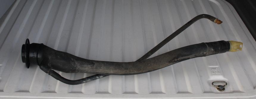

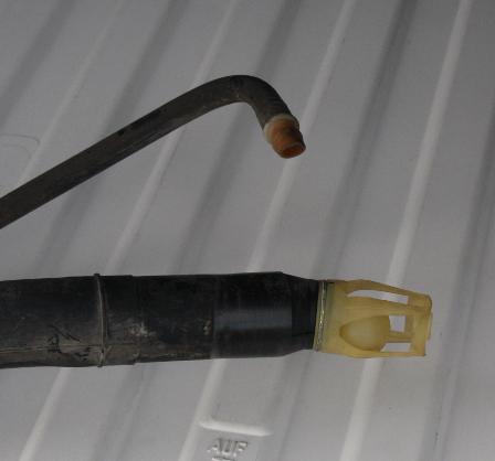

Just tossing these into the mix. As I recently repaired (yesterday) the vapor system on my 89 Vanagon Westy, I found the plastic ball inside the tank. It had been pushed out or fallen out of the cage at the end of the filler tube.
I was able to reinstall it, but while doing so I pulled one out of an 84 parts Vanagon to compare the filler tubes.
Here is what I found fyi.
Without ball in the cage.
Upper is the later model filler with cage.
With ball reinserted into the cage. The cage had no tears and was very solid.

I was out at a pull-it yard this afternoon (the one at US36 and Broadway) picking bits and pieces off of an '88 Wolfsburg. It was pretty picked over, but I was lucky enough to pull a good lower grill and a decent heater cover.
I pulled the filler neck just for kicks to see if I'd get lucky and find a ball float valve at the other end.
Well, the cage is there, but the ball is gone! D'oh!
The little cage has a part number, though, 191 201 207. I've checked a few of the usual sites and haven't had any luck yet.

251 201 129 (from my 87):
251 201 129A (from a 91 I believe):
Reckless Amateur wrote:
Comparing the one from the 87 I had and the one I got from a 1990, I think, the newer one had a ping pong ball float at the end which I don't thing the 87 did. If that helps. Very Happy
I almost answered "D'oh" to that, but now that I've seen the actual parts, well, that description is dead on Very Happy
