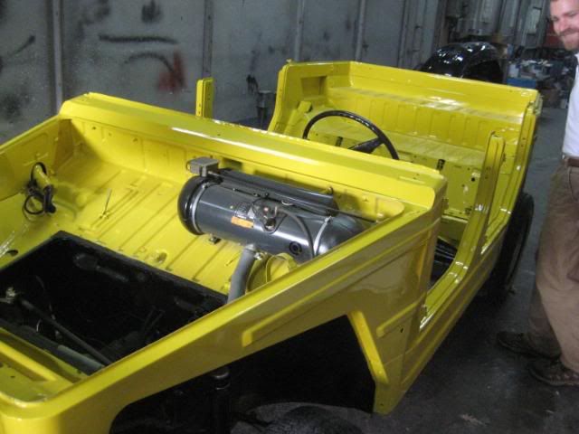

PostPosted: Fri Mar 05, 2010 2:02 pm    Post subject: Reply with quote
Came out pretty nice. Very happy.

PostPosted: Fri Mar 05, 2010 12:53 pm    Post subject: Reply with quote
How did it come ? Were you happy with it ?

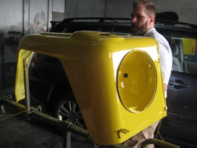

PostPosted: Fri Mar 05, 2010 9:53 am    Post subject: Reply with quote
Had the buggy painted there this week.

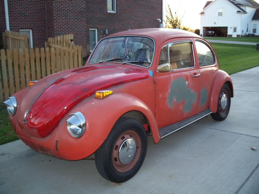

Since the Macco I used hadn't seen a beetle before, they were all very intrigued by it. I walked them through all the tough spots specific to the beetle.....and they spent quit a bit of time on it. I never thought about tipping the paint guy......
I love the paint job, but even after expaining everything to them, they failed to get the full door pillar on the inside...they assumed the carpet came all the way out. Oh Well, I still am very pleased.

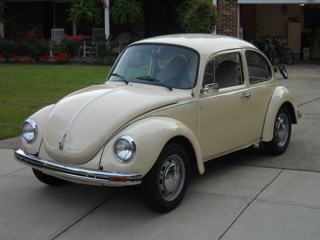

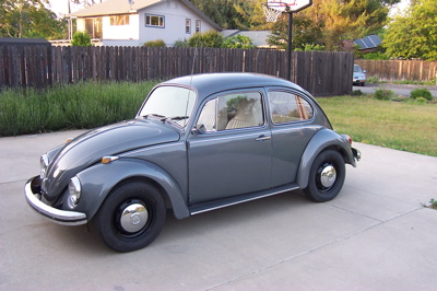

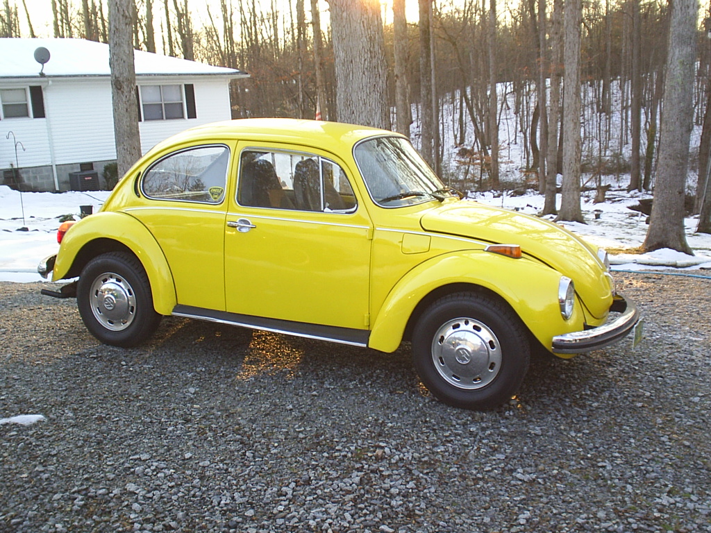

PostPosted: Mon Feb 22, 2010 7:02 pm    Post subject: Reply with quote
All 3 were painted at Maaco in Manville, NJ..I did the bodywork
