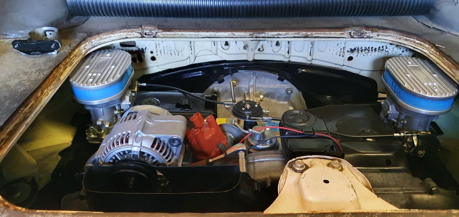

Today I worked on the right side bracket for my alternator. The slightly larger size means I had to locate it a little higher and to the left from where the stock generator sits. The location I settled on clears the distributor (just) and will allow for 5-10mm of adjustment.
Another quirk of this setup is that the post for the main wire ends up at the bottom of the alternator - I had to make sure there was no chance it would ground out against the fan shroud or engine tin. I couldn't get a photograph, but the post is at the front to the lower right near the distributor and has sufficient clearance (5-10mm) all around and I'm hoping access with a spanner will not be too painful..
I'm hoping to make the left side bracket over the next week or two.

PostPosted: Sat Apr 13, 2019 2:03 pm    Post subject: Re: Generator to Alternator Conversion Reply with quote
With the help from this thread, I converted to alternator as well. Generator didnt charge at idle and VR was broken, so easy decision.
Brackets were fabbed up in a morning, so install was all done in a day! Very happy with that.
Charges great, dashboard light gone at idle and voltage is extremely stable.
Tnx guys!
'75 SB 1303 2,4ltr T4 turbo: 10.58 @ 129.9mph
