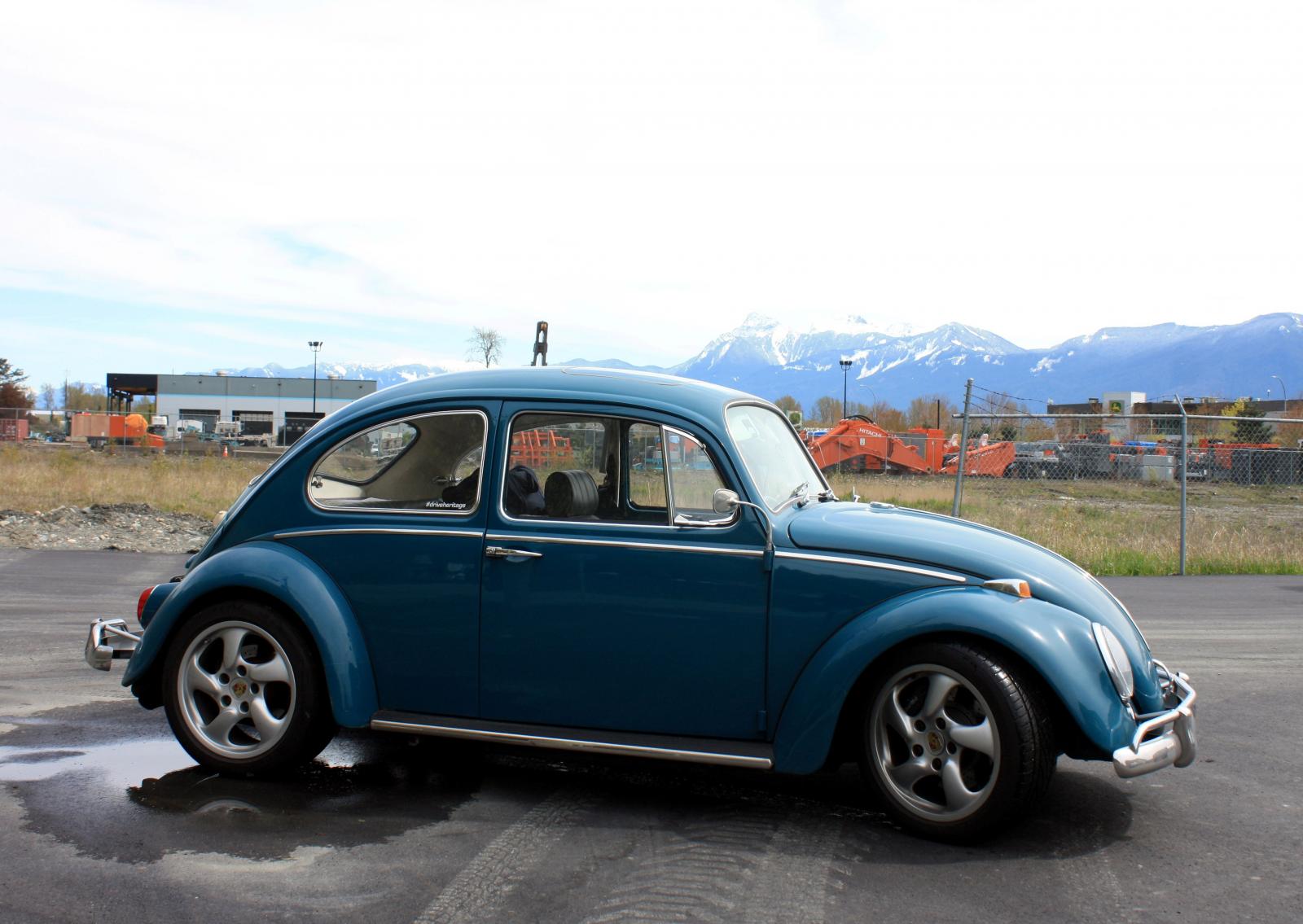

Hi Lars,
Ride is stiff with 1cm travel if you press down on the front fender.
you need to drive like you are riding a big motorcycle fast - look out for potholes and poor road surfaces.
I have brittle bones and stiff joints from chemo and radiation. I had no problem driving the Bug for 10 hours on a couple of long days.

Rich, what can I say Cool Beautiful car, nice trip and great pictures!
How was the ride? I am still a little nervous it may get to rough because of the heim joints and no rubber bushing shocks.

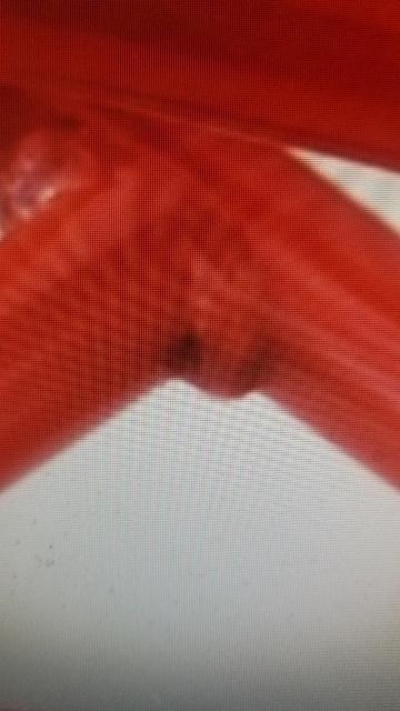

Here a couple more examples of poor quality parts they make. When I have time I will post more in hopes to help you folks be able to understand the safety issues. These are examples of none penetration welds and poor design. The spring plate replacement parts are extremely dangerous. A welded stud to a pc of tube, will break. Crushing tubes to weld to other tubes is a sign of cheap thin walled tubing being used. This type of thing will allow cracks next to the welds.

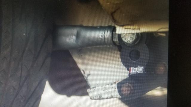

Are you going to back up your claim of "they have already had many failures" with evidence?
Here are a few pictures of a Imohr spindle that failed in the guys drive way after driving home.
