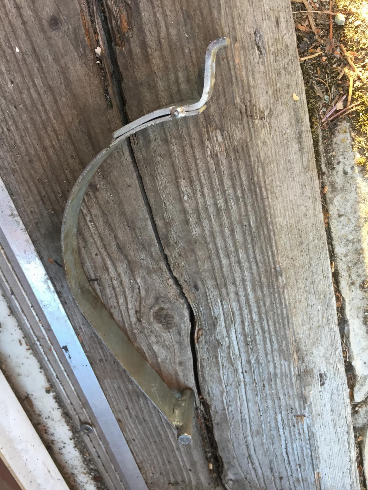

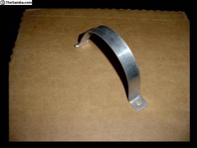

PostPosted: Thu Sep 22, 2016 5:40 am    Post subject: Re: Westy 1985 Muffler $ 59.17 ( after rebate) Reply with quote
I don't know where you came up with that two piece strap arrangement, why it's welded up that way, it looks like it's a home brew, patched up set up.
Taking a quick look at this strap that I manufacture, you can easily see how it could be quickly cut, shortened, and the end re-bent , drilled to accommodate any diameter muffler & hold it tight to the upper saddles.
IF--you cut it too short, it wouldn't be an issue as all is you would have to do is use a longer strap bolt to pull it tight to the saddle.
It may be difficult to use that patched strap that you have to get the same results--it may not work as I have described.

PostPosted: Wed Sep 21, 2016 6:32 pm    Post subject: Re: Westy 1985 Muffler $ 59.17 ( after rebate) Reply with quote
Do just as I suggested.
Shorten up the strap.
Cut the end off, duplicate the bend, drill a new hole.
Slack will disappear.
T.K.

PostPosted: Wed Sep 21, 2016 6:12 pm    Post subject: Re: Westy 1985 Muffler $ 59.17 ( after rebate) Reply with quote
Here is the one I was hoping to use:

PostPosted: Wed Sep 21, 2016 5:57 pm    Post subject: Re: Westy 1985 Muffler $ 59.17 ( after rebate) Reply with quote
Now you're going to make this pretty simple task difficult.
Cut the end off of the straps , put another bend in it to duplicate what you just removed,
drill a hole, it's all done but the crying.
But, this can be only done with the solid straps I build.
Not the doubled up, rot off of the van in a year, Chinese copies of the original straps.
Then your stuck.
Let's see what you have.
T.K.

PostPosted: Wed Sep 21, 2016 5:34 pm    Post subject: Re: Westy 1985 Muffler $ 59.17 ( after rebate) Reply with quote
The answer is so simple, you'll bonk your forehead with your hand.
Shorten up the strap a hair.
Done.
If the strap you have is pretty maggoty, I custom manufacture heavy duty straps for a situation just like this.
T.K.
