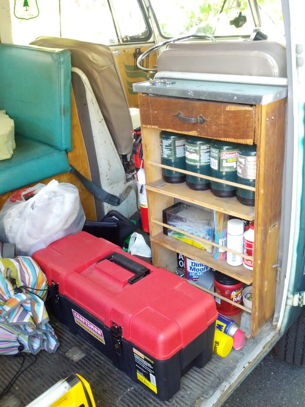

Right! Here we go...a few snaps. Don't mind the clutter.
This was once a complete fidge/sink set up, but I hated opening both doors to get into the back. So I pulled it out, donated the fridge and water tank, then cut the frame down and built a rack out of it.

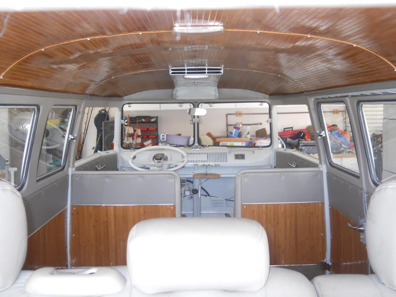

Shot from the back. I have the front kick panels cut as well, just trying to sort out some electrical gremlins before they get installed.
The rear seat wasn't quite a perfect fit so there is a small gap on either side. Trying to think of a way to get a cup holder in there for the rear passengers.
Love the stock dome lights...

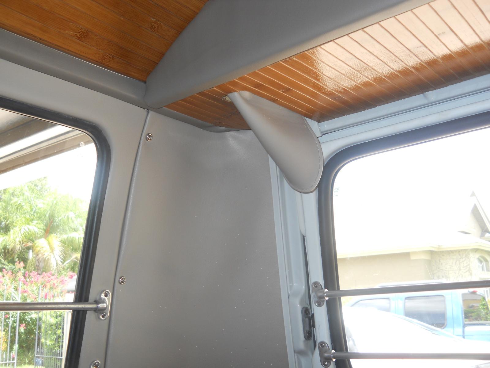

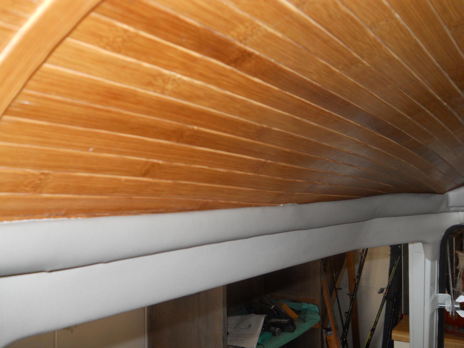

Do you have any more pics of the headliner, with a detailed look of how the edges were finished?
Thanks for the compliments flem...
It was more or less trial and error and error on getting the headliner to fit. The bamboo had to be tapered toward the front of the bus above the driver and passenger. Then from the overhead back, it was pretty square. If you look at previous posts, There are ribs glued to the ceiling. There is about a quarter inch gap between the ribs and the area above the windows.(Opposite the drip rails on the inside) The bamboo tucks into that channel. I couldn't get the vinyl to stay consistent where it tucked up between the headliner so I picked up a roll of that cheap fake chrome fender trim from Discount auto and put it on that channel lip to hold the vinyl. You can see some of it in the pics. It doesn't fit above the driver and passenger area because the lip is too thick there. The chrome matches the trim width from the stock deluxe panels so I am happy with it.

Wow, that looks so sweet. I love the look of the arm rest.

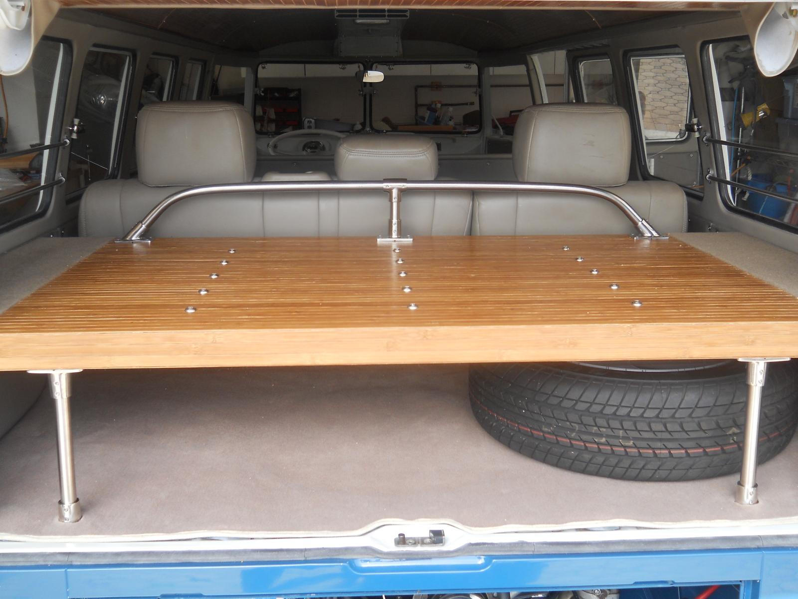

I'm still looking for the chrome trim pieces for the cargo doors. All four.
A leather belt works pretty good for a cargo check strap if you want something a little different...

Rear seats installed.

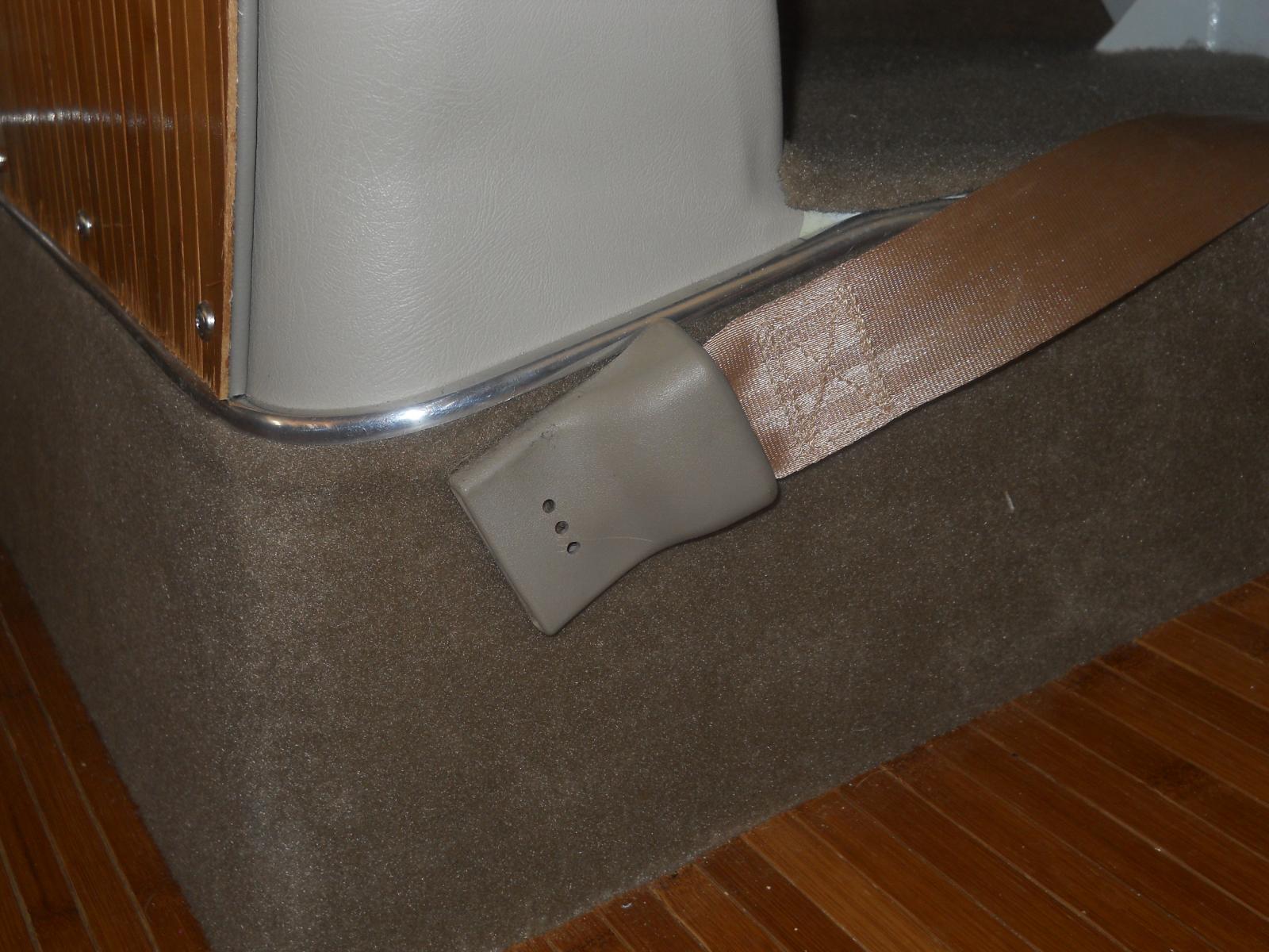

Ended up using the rubber seatbelt end covers from the Sequoia seats on the front seatbelt ends in the walkthrough area. Figured it would probably save someones ankle skin at some point...

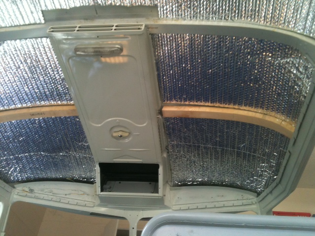

PostPosted: Sun Apr 08, 2012 9:37 am    Post subject: int Reply with quote

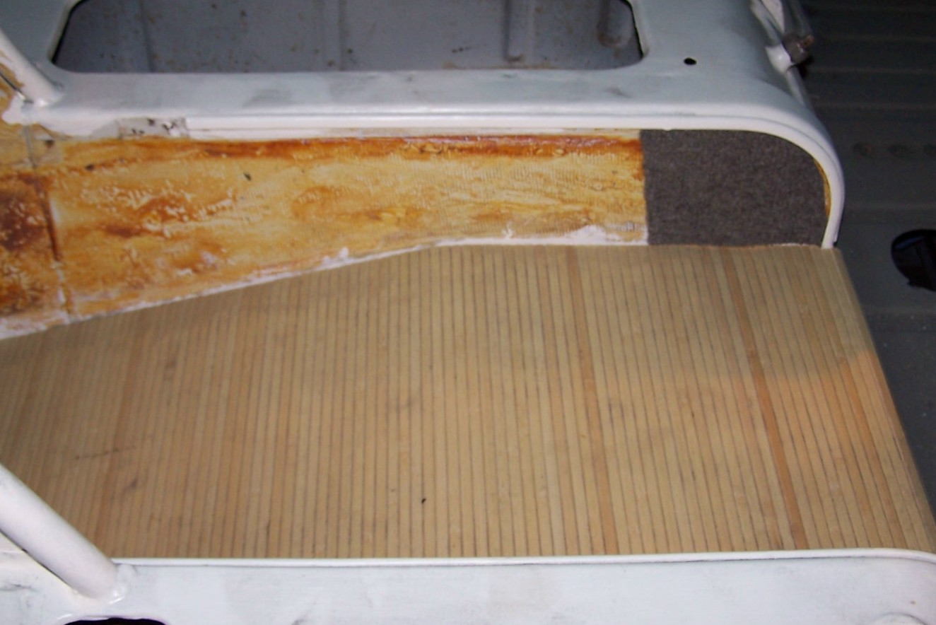

a couple of shots of what is behind the ceiling bamboo. glued the bows on with marine 5200. scuffed the epoxy and drilled holes in the tops of the bows to get extra grip. the roof flexes when I pulled on them so I think they will stay put. In hindsight, a thin sheet of wood put on first might have made the bamboo install a little smoother. There is a slight sag in one section of the bamboo where the bows are about 14 inches apart.
This is after the sound deadener and heat shield are installed
