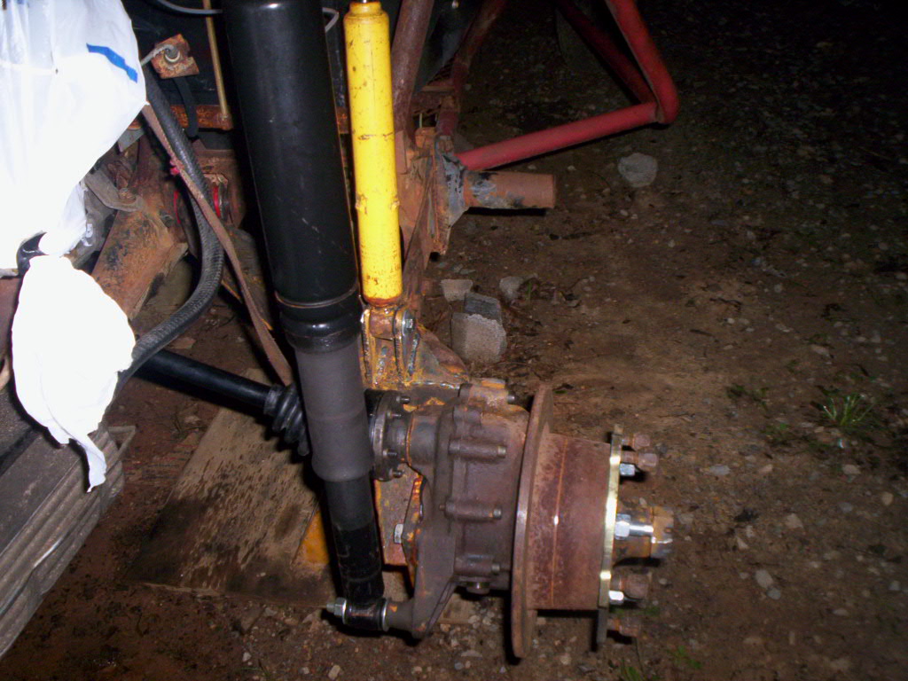

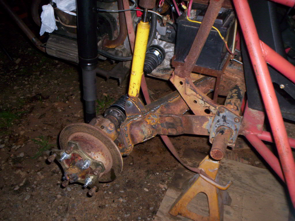

PostPosted: Tue Nov 30, 2010 5:05 am    Post subject: Reply with quote
the setup survived another weekend at the nearby OHV park... though we did notice loose swing plate bolts on one side after we got it back up on the trailer. Here's a very short video from when he got it up onto a section of rock garden for a photo op. Wish I thought to record it from the beginning... maybe next time.
oh, not sure if I mentioned this before but this is large nut RGB, which is why he made hubs out of the old brake drums....
Nick
