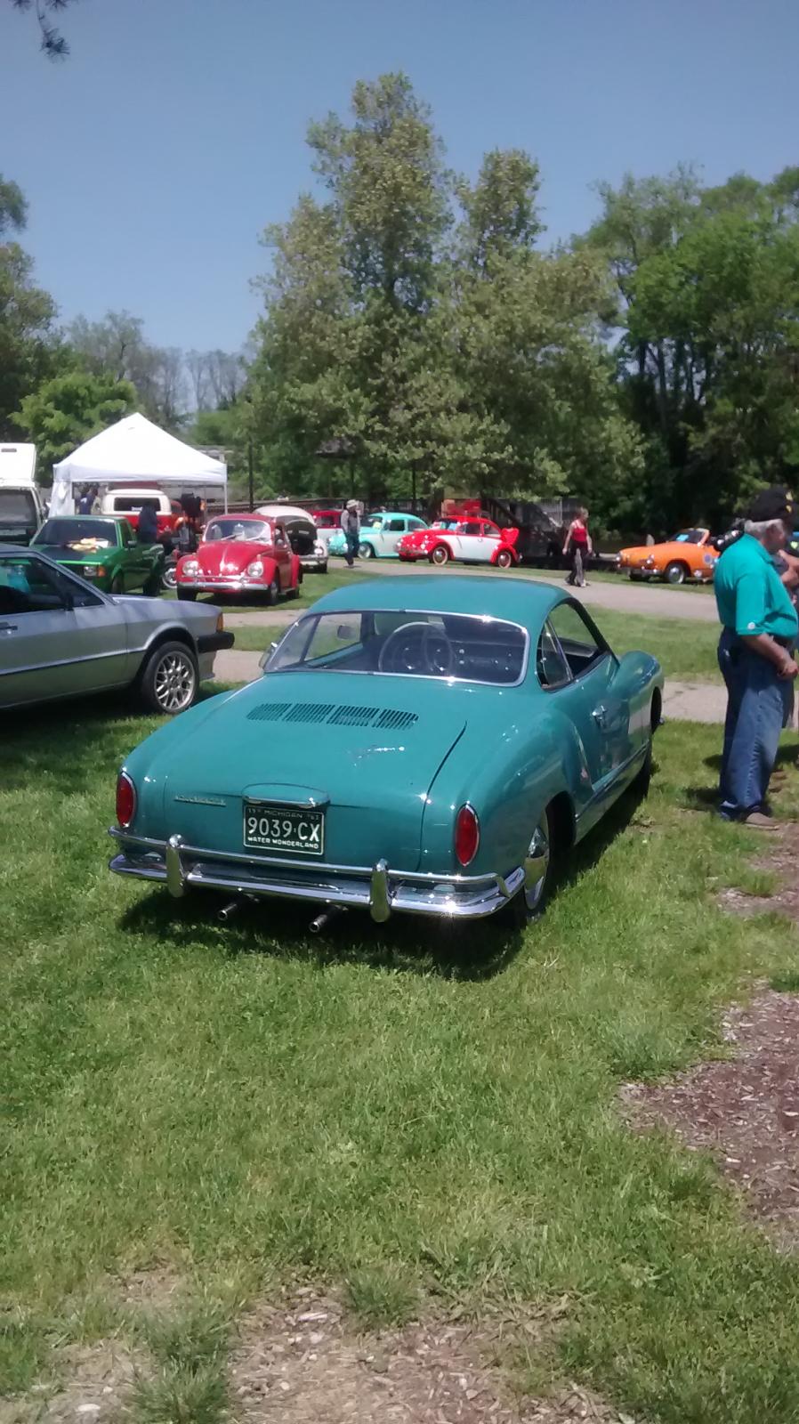

Long time, no update! I've crossed over 3000 miles in the Ghia since it's been driveable. I still am tweaking things here and there as I go; headlight aiming, front end adjusting, squeak and rattle finding, etc.
Took a couple cell phone photos at the Michigan Vintage Volkswagen Festival a couple weekends back:
