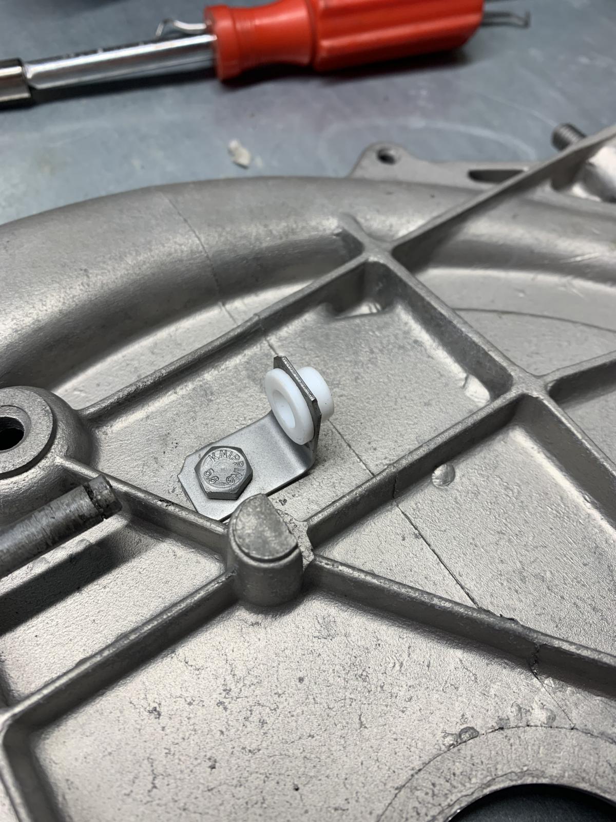

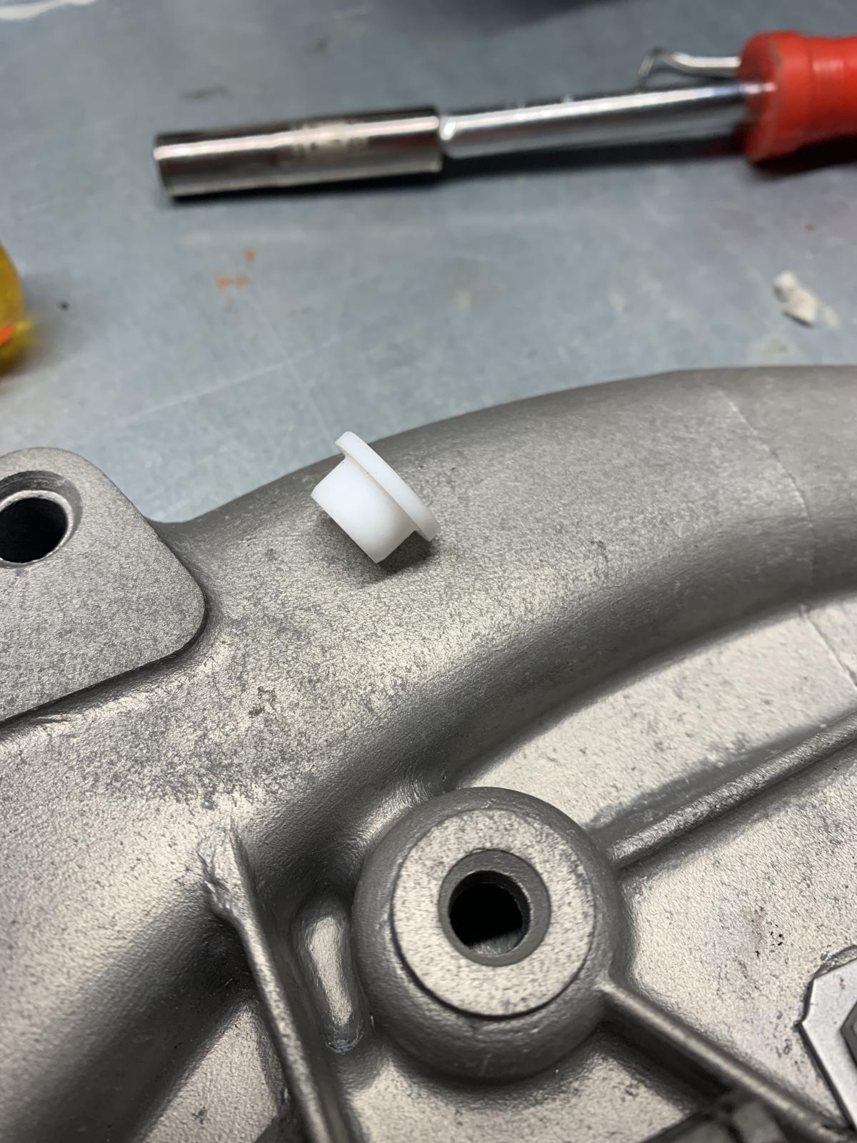

This is a good thread and I thought that I would contribute is some small capacity to it.
My center bushing, the black plastic thing that sits in the l-bracket in front of the shroud did not survive. It was baked and just fell apart. I don't believe these are reproduced but I did find an alternative on mcmaster by searching for bushings. This seems like the only place that has 11mm OD, 7mm ID shoulder bushing.
It is a little loose in the bracket so I applied some fast setting weather stripping glue. (Other than it being within reach, there is no specific criteria for selecting it).

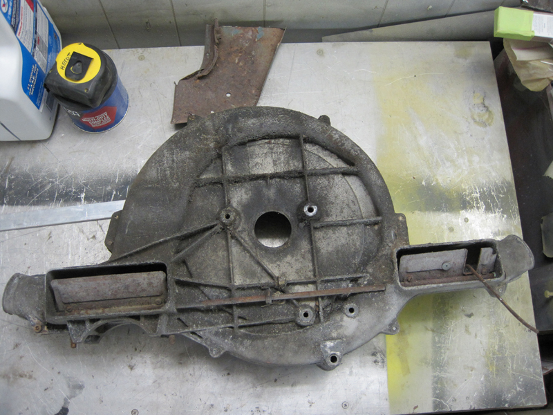

You can see in this picture, how the bell crank is installed.

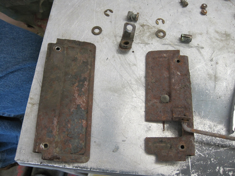

PostPosted: Sat Jul 10, 2010 2:52 pm    Post subject: Reply with quote
Success!!
Smaller bits: E clips/ washers, special bolt/washer/nut combo and the center support bracket, and in far upper right corner, the surviving flap mounting screw/washer/nut combo.
One of two flap rod bushings.
The two cooling flaps and other bits.
Hard to see 'cuz of the rust, but there are splines that are on the flaps rod, to help anchor the flaps to the rod. One on each end of each flap (four total sets.)
Bob put the center support bits and flaps and clips back on the rod to keep them together and roughly orientated.
Interested observers, or captivated audience.

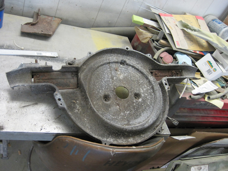

O.K., amateur photographer and secretary, Sue here. Bob's back out in the shop working on "Wolfie." So, I'll put up the pics on the flap removal, probably in more than one post, so my ol' dial up, can keep up.
Reinstallation, would just be the opposite, only easier, 'cuz the rust will be removed by then.
First shot is an overview of the fan shroud, off the car, with the side that would face the engine, up.

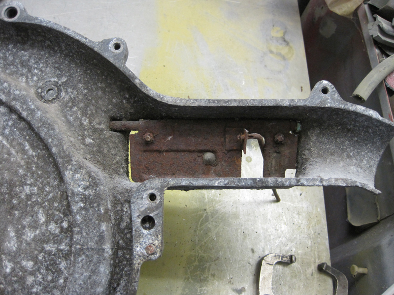

Here the fan shroud halves have been separated for easier access to the nuts and bolts for the flaps.
A close-up of the flap to bell crank control rod attachment, to the flap.
Two (of the four-total, flap m3 or m3 1/2 nut/washer/screw combo), out. Naturally, sheered three of the four screws due to rust. But at least one survived as a sample, for replacements.

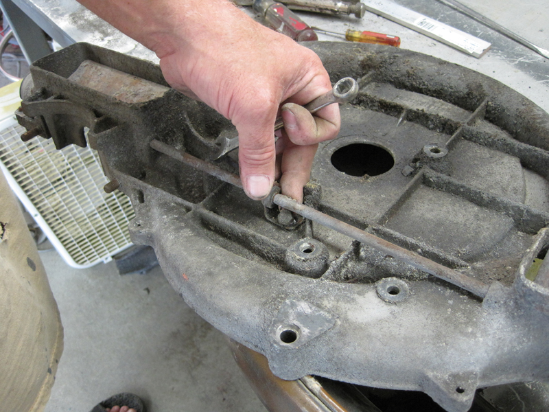

Removal of the E clip and washer, from one end of the flaps rod- you have to do the same thing to the other end.

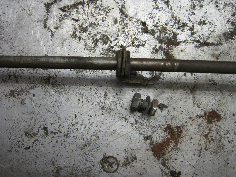

Removal of the center support bracket special bolt/washer/nut combo.
Spreading the tabs on one of the flaps, so that the flaps rod can be removed. Repeat on the other flap.

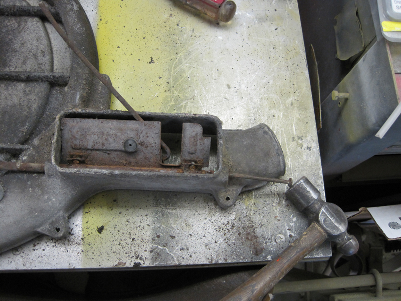

Start of the removal of the flaps rod. Bob started with a nail, but switched to a punch and then to a long Phillips screwdriver to force (break the rust grip) the rod out.
But that was only partially successful. A couple drops of oil didn't help much either. So he resorted to a really coarse sand paper to knock down some of the rust.
