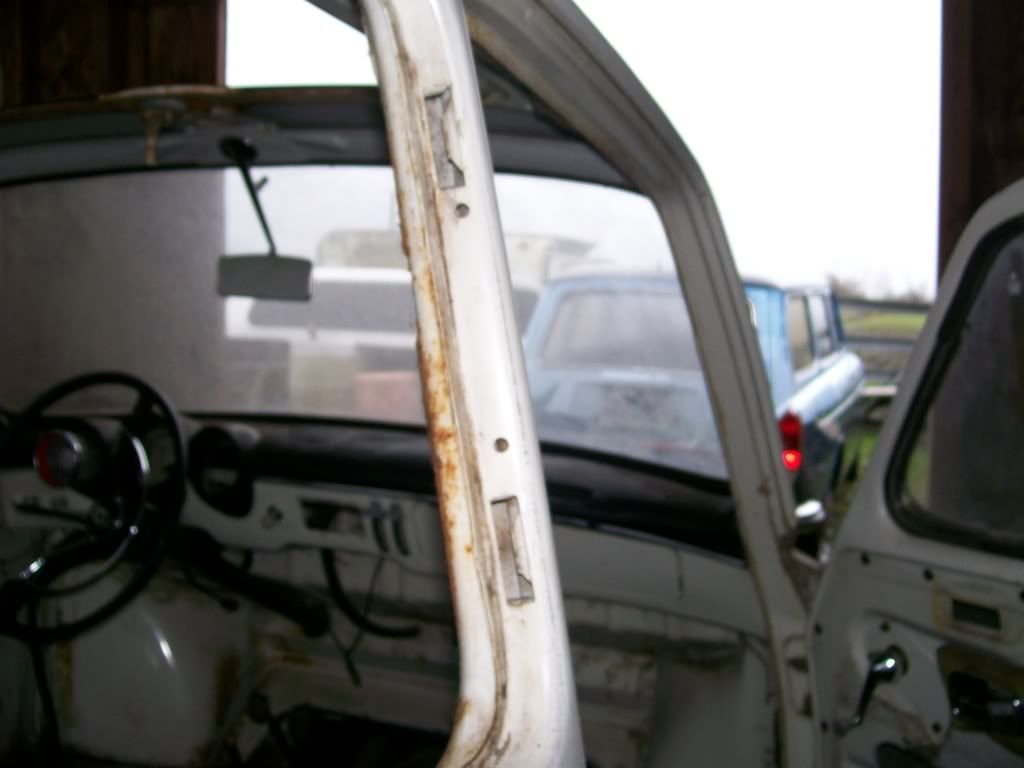

PostPosted: Thu May 04, 2017 3:48 pm    Post subject: Re: Pop Out window rubber '69 Squareback Reply with quote
There were plastic caps on them originally, but we just used electrical tape so they don't rattle.

PostPosted: Thu May 04, 2017 3:34 pm    Post subject: Re: Pop Out window rubber '69 Squareback Reply with quote
Ahhh. OK, I'm good there.
Nothing else goes there? I seem to remember a strip of tape over each slot.
So, put the rubber on the hinge, tape back the edge, and install is all I have to do?

PostPosted: Thu May 04, 2017 2:02 pm    Post subject: Re: Pop Out window rubber '69 Squareback Reply with quote
See the tapered metal hooks welded in at the factory up thru 1970.

So I'm resurrecting this thread, again.
My question was, when installing the pop-outs, does the hinge cover go on the frame first, or on the pillar first?
Then I see this.
KTPhil wrote:
Do you have the correct metal and plastic pieces at the hinge side on the B-pillar?
I don't recall a metal piece when removing. What I recall was a piece of tape over the slots on them B pillar.
So please, y'all, set me str8 on installing pop-outs.
