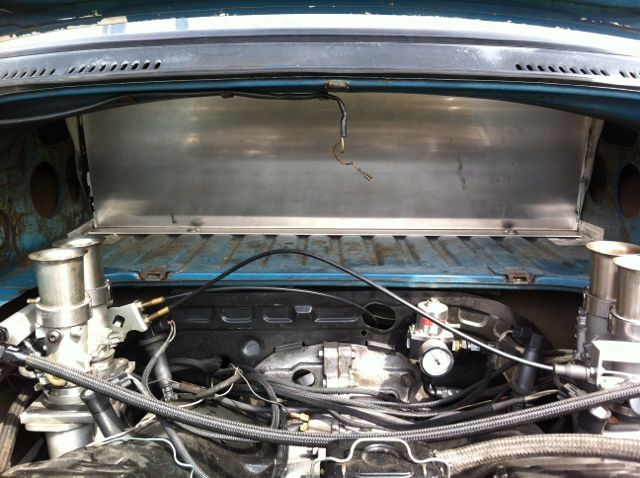

thanks for the picture! did you do anything under the sheet to the body's ribbing? any batting or just left the small gaps?

PostPosted: Sun Mar 17, 2013 9:55 am    Post subject: Reply with quote
I hae a nice strong idle at 850 with no electrical load and 750 with the headlights and fogs on. it idles fine down to 600 but that will make cold starts too exciting.
Brian- i used .040 aluminum sheet. Eric Anderson braked a flange into it it and installed a couple of trick fasteners.

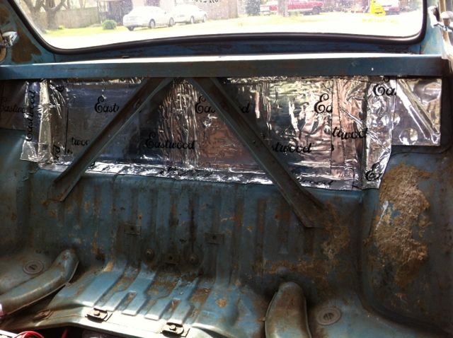

can you show a pic of your firewall? i keep pondering how to deal with mine for the noise.
glad you found your gremlins! i hate those things...
