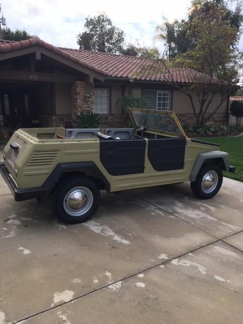

Said goodbye to the 74 yesterday. Heading eastbound to Pensacola Florida. I can say that it is much better than when I found it. Cool

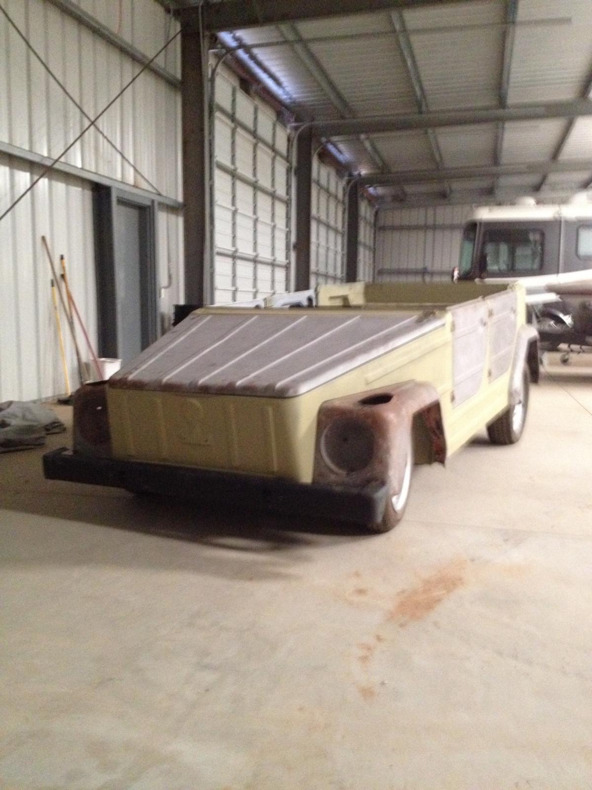

I picked up the new wheels and tires. I went with a more stock look than the 7.0-15 tire I was going to go with. The car is also up for sale. My Bus project is coming up and I have to concentrate on one, so the Thing has to go. Crying or Very sad

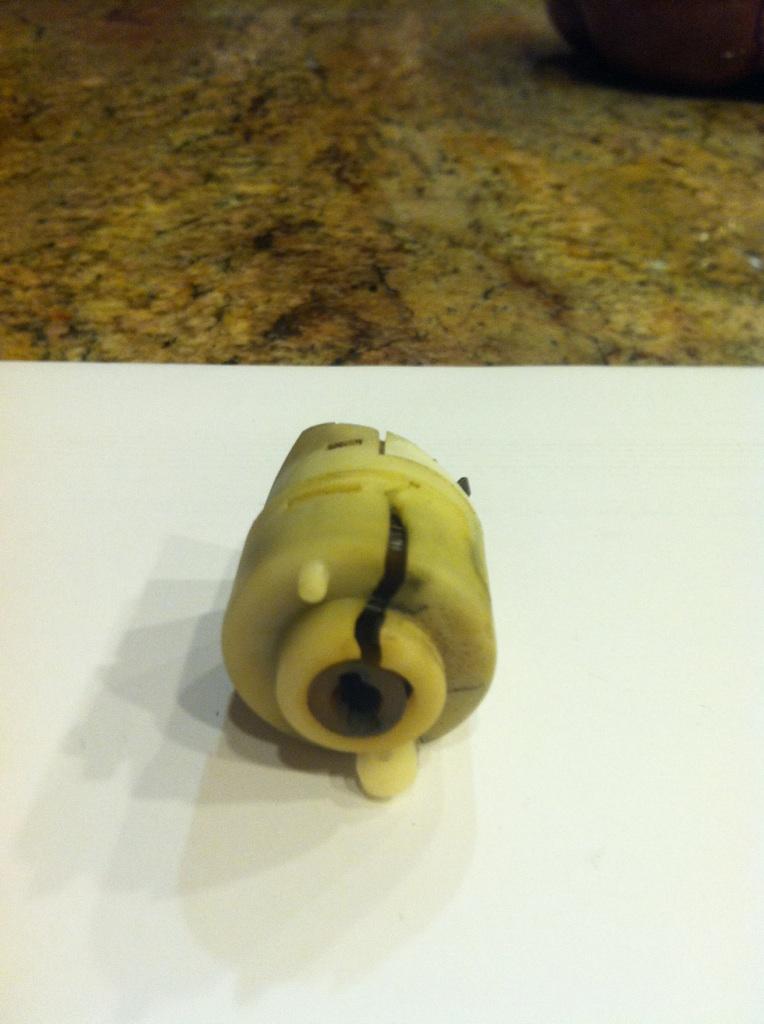

PostPosted: Mon Nov 17, 2014 10:42 am    Post subject: Reply with quote
So I decided to take a spin in the 73 this weekend. Turned the key and nothing. Crying or Very sad I figured the battery was dead so I pull out my trusty jumper box...still nothing. Now on to the volt meter. Battery good, ground is good. Maybe its the switch. I pulled the lead to the back of the switch and found power. Pulled the steering wheel, pulled the turn signal and the cover to the ignition (finding lots of dirt and debris) and wala:
I'm surprised it even worked. I did a few searches here on the Samba and found a thread saying the 73 switch was different than the 74 and that the aftermarket Bug switch was too short. Now that it is Sunday and my local family owned VW shop is closed, I decided to try Autozone. Even though I was warned here on the Samba that all switches are not created equal, I tried the 73 Bug switch. It looked like it was the same size, however it had one extra terminal that the Thing switch was missing. I cleaned everything up, installed the switch and ...nothing. Crying or Very sad
