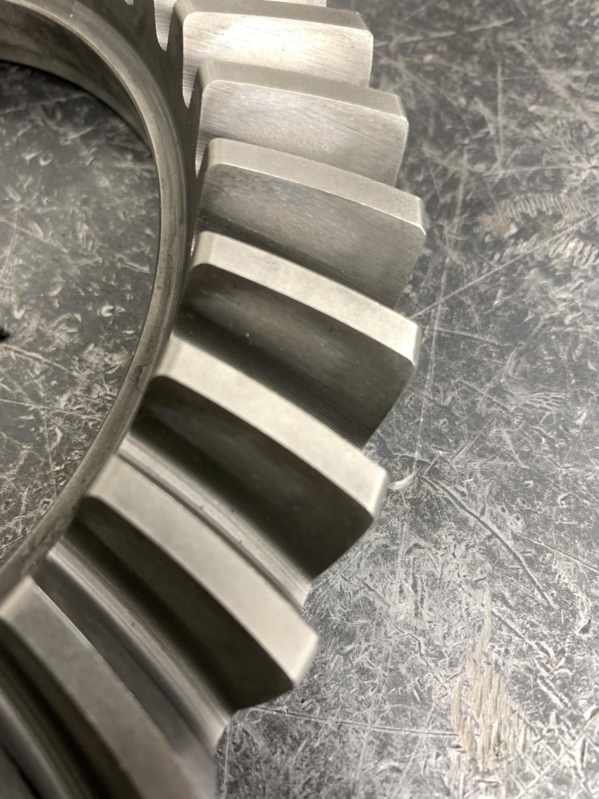

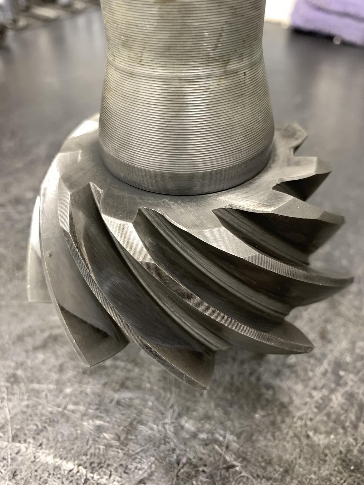

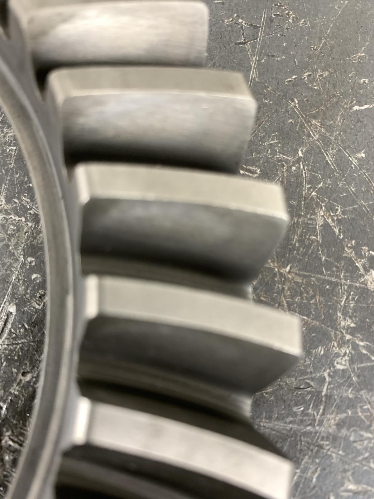

PostPosted: Wed Dec 04, 2019 5:45 pm    Post subject: Re: Automatic Vanagon 3.3:1 Ring and Pinion available soon... Reply with quote
Hello Everyone,
I have removed my 3.27 R&P to show you the quality and durability of my product after 60,000 miles. I am the only supplier who can prove my product is the best out there if installed properly, with the correct lubricant (no redline) and cooler (my cooler).
I will be installing this same 3.27 R&P into my differential and I will pull it after another 60K miles.
As a reminder I have 1991 Country Homes Camper with a 2.5 Frankin Subaru motor (165HP). I have also replaced the ATF, gaskets and screen every 2 years as recommended by VW. The gear oil I use is
Swepco 201 Gear Oil, 80/90 and Dextron 2 ATF or equivalent.
Looking forward to another trouble free 60K.
Cheers,
