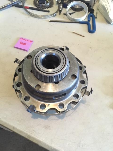

syncrogreg
Joined: November 08, 2009
Posts: 743
Location: USA (Nashville TN)
syncrogreg is offline
PostPosted: Tue May 05, 2020 1:46 pm    Post subject: Re: Pastis the twin turbo PDK Syncro Reply with quote
Yep I use the model with oiling holes with LSD Wink
There are other ways to tell if trans is LSD or not there is a oil feed tube to the diff.

gears
Joined: October 28, 2002
Posts: 4411
Location: Tamarack, Bend, Kailua
gears is offline
PostPosted: Tue May 05, 2020 1:24 pm    Post subject: Re: Pastis the twin turbo PDK Syncro Reply with quote
My Porsche counterpart tells me the PDK LSD has oiling holes at the top, while the open diff does not ..
