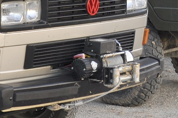

Well its finished now and wired up and bash plate back on,
All the control gubbins is inside at my feet,
And the controller lead just plugs in this so I can use it inside,
Or outside,

As promised, here it is and no front heavy boinging around.... Their will be a clutch mod made so I can do it inside the van,
This weekends jobs include finishing off some very stylish checker plating bits I have been working on this week in the evenings, and mounting the winch I took off the doka.
I took the winch off the doka (seen below) because it is bloody heavy and with it mounted so far out at the front it acted like a leaver effect when going over dips and bumps. Especially with the weight of the bull bar too.
So it sat in the hallway at home and the Mrs was getting the hump with keep looking at it sat there, and that gave me the push to do something with it. The Westy has some heavy duty springs fitted to the front and I fitted a set of these too, http://cgi.ebay.co.uk/ws/eBayISAPI.dll?ViewItem&am...1901wt_907 that have stiffened the springs up some more ready for the extra weight.
This time I am going to mount it differently and because I have a drop down front bash plate, like this I can get to it if I need to.
Thats right its going much further back near towards the front wheels so i hope it wont boing around so much. I had Ian @ http:// www.holman-engineering.co.uk AKA SilverBullet to build a bracket for me to my design suggestions and winch position (up side down fitting) and he added the know how on how to fix all the metalwork together. It is just a base to start work from as it would be difficult just to build a one off bracket from scratch without any tweeks and to keep the costing down I dont mind doing the fitting, un fitting, cutting, fitting again and so on until it works pukka. Anyway this is it in its raw state,
I am going to be feeding the cable through the front beam so the first adjustment to the bracket was to cut abit out so the cable could be fed through with the cable being fed on the underside of the spool thus putting less stress on the winch mounting points than if it was over the spool. Plus it lines up on the underside
I cut a hole in the front beam,
And then one abit smaller out of the bumper,
The winch was then mounted to see how it all lined up,
Bolted the bumper back on along with the rollers,
And popped some checker plate strips on the back to match the front,
jed

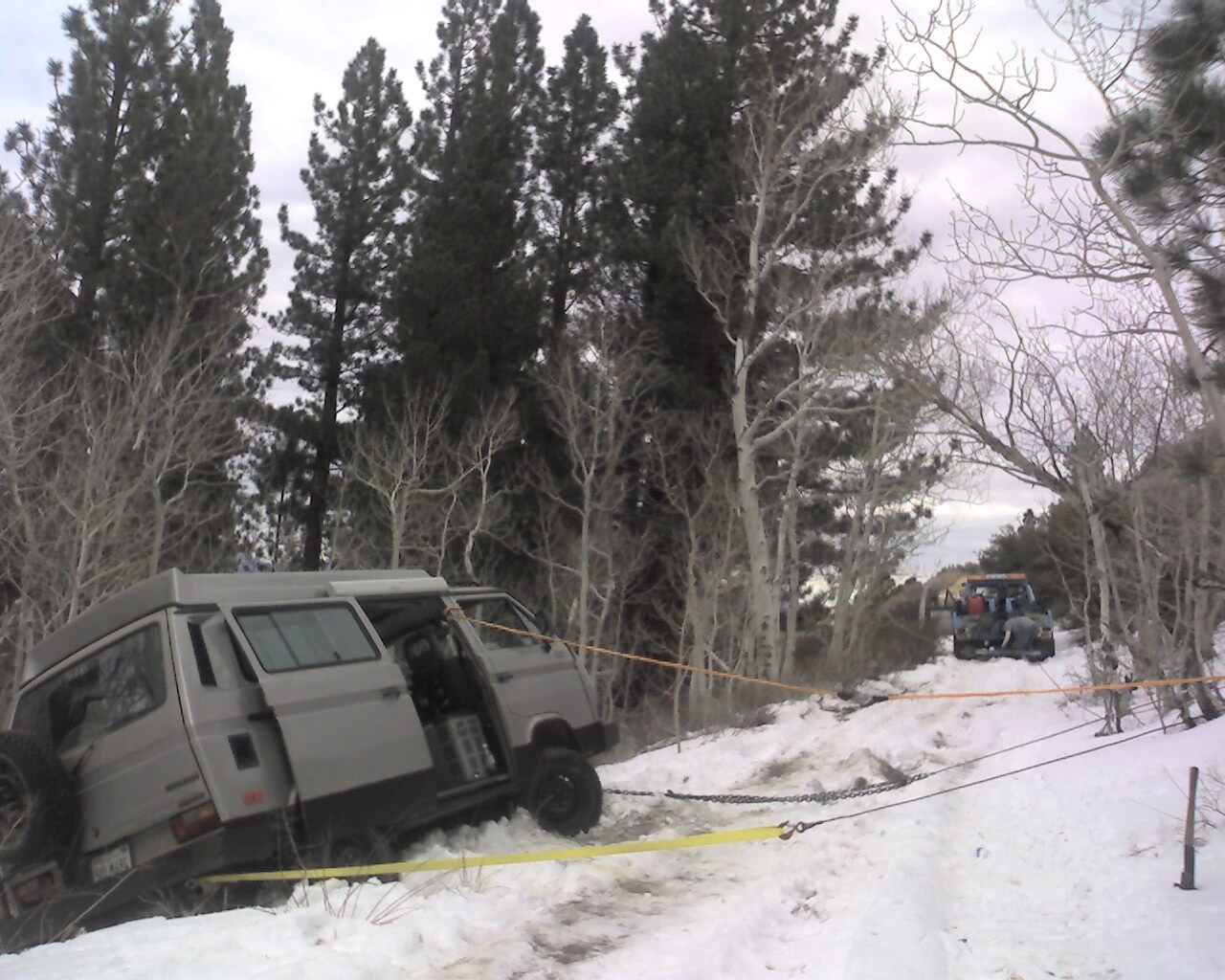

j_dirge wrote:
Jon_slider wrote:
If the Van below had a front mounted winch, a hand winch, or a hilift in winch mode, it might have gotten out without a tow truck.. but winches only work if you have the foresight to bring it. Its hard to forget to bring a permanently mounted winch Smile
http://www.thesamba.com/vw/forum/viewtopic.php?p=3630033&highlight=snow#3630033
Or you might just rip a tree or two out by the roots.
I am not seeing a large enough trunk to confidently set a power OR hand winch to.
Maybe there's something off frame?
But thats a good point to bring up.. What do you do with either if there's nothing to set to? (rhetorical question)
There are MANY places where winches don't help much .. Like in deep sand on the beach... Or in desert areas... muddy meadows... You have to bury a tire or use an anchor of some sort.
Thats a LOT of work regardless powered or muscled winch.
FWIW.. A hand winch stows under the rear seat with plenty of room to spare. No reason to ever forget to bring it along.. Have had various types in most all my vehciles since I did my first trip to Baja in '82
Kind of like a spare tire and vehicle jack. Don't drive to the store without it.. much less offraod and into the wild.
Those trees are big enough to pull the van put I pull shrubs out around the house with my winch and I have to anchor the van to my GMC to keep it from sliding forward.My this could help http://pullpal.com/

I dont know how this winch is mounted, or whose van that is, but, I like it
http://tinyurl.com/26l7y3t
