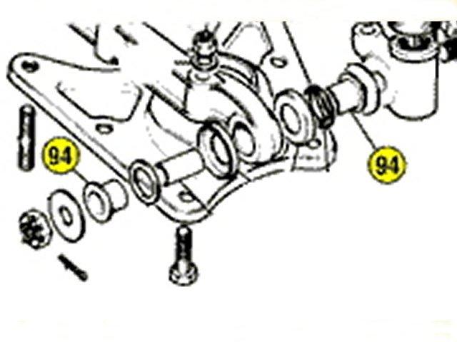

acecabristol wrote:
Good evening - I am relatively new to the site but am an old fart with a lot of British car and VW experience......If you want a solid, inexpensive, easy fix for the shift bushing on the 80 - 83 Vanagon order part number 661-740 from Moss Motors (British cars) in California. it is a Nylon bushing for the front suspension on a Triumph TR6 - about 90 cents. Fits perfectly. Not necessary to remove the shifter rod. Cut a slot on one side with a hacksaw, heat the bearing with a heat gun enough to bend it and slip it over the shifter tube - slide it up into the bearing mount, grease the shift tube, drill a very small hole through the bearing mount and lip of the bushing and run a piece of safety wire through them both to keep the bushing in place - alternately it can be done without taking the fuel tank out but you won't be able to safety wire the bushing in place - instead, when you slip the bushing along the shift tube to push it into the bushing mount you can cover the OUTSIDE of the bushing with epoxy - then slide the bushing up the tube and push it into place in the mount with a long screwdriver - easy, solid, fast, cheap.
From: http://www.mossmotors.com/Shop/ViewProducts.aspx?PlateIndexID=32797#top it looks like part is:
#94 661-740 $3.45 NYLON BEARING
As shown:

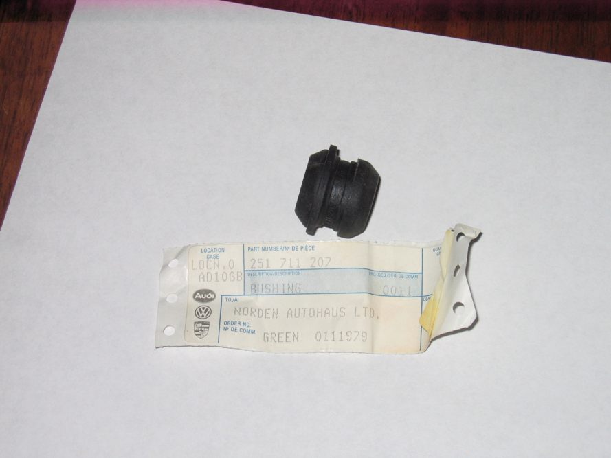

Fishguy wrote:
Ken Wilford at Van Again has these in stock at a really fair price.
http://www.thesamba.com/vw/classifieds/detail.php?id=1220154
Let's see: Euro 8 is about $11. Add shipping and some profit does that come to $24 plus, I assume, shipping?
BTW: I am guessing Euro 8 is with the VAT or Value Added Tax which should drop if being shipped out of country. Last I recall that was like 14%. So, now I think, the real price is like Euro 7.50 minus about 1 is about Euro $6.50.
I am not ranting, but would like to, but when I see what we post here is used for profit, it bothers me.
Is that "a really fair price?"

That is the bushing a group of us ordered from Germany.
1982 Westy, 1974 412 Variant... Yes, Aircooled's are great! Oh and I do have modern computer controlled vehicles too, but I just don't care about them.
