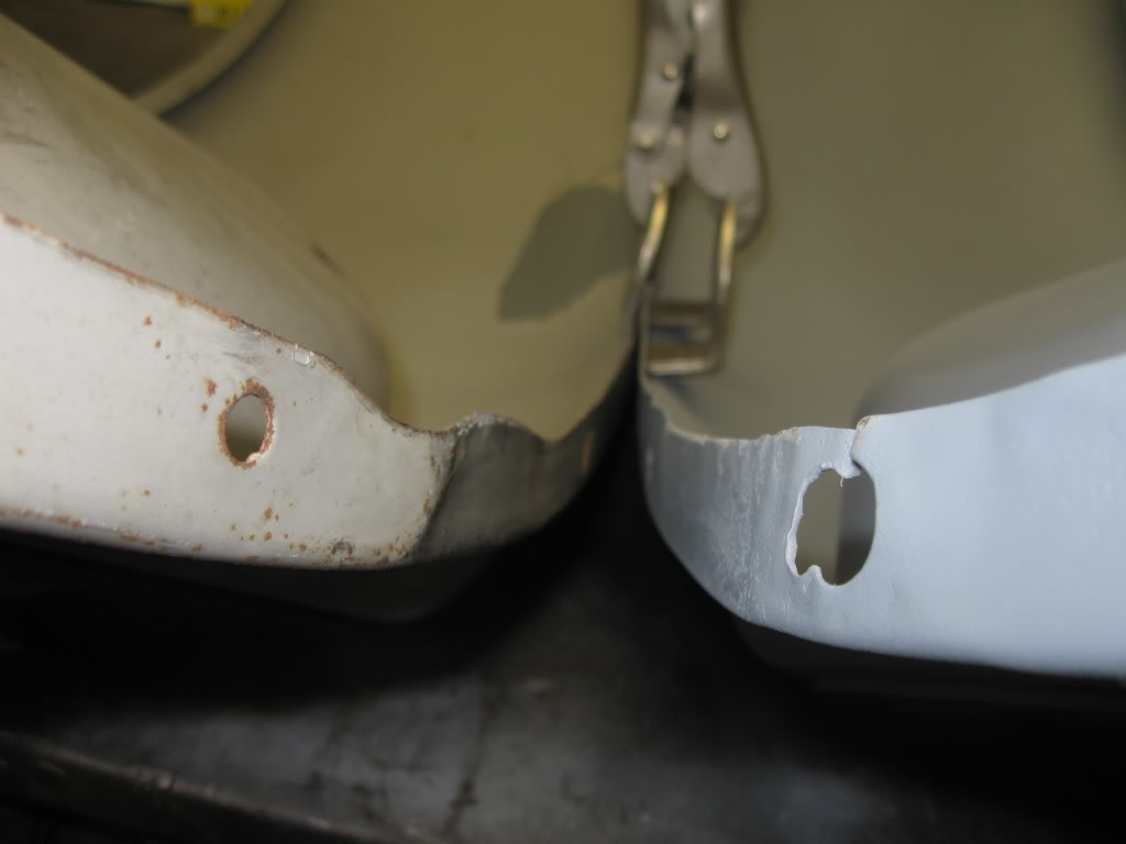

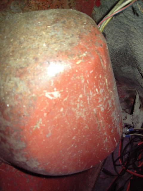

i'm trying to identify a fender that seems to be wider than my stock '67 front fenders.
It also seems to have a more pronounced profile from the headlight bowl to the mounting edge.
The one on the left is roughly 15mm wider than other 60s fenders I've compared it to.
Any idea what year (year range) this would be from?
(PS. the turn signal hole was hacked in after the fact)

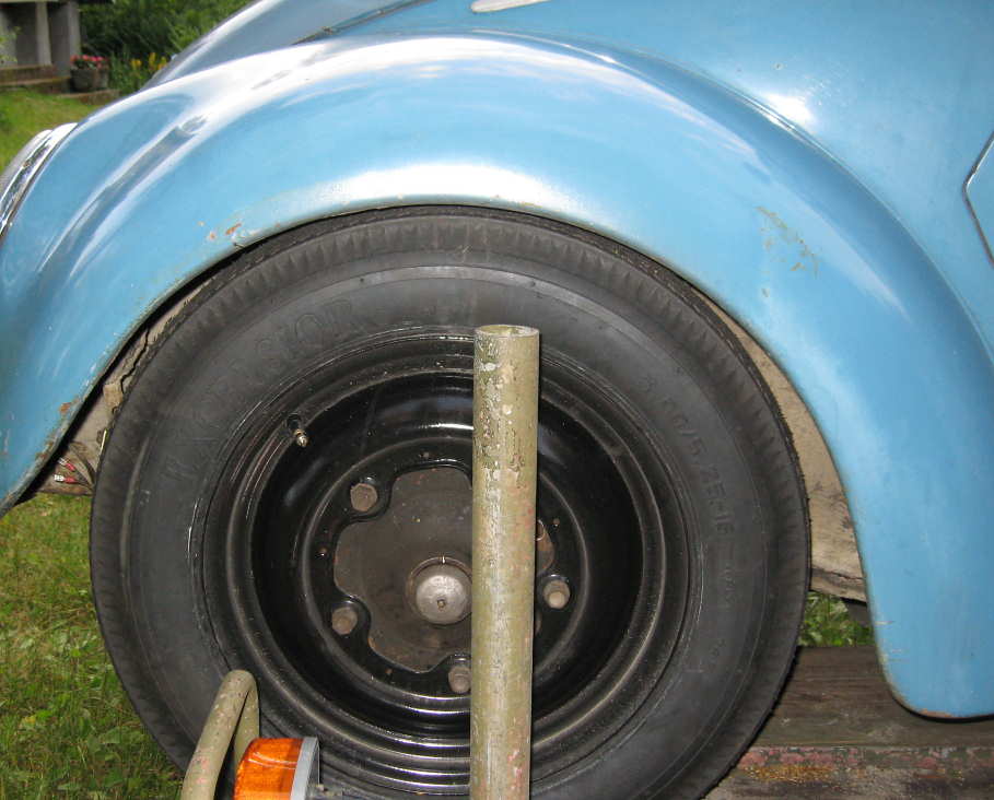

I am dealing with this issue as well . After putting drop spindles and disc brakes
I noticed my passenger wheel was sticking out passed the fender about an inch to half an inch further than the driver side . I believe it's aftermarket , not sure where from.
Now im looking for an OG 63 fender .

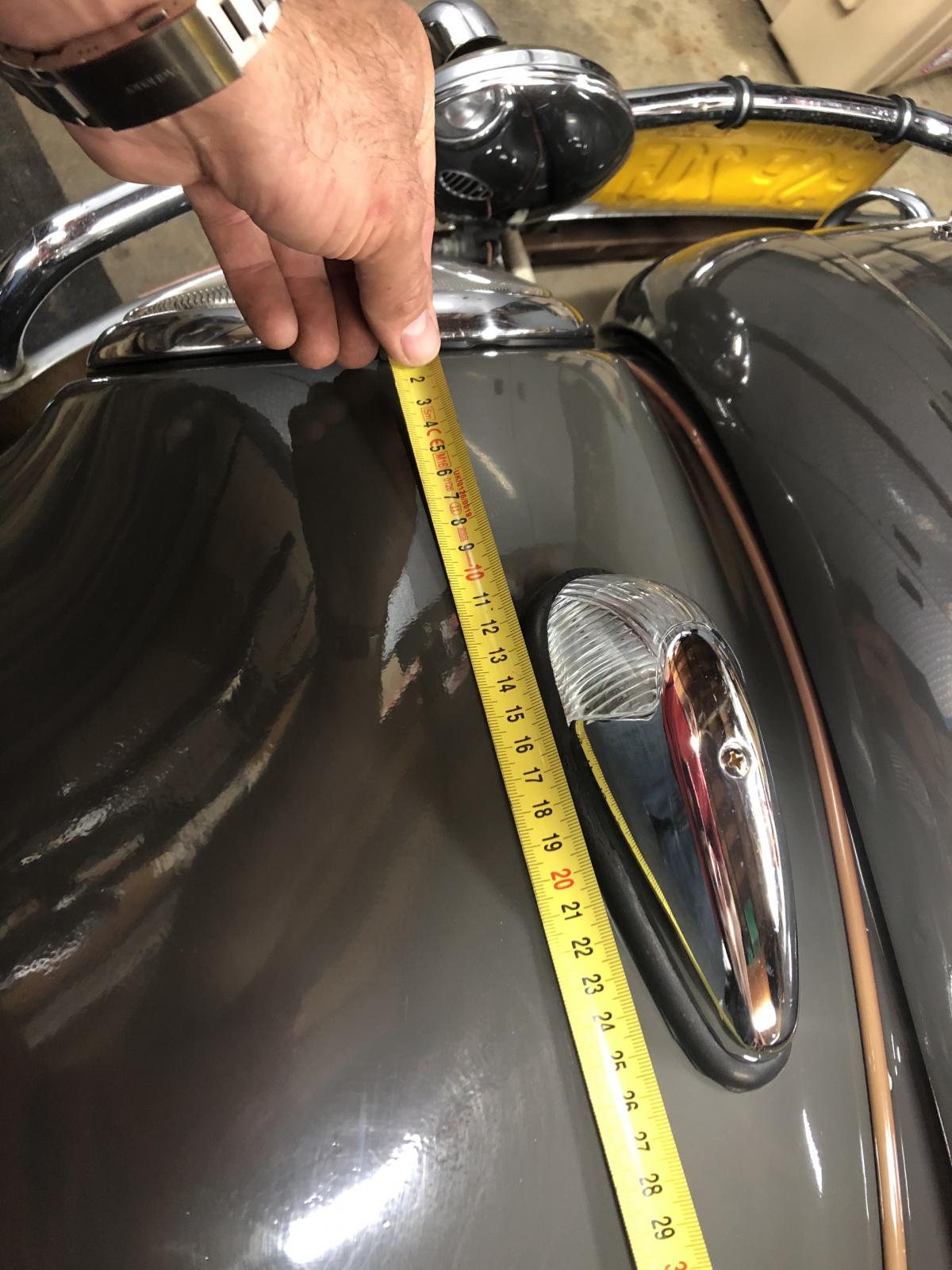

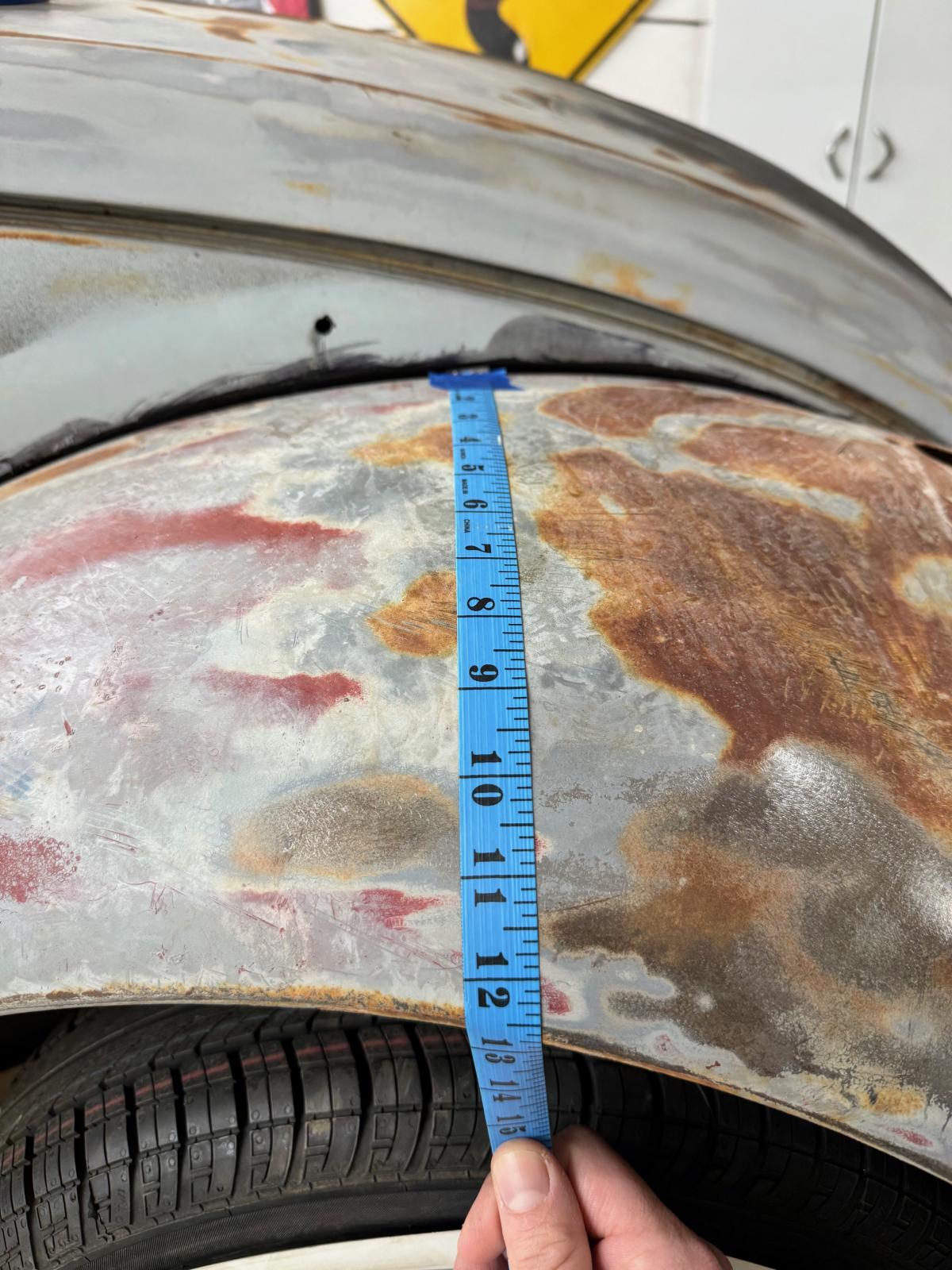

@pastellgreen Makes me feel more confident now that my drivers side is probably OG.
@Busstom Yeah, hard to tell a difference by the pics, but that 3/4" of extra space between the fender and tire and is quite noticeable. Especially when lowering the car.

Alltogehter I posessed three bugs from 1961 and one from 1963, all with their original sets of fender. The measurement had been always 33,5 cm on both sides on them.
Additionally I still keep a left NOS fender in grey primer with VW label. Same measurement. I also have a right fender that is an early aftermarket one in grey primer, its measurement shows 33,0 cm.
I believe, the wheel arch could have been increased with the introduction of the new front axle in 1965, because of the also increased suspension travel.

PostPosted: Sun Mar 10, 2024 9:09 am    Post subject: Re: Official 50s-60s Front Fender Thread Reply with quote

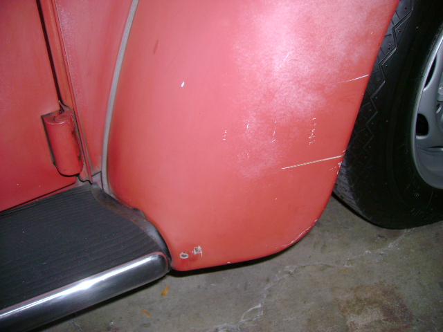

I suspect you have variation due to a fender change through the years. I don't know which one (if either) is original, but that kind of disparity is common with so many different dies used over the years. You may have to go on a sort of scavenger hunt attempting to match those two fenders.
All that said, factoring in parallax (your pics are angling down at the point being measured), it looks like <3/4 inch, which is easily attributed to an aftermarket fender. I just measured 3 fenders, for certain, one is an original 1965 VW fender, they all measure between 12 and 12.5 inches, but it's all subjective because we're dealing with arcs and imprecise datums, and just 1° of difference in the angle of the tape changes the measurement.

Can anyone with an early 60s tell me the exact width of what the fender is supposed to be? (second bolt above the turn signal hole). My passenger side is nearly an inch off and tends to flare out compared to the drivers side that flares down more. I'm pretty sure the driver's side is from a '59. Thanks!

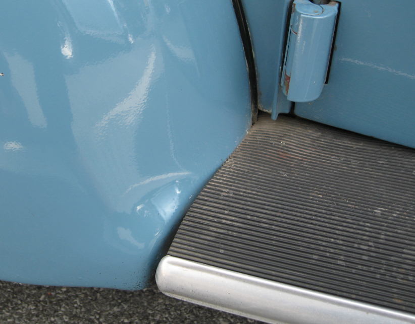

Does anyone know exactly when the ‘59-60 front fenders lost the running board bulge? I have a late May ‘59 bug (Birth certificate says shipped June 10th ‘59. The metal wire tubes are there. I can’t tell if it’s ribbed due to thick undercoating at this time. The bulge seems either quite subtle or not really there compared to pics I’ve seen of others. Thanks in advance

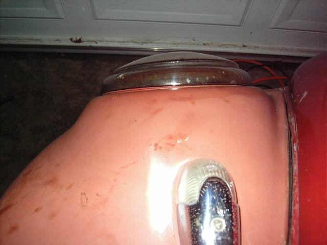

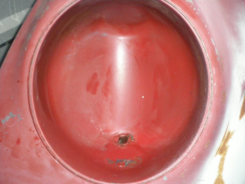

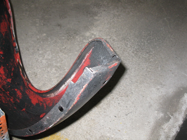

possibly an earlier euro fender with turn signal installed later. Check the hole and see if its factory stamped or hole saw. If it has the 2 bolt mount with no large drip boot that is a dead give away.
I think you’re right. The turn signal hole was hole sawed because it’s not clean. It also shows some remnants of a non-VW signal or marker light in that area as well.

PostPosted: Mon Nov 16, 2020 9:50 pm    Post subject: Re: Official 50s-60s Front Fender Thread Reply with quote

Can anyone help me with this fender ID? I was looking for a ‘61-63 fender and I bought this one thinking it was similar other than the wire tubing but it’s def got the early bottom bulge & bigger headlight bulge. The bucket has what looks like dimples and only one drain hole? OG paint though

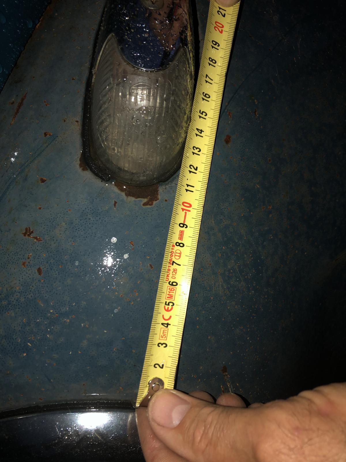

Ill post this on the early fender thread also, but here is the measurement of my sons 1960 bug. I cut these holes based on measurements i thought i had from an aftermarket fender that was significantly farther forward than the one i had. Someone commented on my sons build thread that the turn signal holes were different. I moved the driver side forward to match the passenger.
This is the 1960 Indigo that we just got. Clearly looks like factory fenders, even though i suspect the turn signals were added because of the semaphores. The measurements match my sons almost exactly. 13cm from the headlight bucket edge to the center of the turn signal rivet i can see through the lense.
This fender is an OG fender that my buddy gave me. I think it came off of a 1959, not sure though. He bought it in a set. It clearly measures 11cm for the same dimension.
My measurements are far from super accurate, I’m not building a watch, but.....does anyone have a hard measurement from the headlight bucket to the first turn signal hole? I’m soaking the INdigo turn signal nuts in kroil along with the fender bolts. I intend to remove this weekend, that will let me know if these were added or factory. I suspect that the new fender will need to have it’s turn signal relocated.
