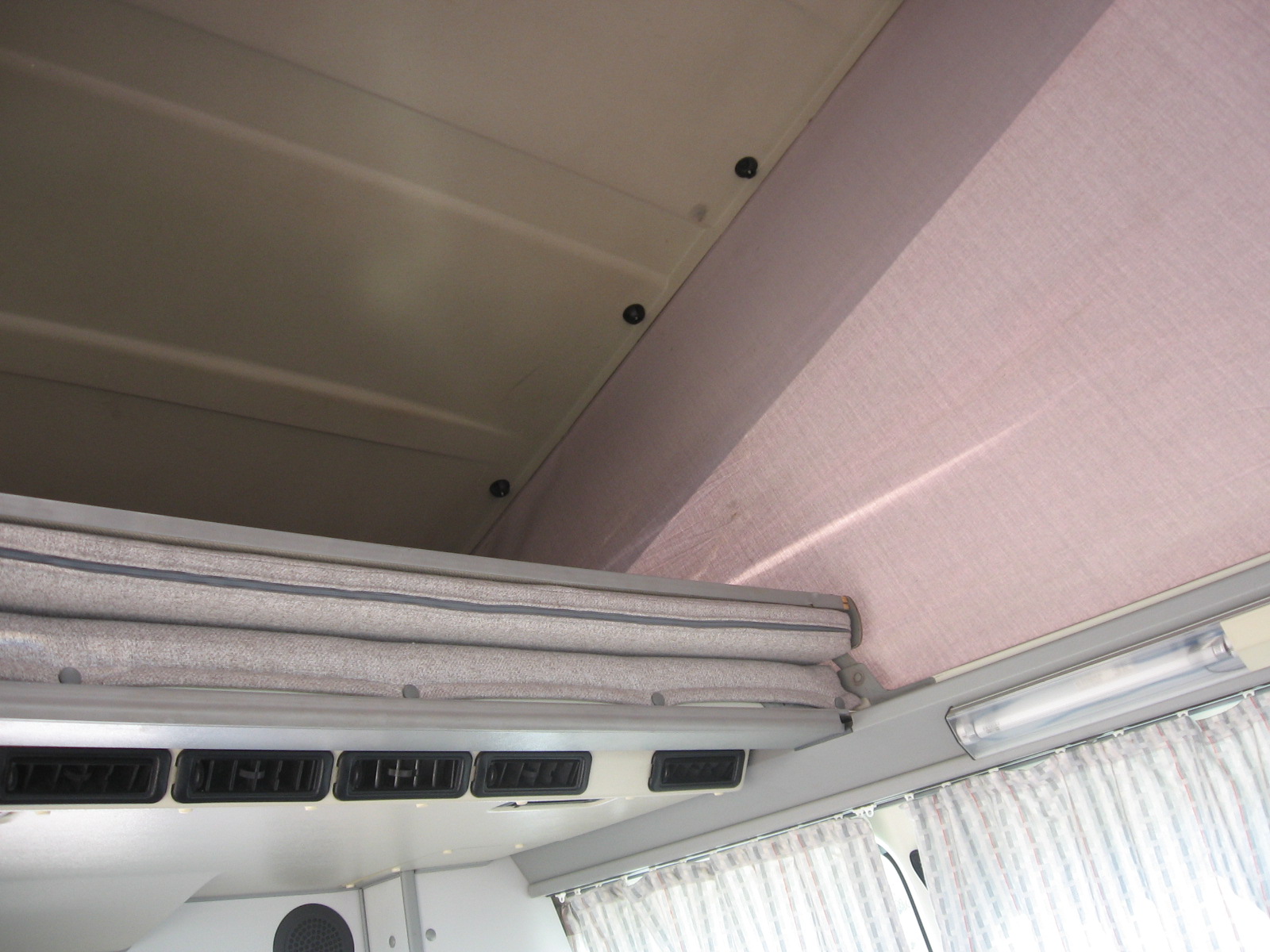

Right, so the PO installed Yakima Racks and installed fake ARGs. Really it's just some angle iron and it looks bad, but worked.
So then I install the pop top shocks and have remove the rear set of them. Also the box I have will only span 36", so I'd have to move at least one pair any way...
I'm tempted to complete replace them with Yakima ARGs. Put one back behind the strut (possibly using the rearmost existing hole) and then move the middle one to be centered 36" foreword of that (after the bump). That way I have an option of adding a third up front later on.
Which leaves the holes. Crying or Very sad
I saw a recommendation for Solarez Ding Repair. Is that enough? Or do I need something stronger.
Pictures:
Anyone see problems with the plan?
