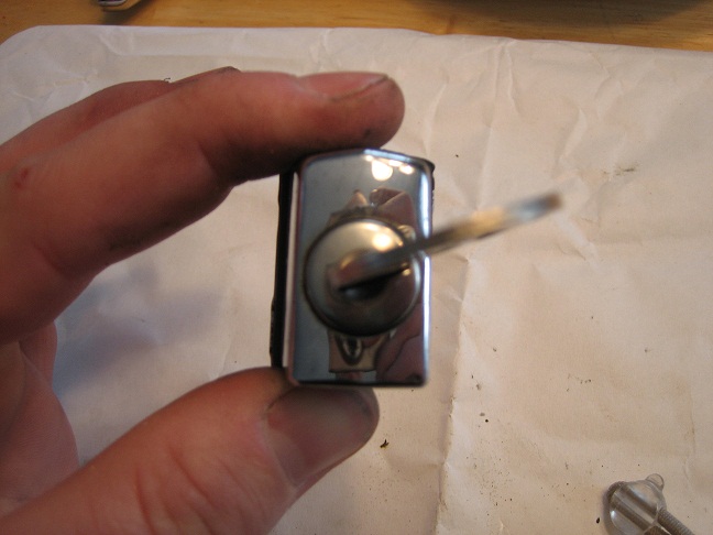

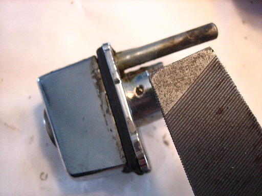

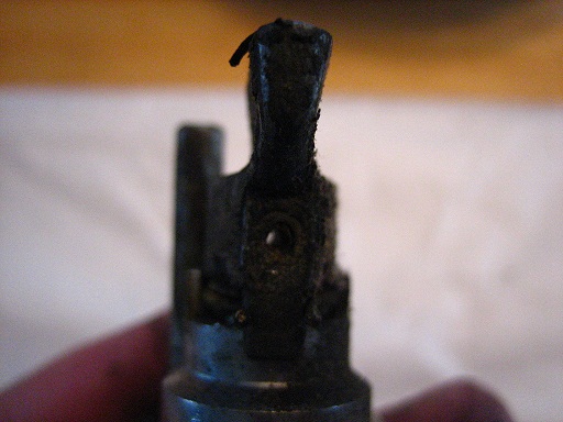

When I got my 1964 beetle only had one key (ignition) and driver’s door lock no key…watched step by step tutorial and filed the standing above the cylinder surface the tumblers of the door tumbler after disassembly with the key in…no problem and now works perfectly with the ignition key…thanks for the information and what a time saver and no expense at all.

Huge thanks to @Keith Ovalteen for this great tutorial with excellent pictures and some helpful comments from others too. You all help'd me get my buggy's engine lid lock working with the same key as for ignition.
Had to use the key barrel from a big old Beatle engine latch, because the nice smaller and more fitting (for my light weight fiberglass engine lid) latch was from a VW bus, which uses a totally different key (VB type) from my ignition (K type).

Great tutorial on how locks work Keith and everyone else. Just did this to a '63 Notch that came with no keys and/or ignition. Pics showed me what I was looking for and verbiage was very informative. I ended up buying an OG lock with two keys on here and using the key to swap out the wafers in the OG lock with the locks on the car. Now I have three OG door locks that open with the same key. Thanks very much for taking the time to post this and all the detailed pics.

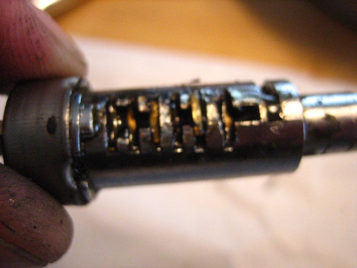

The idea is that all the wafers are the same size and the difference is where in its height the slot for the key is located. The top and the bottom of the wafer are leveled with the lock cylinder when the correct key cut is under the wafer. If one end of a wafer sticks up the other end is recessed in the lock cylinder.

I'm wondering what the difference is between a filed-off wafer and a wafer of the correct height. Aren't they both now the same height to fit the profile of a particular key? The key doesn't know whether the wafer was filed or not. As for other keys working in the lock, that would happen regardless. I must be missing something Very Happy .

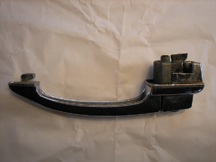

Keith, the rubber seal (?) in question is inside the handle, in a groove, around the lock body.

Sounds like you're describing the door handle seal.

I took my drivers side outside door handle off and then removed the lock to see what was holding the push button partially in. There is a rectangular rubber piece that goes around the lock, in a groove, that was brittle and broken. Is this piece necessary and is it available? I am assuming it is there to keep out dirt and water.

Just wanted to say thanks for the great post! I could never get my passenger side to work with my drivers door/ignition key. Using the tutorial I was able to swap the pins/wafers around for a perfect fit!
