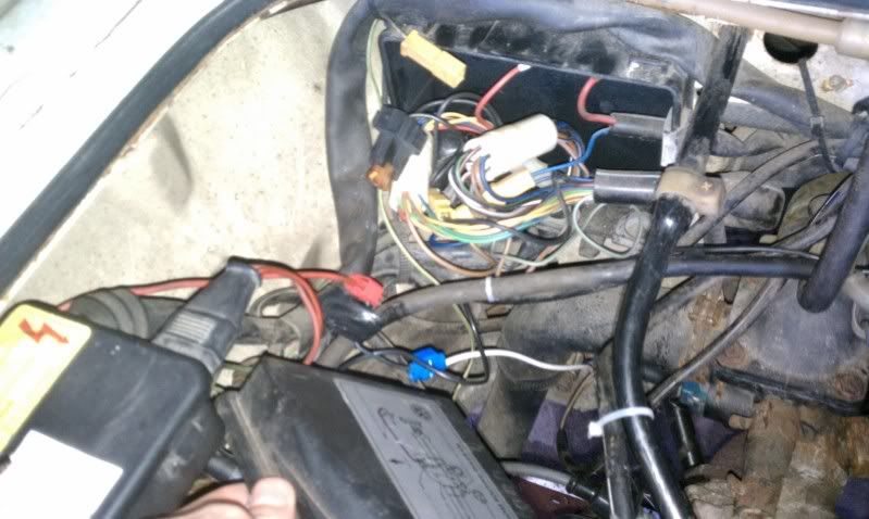

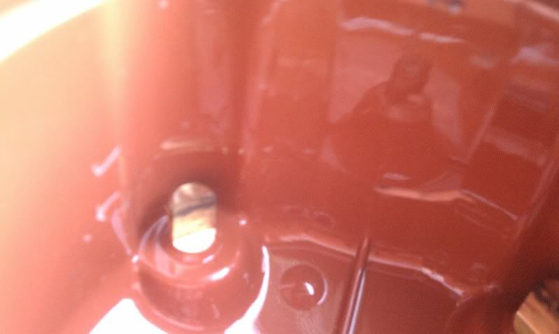

PostPosted: Sat Jul 16, 2011 2:26 pm    Post subject: Reply with quote
here is the other view of the top left against the firewall
and here is the inside of the OLD cap, and the burn marks? check it out.
1990 Vanagon Transporter 2.1L [the fridge] - Daily Driver for College Commuting
