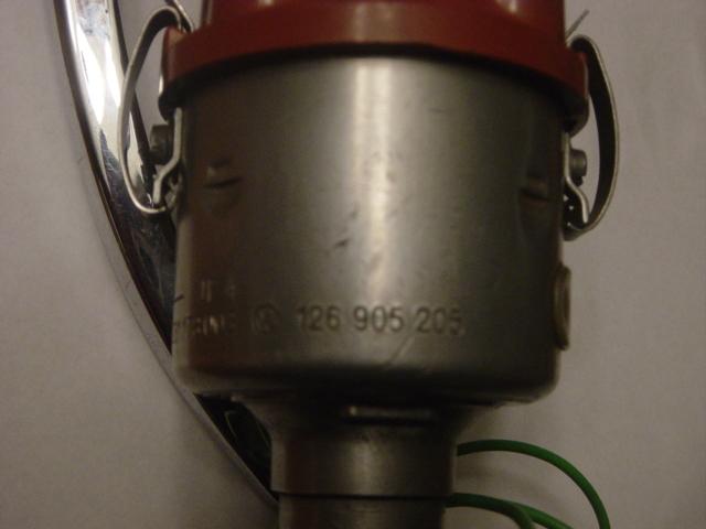

After several discussions it has been pointed out that these distributors are fairly rare as most industrial engines were supplied with magnetos rather than distributors.

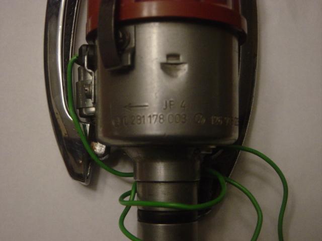

...and here we have the critter to which I was referring too:
Note that it has a VW logo and a VW part #. I've seen more than my share of 009's but this one is a first.
According to several sources and Bosch microfiche, this distributor is the predecessor to the 009. I have run it on my Sun Distributor Tester and it has a curve very close to that of the 009. It is designated as an industrial engine distributor specifically for VW engines. That is not something that the 009 can claim. There is also a 0 231 178 001 out there somewhere that had VW applications.

I found one reference to early 009"s. It's the oldvokshome website. It is one of the better distributor interchange references but it is not perfect. It lists the following:
0 231 178 001
0 231 178 003
0 231 178 009
all three cross referencing back to a 0 231 178 009.

Somewhere hiding in the forums is some information on early 009's that had a different part number than the more common German 009's= 0 231 178 009. I have done 8 differnet search ques and can't find any info. Can anyone with a better memory help out? I am interested from a historical perspective. Somewhere there is even a cast iron X XXX XXX 009. Thanks.
