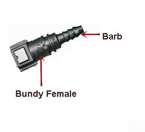

Sodo wrote:
Donnie strickland wrote:
This is what I used, except it was brass; it came with the pump:
I cut off the tip, so that the ring was left at the very tip of the barb. Been on there two years this November, with no problems.
FYI.... this Bundy connector ($6.99)
......clips onto that brass fitting that you cut. Just FYI.
Fuel Line Quick Connector Ford 5/16" Barb to 5/16" Bundy Female
by Dynapex
Link: http://a.co/d/bTmGS2Y
Sodo, Did the pump inlet fitting click into this Bundy connector like they were meant to? Is it still working without leaks?
Thanks, Ventura Richard

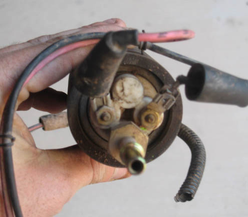

The brass inlet fitting that screws into the pump will not work with any female quick connect 5/16" hose fitting that I can find. I contacted the seller but they are no help.
